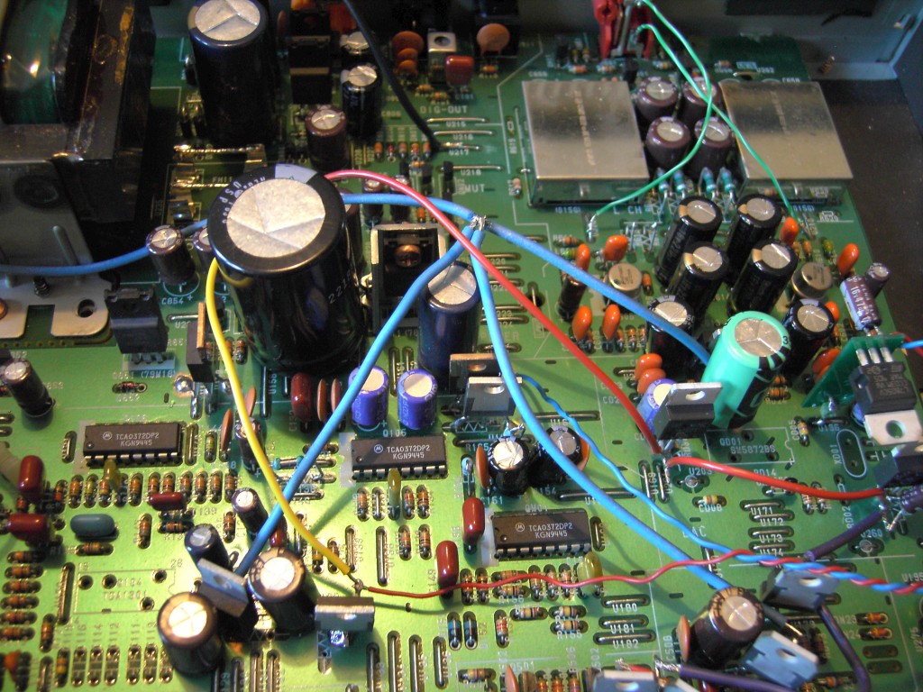

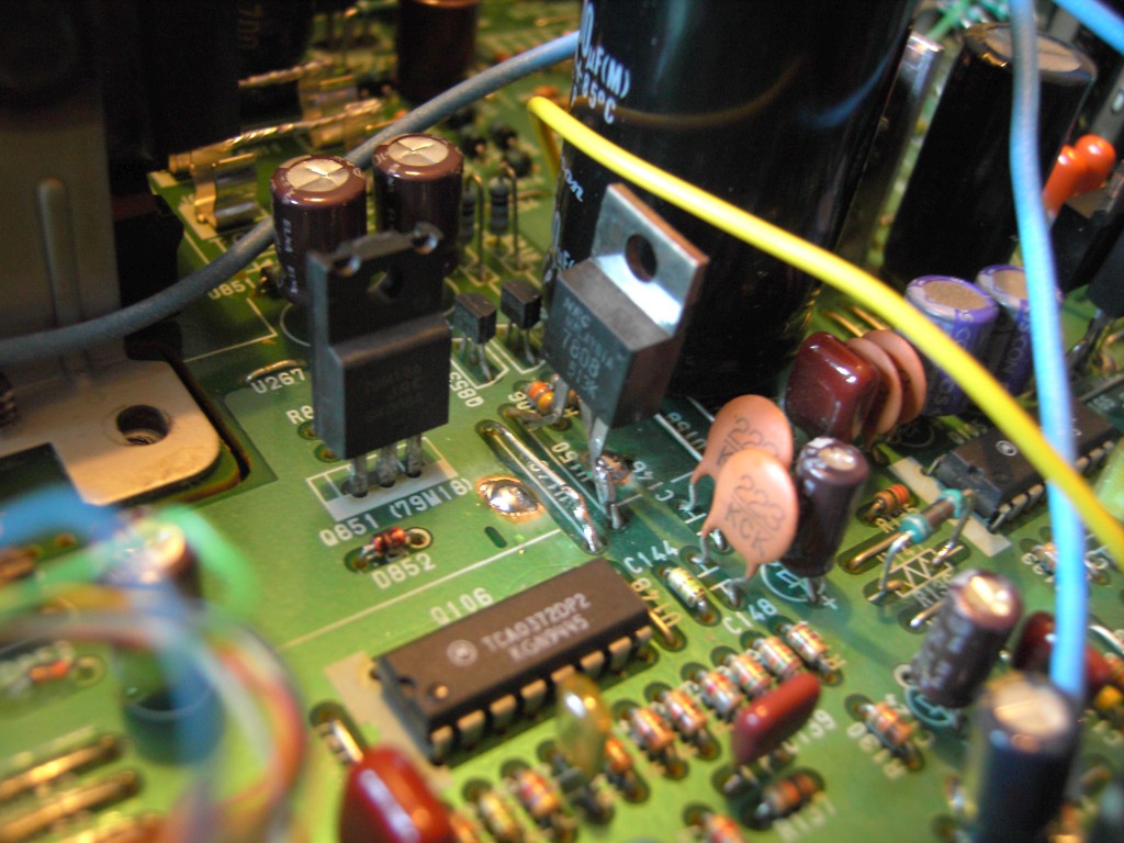

Focus/radial driver op-amp
Here's Q106, which the service manual tells me does "radial" and "focus". That sounds important to me 🙂
This player didn't like -8V here (reg inserted in-line with U149) so I restored it, as you can see in the picture. I left the 7808 in place - perhaps it's useful to see how it's done. The negative regulator has a different pin-out so don't just wire that up the same - make a drawing of it and refer to it as you solder it up, and check it after you solder it. Otherwise it'll probably go bang on power-up 😱
It's 100% happy with just 3 of the 6 voltage rails on the drivers regulated. I will do wire jumpers from the other 7808/7908 and regulate QM01 too.
Here's where you can easily feed Q105 (sled/laser diode driver). My pics don't show it clearly but it's the same as with Q106, except you're cutting out resistors rather than a wire link.
ps - that blue wire feeds the analogue regs on the servo, decoder and DAC. The others currently run off the big 10V rail.

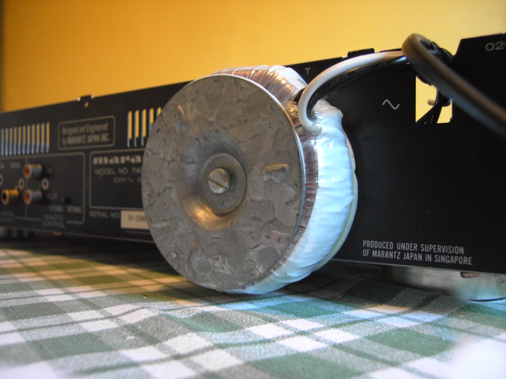

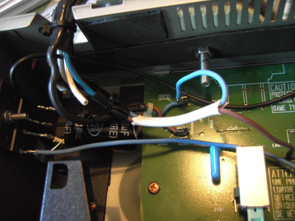

These pics show the easiest way to add another transformer and power supply (or supplies) to the player. If you position it just right a fairly large toroid can be bolted to the back without affecting the lid fitting properly or causing other clearance issues.
I hope this helps some of you.
