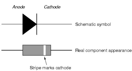

btw. my schottky diodes have arrived, and was wondering which way round they should be mounted? At one end they have a silver band around them, whereas teh old diodes in the player have a band at one end then a dot after. I guess i have to match the band ends ?

Well i have replaced most of the caps in my CD63 with rubycon ZL's, and im happy. Is there anywhere that i should not use them, as i have mine in the PSU, op-amps, DAC, decoder, and servo areas 😀 ?
ad
Hi ad,
I used Rubycon ZL/ZLH throughout my player, and i'm quite happy with them. The only exception are C611...614 around the opamps, for which I used BG's 😀
As for the diodes: match the bands.
Ray.
