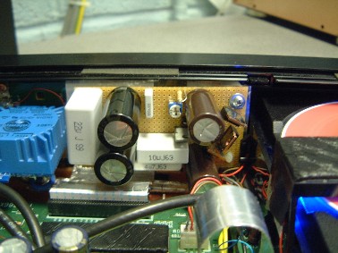

Here is a pic of my pre reg that supplies an Audiocom reg for clock 12V

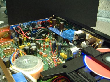

I fitted the audicom superlock 2, and my custom PSU (very kindly made by andy), and after assembling, IT STILL WORKS.
I also added a common-mode filter, as suggested by ray, and replaced a few caps near the HF/LPF and near the caps C813/814/815, with the elna cerafines that i replaced in the op-amp area.
I have to say that the increase in SQ was easily noticable. The bass is greatly improved, and the music just sounds soo much deeper. This increase in the amount of separation between the sounds is just huge.
Have just put some crystal method (electronica) on now, and it just amazes me how good this player sounds, even after only stage 1 of my mods.
A big thank you goes out to ray, simon, and andy for all the help so far.
@ andy. That's chin up for the guy who killed his 6000OSE and recieved someones F£$cked up modified 63. That soldering does look masterful though ;)
Now, time to figure out how the hell to mount my +/- 12V, and 5V super-regs :confused:
edit. some pics:

Shouldn't your footnote now say 'modded CD63 MkII..?
The CD6000 is now 'going' but is giving error 10 !
Lol, sort of. 'Ad Stage 1 Modified' at the moment.
Stage 2: Fitting of IEC socket, Bitumen dampening all over, Soundcare superspikes, copper shielding of main 4 chips.
Stage 3: OPA627's in BD's, new caps around op-amps (silver micas etc).
That'l be me done then !
But stage 1.5 in the next week will be fitting new Schottky diodes in PSU area, and fitting of 3x audiocom regs. Il need some help with those, as i don't want to put the shottky's in the wrong way around and blow my player
:D
