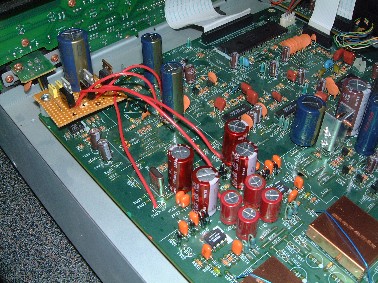

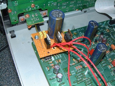

Here is a pic of a very simple reg pcb for dac and decoder on a friends 63SE. Better seperation of channels and more distant instruments could be heard.

Yep agree.
Although in the 63SE above I replaced standard 50ppm crystal with a custom made 5ppm accuracy and 5ppm cal crystal. I changed the layout under pcb to shorten paths and used silver mica and X7R decoupling cap. It was sooo much better than original crystal.
I would say if for arguments sake the audiocom clocks performance is 100% this 5ppm crystal was 80% with the original crystal being 0%.
Dr.Gone said:
Thank you all for the replies, I've just spend a few minutes studying my marantz and the pictures by rowemeister.
Am I correct in assuming the regulator board in the pictures above actually has 3 regulators onboard? And the phrase 'Change the psu to separate supplies.' can also mean installing separate regulators?
Jacco
Correct !
