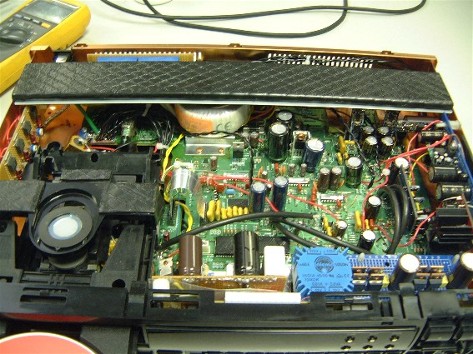

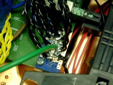

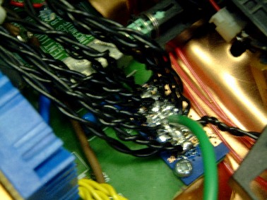

Part two of my grounding is complete.
I have 13 gnds going to the star point.
This second stage has really opened up the sound with much better treble, symbols are very clear and the Bass is even deeper now.
Double bass on jazz is more apparent.
The two pics show the gnd point.
This was taken before the wires were tidied up :smash:

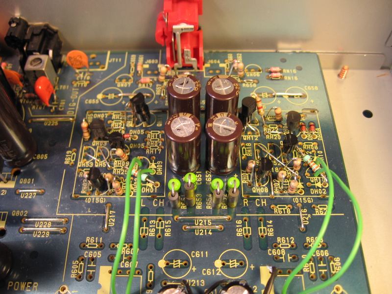

I never thought I would be re-wiring the HDAM PSU again....
It is the discrete SACD Enhancer circuit as found on Ultranalog.com.
I used the HDAM layout to host the circuit 😎. First I cleared off all the parts, except the current sink at the input. Then puzzled a bit to get all the parts right. This uses the same passive filter as I used for the tubestage. It's a much easier mod since it doesn't need +150V and heater voltage 😀.
The sound is very good, but I have to do more listening and tweaking for a final judgement. I'm going to compare it with the tubestage in the next few weeks, see which will be the winner: solid state or tubes :judge:.
Ray.
