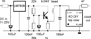

seen tangent's site, some very helpful info.
I've thinking about doing this
allan

rowemeister said:
also not sure what value to use on R1 yet.
Ray if you have some good advice its welcome.
I specialise in lots of areas of electronics but im not major in dc ripple and its filtering.
What I have come up with is my own idea but am unsure of exact values without spending ages with scope.
cheers 😉
Hi Brent,
Well, I read all this wisdom in the datasheet, nothing fancy...
The proposed value for R1 is 120R. The 1.25V reference voltage is across this resistor, so there will be a little over 10mA idle current drawn, which is the minimum load current for the regulator to maintain regulation. So that takes care of that. It won't hurt to use 100R.
If you calculate the bypass cap according to C = 1/(2*pi*f*R) you will get 13uF at a ripple frequency of 100Hz and 120R. So your cap is a bit on the low side.
Ray.

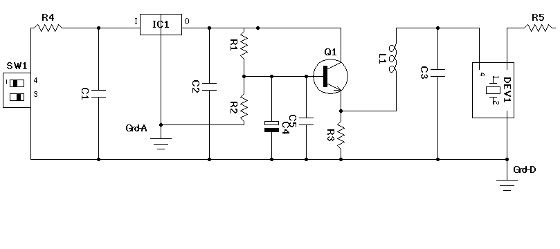

poynton said:
This is interesting - I wonder how much difference it makes?
With this circuit, the regulation is performed by the 78XX, the transistor is , I think, called a capacitor multiplier.
Andy
i've seen ripple been very low on a lm317 with good earthing just in the the overall circuit
ALW in his tests with the lm317 recommends separate earth for the base.
If use the same earths as digital it doesn't give a decent earth,
too much noise.
so the regulation ref point fluctuates.
I was going to use tent's psu just for starters, until i made a super reg.
comments in his posts and test made me think about the 7808,
and how much it may improve?
could be a simple upgrade on a standard cdp.
should transfer to the 317
any thoughts
allan

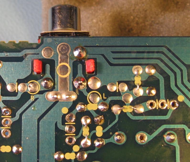

6h5c said:
Hi Brent,
Ray.
Cheers Ray. Ill mess about with the values a little.
Re: Clocks and clock psu
Dr.Gone said:
you mean there allready is a star ground on the CD-63/67?
I don't get it?!?
Jacco
Hi Jacco,
There is a star-ground at the RCA socket. This is a point where all the ground traces from the board meet. The top ground-plane is grounded at this same star-point, but it is also connected through several links to local (analog and digital) groundpoints at the DAC, decoder and analog +/-12V supply caps (U221, U235, U169, U208, U267, U136). So it seems things are not strictly separated. By removing the links (except the one at the star-point) the ground-plane becomes separated.
You should leave U136 in place if you want to keep using the headphone circuit by the way. It has no trace to ground on the bottom layer, so it is the only ground path for it.
Ray.
Re: Re: Clocks and clock psu
6h5c said:
Hi Allan,
What do you mean by "uses neutral as earth, via transformer"?
Is the neutral of the primairy side connected to the board ground in your player??
Ray.
Ray
i have question
we need active and neutral or positive and earth
for any circiut to operate
standard config, where's earth
allan
Hi Allan,
In my house, the neutral of the 230V outlet is connected to earth near the main fuse in the fusebox. But the player is floating with respect to earth normally, since the secondairy circuit is by no means connected to the primairy, or grounded.
So neutral = earth over here, but the flat 230V euro-plugs are unidirectional, so there's no telling which wire will be connected to what once you plug it in.
What plugs do you use over there, is it like the british plugs? That way you would always be sure which wire is hot and which is neutral, if the socket is wired correctly that is....
That's why I wondered: is the neutral of the primairy side somehow connected to the board ground in your player?
Ray.
