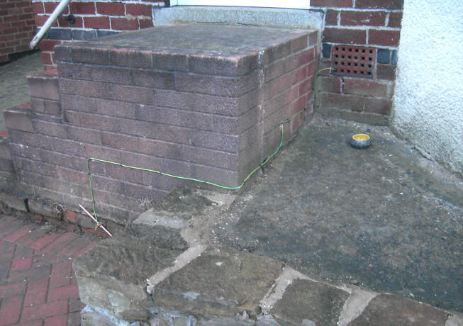

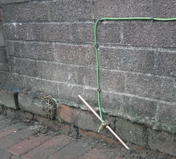

SimontY said:Talking of earthing, I added a spike to my system, nice upgrade.
Hi Simon,
Did you drive that spike all the way into the ground water level??
Otherwise you will only enjoy good music when it rains 😀
But rain is a good moment to stay indoors anyway....
Ray.
6h5c said:
Hi Simon,
Ray.
LOL
He either lives right next to the sea and waits for high tide or is waiting for global warming to really kick in. LOL
