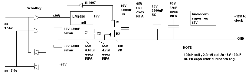

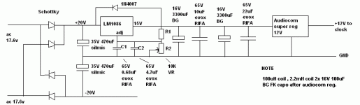

Also an update on my reg pcb tweeked a bit more.
Hope it filters ok
Brent

rowemeister said:Also an update on my reg pcb tweeked a bit more.![]()
Hope it filters ok
Brent

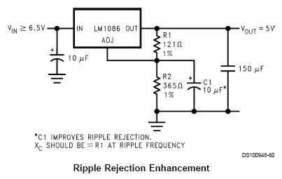

Hi Brent,
Did ya calculate the bypass cap's value to match R1?
Ray.

Not yet.....lol
been to busy at work!
also not sure what value to use on r1 yet.
Ray if you have some good advice its welcome.
I specialise in lots of areas of electronics but im not major in dc ripple and its filtering.
What I have come up with is my own idea but am unsure of exact values without spending ages with scope.
