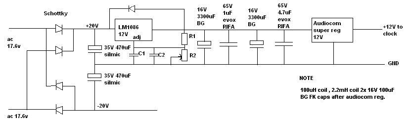

6h5c said:
Hi Brent,
Why don't you use the adjustable version?
I don't like the idea of lifting the regs reference with a noisy zener. This will be transferred to the output.
It will also enable you to decouple the adjust-pin and get better rejection ratio.
Why do you use two 3300uF BG's and two MKT's? Is there a lot of wire between them?
Ray.
I have adj version here as I used them for servo , hf and rf regs😀
I have those caps here so thought I would use them, maybe a little overkill.
So Ray the zener will be too noisy even with those caps and audiocom reg?
I could use that reg plus a few schottkys in series, I only need 3 or so volts extra.
rowemeister said:I have adj version here as I used them for servo , hf and rf regs😀
Hi Brent,
Well, one thing's for sure: a zener is more noisy than no zener. I would avoid it if I had a choice, the less noise the better. Especially since it is in series with the reg's ground-pin. The output gets lifted by whatever that zener produces....
And there's the adjust-pin that can be decoupled.
Ray.
6h5c said:
Hi Brent,
Ray.
Yeah your right Ray. The whole point of doing this is to eliminate noise .lol

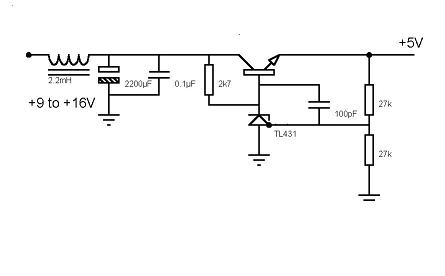

Why not use something like this instead of 'conventional' regulators??
Andy
Andy
Its a posibility and I do have scr's here. Thing is I already have the Audiocom reg and BG FK caps running the clock now, all I was doing was adding extra reg and caps before it, something very simple.
Although its a very good idea 😉

TL531 is a low noise adjustable shunt regulator.
This circuit is use by Elso Kwak for his clock.
Andy
Andy
Ahhhh should work a treat then
Hi not sure on the PM78 mate. When you do get a sch diagram let us know and we can have a look for you.
Will do, hows your Russian😀
Andy
TL531? The schematic refers to a TL431. Did I miss something?
Jacco

Here is an update on the reg, now using an adjustable LM1086 with protection diode and ripple filter caps.
Its the TL431 that I use in my Kwak Clock.
This circuit seems to work well. However, surely a monolithic voltage regulator typically has an internal opamp of sorts using feedback to ensure the voltage is constant? I've always assumed the latter would be better than this circuit (even though I use it - just following Elso's schematic).
