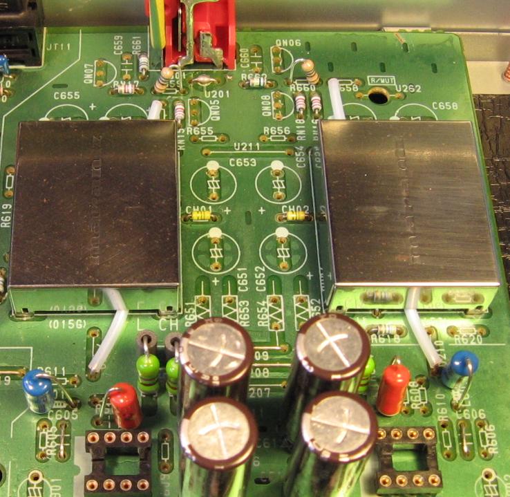

adfinni said:thanks guys
Those BG caps are much better value there than over at audiocom. £2.41 aint bad, but 4 would be a tenner, and id rather try the cheaper starget (elna) caps @ £1 a piece. I'm a scrounging student don't you know![]()
I'm in contact with ray whose is advising me to use 100n XR7, and 100n PPS ceramic caps in parallel with some of the modified caps listed in the original pdf.
Ta
Hi ad!
Just a word of caution: don't use the Stargets around the digital circuits, I don't trust they are low-ESR. Use the (ultra-) low-impedance types instead.
Ray.
6h5c said:
Hi ad!
Ray.
Just looking at the stargets. They are oxygen free and designed for high performance and minimum distortion. There is no spec for ESR/impedance. The ripple @ 100Hz appears lower than most.
Brent
Now im confused.
So is it ok to use the elnas at C611-614, and C651-654 ?
Il just go with what the mods .pdf says, much easier

rowemeister said:Just looking at the stargets. They are oxygen free and designed for high performance and minimum distortion. There is no spec for ESR/impedance. The ripple @ 100Hz appears lower than most.
Brent
Hi Brent,
The OFC thing is nice, but it's one of those "HDAM marketing" things 😀.
You don't really expect a few mm of OFC wire to make a difference when there's common copper tracks all over the PCB? And "minimum distortion" ? An electrolytic is a nasty thing anyway. Especially if you put signal through it
This Starget series (ROD) doesn't seem to appear on Elna's website. Did you manage to get the datasheet for these Stargets? Could you post it / send me a copy?
adfinni said:Now im confused.
Hi Adam,
Don't worry, your player will sound good if you put the Stargets in, they are much better compared to the standard ones that are in there. You can use them for C611...614. For C651...654 you don't need replacements, it is better to bypass the HDAM circuit. Cheap mod eh? But around the digital circuits I would recommend a cap with a known low ESR.
Ray.
Cheers
Im looking at getting some rubycon caps to use instead of the stargets, as i have been reading good things about them, plus they are cheaper than the stargets.
I'm trying to compile my list of caps to order tonight, but its effort trying to remember all the ones to order. Il get there eventually, but might even change to the FC's to use around the mains supply and tranny. Soo many choices, soo little time.
Il get pics up when im done.
With regard to C651-654, would they be useless when i bypass the HDAM, so there would be no need to spend money on upgrading them?
ad
ad
adfinni said:Cheers
ad
Hi Ad,
Yes, you're right, those parts lists can get pretty long...
That's the main reason I made my mods lists, to keep track of things 😀
Rubycons are very nice, especially the ZA/ZL(H) series. They have very low impedance. Where are you going to order your stuff, RS?
Indeed, C651...654 are no longer used when HDAM is bypassed. No need spending $$$ on them 😉
Ray.

i see you've gone passive?
allan
ps the chokes with beads do work very well
awpagan said:i see you've gone passive?
allan
Nah, it's just the opamps missing...😀
Next week, when my parts arrive, i'm going to put a more decent tubestage in. Will post pics asap 😎.
Ray.
Ray.
Can't wait Ray 😉
Brent
