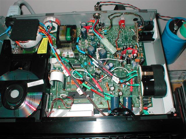

Hi Ricardo,
what is the temperature behaviour of the Q106 right now ? Does it still get hot after replacement ?
Greetings,
Pawel
Greetings,
Pawel
Hi Pawelpzogal said:Hi Ricardo,
Greetings,
No heat.
Everything works perfectly. It is now playing for 2 hours without problems.
I am starting to believe the wire mesh can sometimes cause some kind of short circuit.
Regards
Ricardo
Ricardo-> mine Q106 becomes hot too, I just noticed it yesterday. If I touch it with the finger it feels normal, then becomes hotter and hotter until it's too hot 🙂 How does it look like in your CDP ?
As I said, no improvement in regards to tracking 🙁
I relate the tracking problems with IC Q106 itself.
Is it gets hot (too hot to touch), check the voltages on R149 R150.
If these go below +-10v, than the IC is bad.
Changing mine for a ON Semi did wonders...😉
I removed the stock IC, soldered a socket in place and put the new IC on the socket. If it gets hot again, it will be easier to replace... lol
I believe the reason it gets hot is because I have connection problems in the wire mesh connecting to the HF Amp psu.
Ricardo

Hi Brent & Ricardo,
I had no time for scope 🙁 but I checked the pickup again, connected a lap psu, then did some forth and back travels with the pickup, added a drop of machine oil 🙂
Wobble didn't stop, but I noticed similar behaviour on my dvd player (wobble but not skipping). Then I replaced some caps in the psu, schottky diodes went in & decoupled servo & decoder caps with WIMAs. Finally put everything together and worked ! OK, I didn't check the worst CD I used for testing since my wife was fed up with the same song playing again 🙂. Anyway we just listened to some good music...
no skipping so far. I will definitely go on with the mods. Q106 becomes a bit hot. I'll replace the drivers for sure , no big cost. I am thinking of pimping the HF amp in some way. Maybe metal film precision resistors ? Anyone tried this ? The input current through R101 is very low, maybe few uAmps, so it could be prone to distortions. I also measured the voltages on the HF path and on E of Q501 i got 0.9 instead of 1.1V does it mean anything ?

Thank you Pawelpzogal said:Then I replaced some caps in the psu, schottky diodes went in & decoupled servo & decoder caps with WIMAs. Finally put everything together and worked ! OK, I didn't check the worst CD I used for testing since my wife was fed up with the same song playing again 🙂. Anyway we just listened to some good music...
Upgrading caps used to decouple and smooth the +5v lines in the servo and drivers gave me a lot of detail and stopped some skipping problems.
Using dedicated PSU and sregs on the servo made a really big difference in terms of detail and bass power.
If Q106 gets hot, please verify the ribbon connecting main pcb with the one under the mech.
Keep on modding.... I did not realyse the benefits until I started building dedicated psu´s for the servo and analog output stage.
