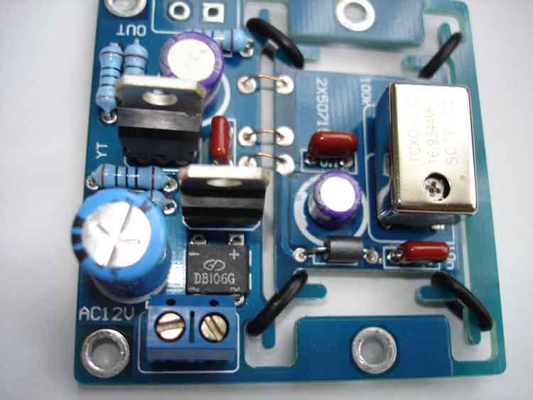

Hello
I recently purchased and assembled a clock kit for my fairly well modded 67, i know should've done it earlier but the problem is this, on the board the input is marked as 12v a.c. I'm no expert but this seems odd. This was bought from China so can get no help through email. Otherwise ok - oscons, 317t's etc . Not even sure what design it is, but looks a bit like a flea?
Any help from this brilliant thread and its members would be most appreciated.

Well I can see a surface-mount bridge rectifier, so the AC input is not odd.
I wonder why there is a trim-pot-like adjuster under the screening can.
The suspension/isolation is very cool!
Overall it looks very simple and is probably not quite up with an Audiocon Superclock or Sercal C1, was it cheap though??

Ah, on which case where would be the best place to tap of for now? as i understand it will feed pin 28 and grnd.
Thanks for that Simon was going to run of a dc transformer eek.

12Vac is correct. You need a 12V transformer.
Simon the trimmer is to adjust the freq spot on, it should already be set so do not adjust it.

A Maplins job for now.. just to test? or something more 'bespoke from the start... as long as its regulated?

The rectification, smoothing and regulation are all onboard by the looks of things. You just need a small transformer, or to find ~12vac from the CD63 transformer.
