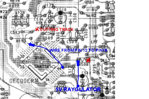

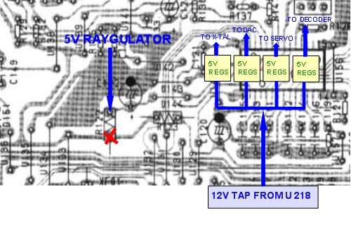

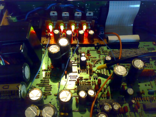

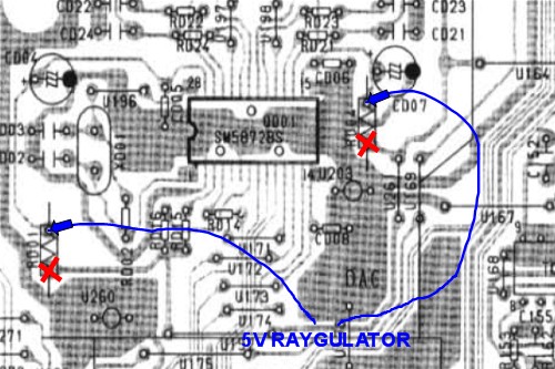

Hi guys,
Yesterday I fitted 4 pcs 5V raygulator for digital section (RD01,RD04,R508,R122) and look seem work properly.
I tap 12V from U218 as raw supply to 4 pcs raygulator, so LM7812 as pre regs.
The sound??....I am not yet listening a lot but I have noted that sound more cleaner.
Regards
aquar
aquar said:Yesterday I fitted 4 pcs 5V raygulator for digital section (RD01,RD04,R508,R122) and look seem work properly. I tap 12V from U218 as raw supply to 4 pcs raygulator, so LM7812 as pre regs. Regards aquar
