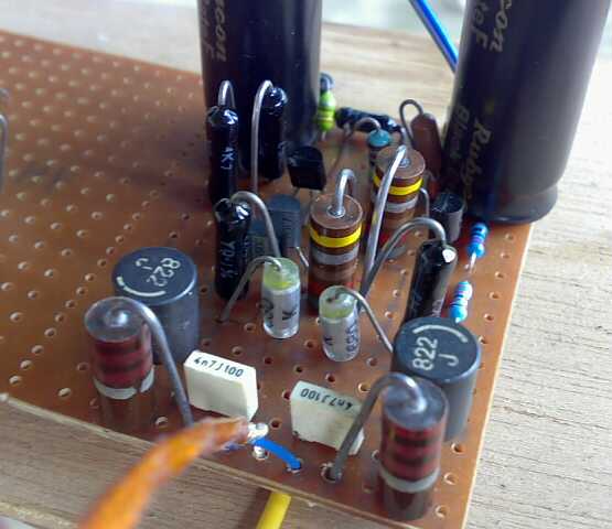

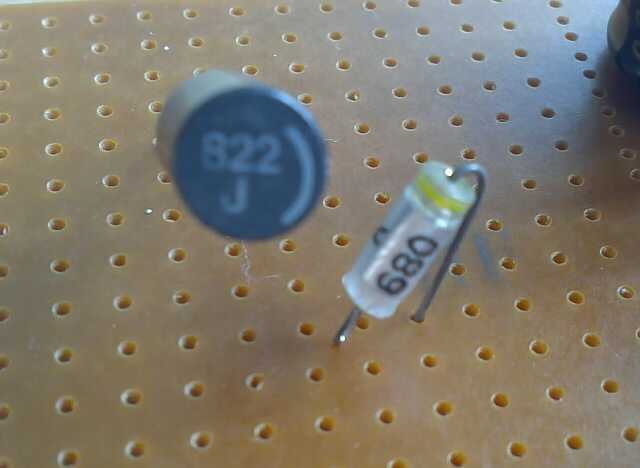

Hi Guys,
I just finished made a part of discrete output stage, transistor version with mix of resistor (holco h2/h4,alan bradley,vishay dale and cheap 1% metal resistor) by point to point wiring system.
The problem is:
1. Inductor for pasif filter is 8.2 mH, not 10 mH
2. Caps for pasif filter use 680pF paper caps, not silver mica or others.
3. Axial inductor for input voltage is 220 uH with resistant 12R !!
Advise please ?
Regards
Aquar

Good work!
1. Tried in my simulation of the circuit 8.2mH instead of 10mH - difference is tiny, don't worry about it.
2. Don't know!
3. Not a problem IMO.
Glenn

Looks really cool! Your caps look like polyester and polystyrene to me. Does it really matter though as long as they're not ceramics??
Have you listenend to it yet?
Simon

Hi Simon,hi Glenn
Very well thanks for your advise.
Yes, I think this caps is polystyrene.
I don't yet listen this filter and don't be patient but......Now I have 12V sulzer's reg and curious with the result in op amp supply (replace 12V raygulator), also curious with independent PSU for op amp supply (I want to know effect of snubber ,bypass cap etc ), so I hope as soon as to get it and fit this filter soon.
