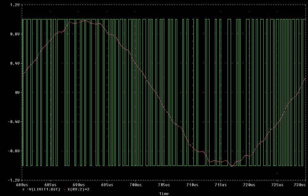

Glenn2 said:Just wondered if making the DAC analogue stage work harder was detrimental at all.
Hi Glenn,
It's not an analogue stage! The output signals are square waves.
Look at the block diagram, there's a PWM modulator buffered by two drivers. The output stage is probably something like a totem-pole: on or off, with saturated transistors. So I don't think the output voltage will drop much by the increased load at the output. Well, unless you make it too low of course . It's the timing of the pulses that's important, that makes the audio-signal, not the actual amplitude.
In the datasheet the output voltage is spec'd AVdd-0.3V at 1mA output current and that would be about 5k impedance.

Glenn2 said:
Also, can anyone tell me what we are filtering out here. Obviously we want to pass up to 20kHz, but where does the rubbish start? Is it all above 300kHz?
Without going into sampling theory, the filter roll-off is at just above 20KHz deliberately. This is approximately half the sample rate of 44KHz. The noise starts here, mainly in the form of alias signals which go all the way up to many KHz (in theory to infinity)
Similar filters are used in the recording process.
Andy
For more info, Google 'Nyquist Theory'.

6h5c said:
Hi Glenn,
Ray
Thanks Ray. The output stage of the DAC seems to be sensitive to regulation and decoupling changes so it would not have shocked me if it was sensitive to loading too.
If it works as you describe, it makes sense that they design it to have differential outputs for noise rejection.
By the way, do you fine-tune your circuit to maximise common-mode rejection? Or just match everything to such a degree that it is not necessary?
Glenn

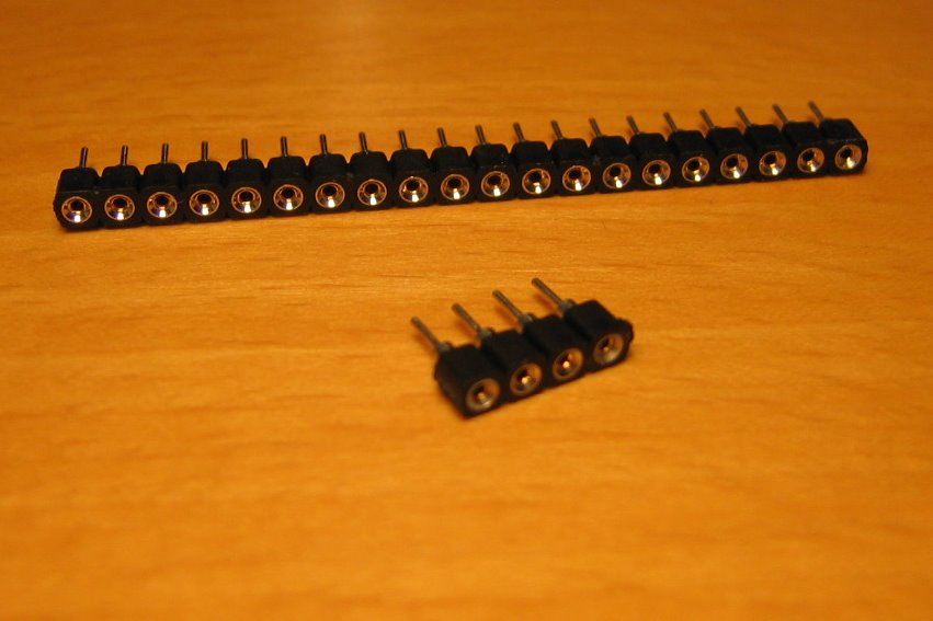

Re: opamp
Pana FC if I remember.
No, it don't fit. Much better to find SIL version. Then you can break off any number you want.
http://fr.farnell.com/jsp/Supports+...IN/D01-9952042/displayProduct.jsp?sku=1023031
That's the way I do it.
Malefoda said:AVR, what is your caps setup around there?
Again, what is the real size forthe socket? Farnell shows thousand!
http://fr.farnell.com/jsp/Supports+...ARWIN/D2608-42/displayProduct.jsp?sku=1023046
Is this one ok?

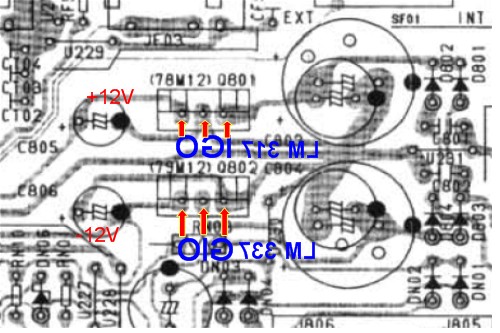

raygulator
Hi guys, i am trying to build Raygulator as i am a beginer- my question is for the 12V+ using the LM317-do i need to bend the pin at all?as i see the pins are not matched as 78M12? or am i missing something. I have looked at the pictures from Ray web site but still unsure esp even when the LM317 reverse in position . Thanks Quan.
http://www.diyaudio.com/forums/showthread.php?postid=1206171#post1206171

jksmurf said:
Is the Upper one for LM317/LM337 regs and kower 79M12? Is that the reason for the difference for pinout of +12V/-12V regs?
k.

Hi k,
I hope this pic will help you.
BTW for pic: view from top site pcb, and will be opposite if you look from soldering area.
Regards
aquar
aquar said:
Hi k,
Regards
aquar
Thanks aquar, I'll pass it to my wife and see if she gets all that
k.
