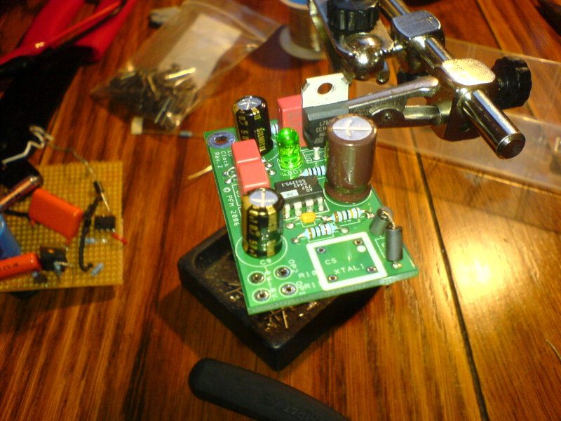

Could someone explain how they've hooked up the regs that go next to the opamps.
From pictures I've seen, my guess is the power is taken from C803 to go into a bent reg input pin. R611-14 have been removed. The reg output is connected to 1) R613 & 2) R614 (opamp side).
The reg ground pin is bent and runs back to the now empty spots where Q801 & Q802 used to live.
Is that correct? Do you remove any more parts apart from C805/6?
I notice one picture only has 2 cap between the opamps. Is there a reason for this?

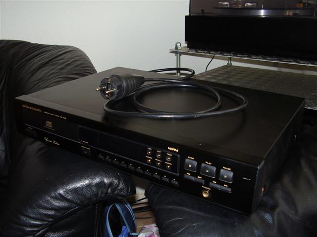

I've recently acquired a nice CD67SE ... naturally I found this thread ... and now I want to modify it aswell ...
I've already started on the powerchord. But that does nothing for the sound.
I find the bass to be too loud, with what mods (aprt from the clock) can I achieve better bass management en more detailed mid/high ?
And in what order ?
Would bypassing the HDAM (without better opamps) be a good idea ?
I've read that bypassing the HDAM drops a couple of veils when done, does this include the bass ?
(It might be somehwere in this thread, but freaking h*ll its 555 pages long )

TDLofCC said:I've recently acquired a nice CD67SE ... naturally I found this thread ... and now I want to modify it aswell ...
If the power cord does nothing for the sound a) you didn't upgrade it enough, or b) there is something elsewhere muddying the picture. But that's ok, most mods are more obvious than changing the power lead so you should be able to discern at least some of them.
First of all bypassing the HDAM does indeed drop veils, and it does reduce the apparent bass. It should tighten up.
Even more importantly you must perform two simple mechanical mods 1 - line the lid with bitumen and 2 - remove the stock feet and replace with hard cones. I like oak cones, others will work too. Use three. Don't use soft feet, these will exacerbate the bass problem.
Next you will want to change the op-amps to LM4562, 2 x OPA627, or OPA2134/OPA2132. Or one of the excellent combinations tried by others here. You will want to change the + and - 12v regulators to low noise types.
You will need to reclock the DAC using a good clock, such as the Audiocom Superclock. I haven't heard them but others can recommend many other off-the-shelf upgrades or kits. The clock needs to have it's own good quality regulated power supply. It should ideally be fed from a low noise voltage regulater. These cannot be bought from normal shops. Do a search, there are a few to choose from, such as Audiocom's Super Regulator, Tent Labs' shunt reg, or our own Brent's S Power.
Unless you reclock it, I don't think it will ever sound realistic to be honest. And it won't work to it's fullest potential unless you spend a bit of cash here.
I think those are the main mods that concern the bass of the player, but of course separating the 5v feeds of the many chips so that each is fed by it's own regulator, will reap large rewards. If each of these is in turn fed by a power supply and large transformer the sound will become more solid and the bass will be superb. It will be good if it's good on the CD, really showing amazing variety from disc to disc.
Hope this helps.
Simon

Alright ... I did the bypass ... was kinda scary ... my soldering was a little rusty ... but when I was busy it went better and better
Still a little scared I put it to the torch
Quickly close it up to test. Bass is alot better, alot less booming.
Love it already, and this is with the standard opamps. It can only get better now.
One question though, why would Marantz add this, when it apparantly makes the player ... sound worse than without ?

TDLofCC said:Love it already, and this is with the standard opamps. It can only get better now.
Congratulations on your first successful mod! I'd glad you like it.
Why Marantz would do it... In my opinion it's because it sounds big n ballsy, there's lots of bass. And that helps to cover up the "jittery" vague sound. That's only my guess/opinion! I could well be wrong.
Simon
