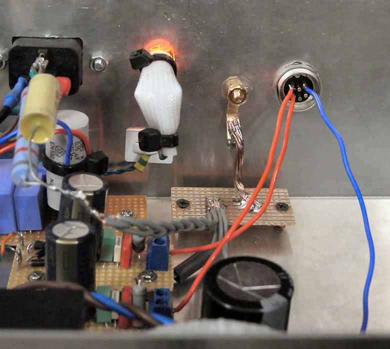

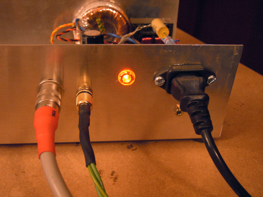

Probably a bit pointless to show but here's the single ground connection between CDP and PSU. A salvaged speaker binding post and a thick lead I got via Ebay, with silver plated bananas.
10mm^2 wire from star earth to post, excessive maybe :devilr:
I had to isolate the post from the chassis with plastic salvaged from packaging, so as to not mess up my carefully considered grounding scheme!
