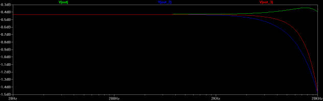

LPF SPICE plots
Just downloaded SwitchercadIII (aka LTspice) from Linear Technology's website.
Modelled the 67's LPF so thought I'd put the plot in so people can see the response curve of different filter combinations.
Green: stock filter
Red: 100pf changed to 150pf as Thorsten suggests
Blue: 1000pf changed to 470pF (Bessel)
Unless I've made a balls-up (not unlikely as I was a Spice virgin) the Bessel is still only 0.5dB down at 14kHz.
Does this look right?

Ray, in the 63 with the notch filter, if lowering the cap from 1n to, say 470p, the inductor has to be raised from 220u to round 470u to keep the notch tuned to 8*fs?
Correct?
Correct?
Cheers Ray.
I get an overall voltage gain of -0.4dB within the passband which I assume is also correct.
avr300 said:Ray, in the 63 with the notch filter, if lowering the cap from 1n to, say 470p, the inductor has to be raised from 220u to round 470u to keep the notch tuned to 8*fs?
Correct?
I'll let Ray answer your question, but I think I read somewhere (maybe Pedja Rigic's site) that there is no energy at this frequency anyway... so maybe that's why they didn't bother on the 67 and 6000.
I'll stick it in my Spice model anyway and have a play (waiting for a pizza to arrive🙂 )
Correct?
Hi avr,

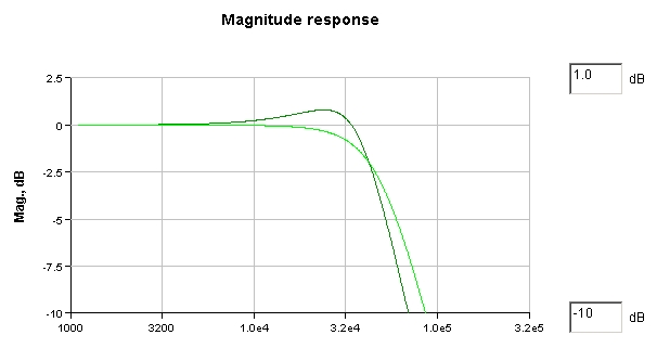

I use 430pF and 470uH to be exact, and adjusted the resistors to compensate for the lower value and keep group delay constant.
I posted a PDF here that shows 'before' and 'after' graphs.
Glenn2 said:Cheers Ray.
The level at 1kHz should be your reference level, at 1kHz set it to 0dB. Then look at 20kHz and you'll see about -1dB roll-off.
Ray
avr300 said:It's Lasagna here 😉
It still hasn't arrived....
Anyway, the original 1000pF+220uH is tuned to 340kHz.
Lowering to 470pF detunes it to 491kHz.
Changing to 470pF+470uH tunes it to 348kHz which is actually a little close to 8*Fs than it was before (352.8kHz).
So, 470uH is the value you want.
Scratch that - I mistyped L as 440uH...
They are both 340kHz....
