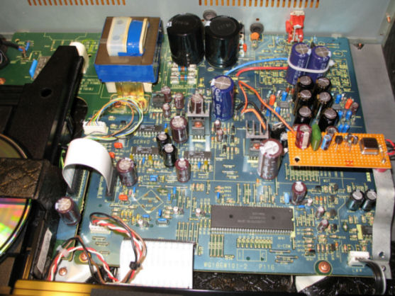

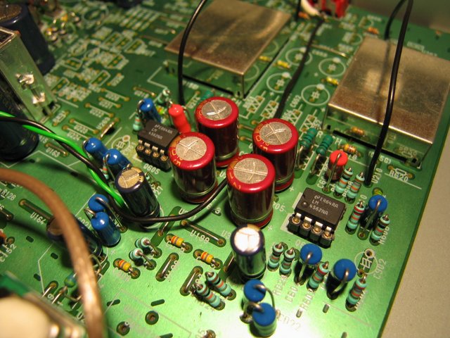

Hi Avr300,
I like the sound of them to and there not expensive, did you matched them?😀
Ray,
I have changed C805, C806 from 4700uF/25V no name to 470/16V BG and i finally have found the sound i'm looking for.
Please try this aswell and give me your opinion, i have now a grunding deep bass without the high mid wich was killing my soundstage.
I still cannot believe that a capacitor 10 times smaller can outperform its bigger brother like this, but my ears are telling me so!!
Peter

Peter Venema said:Ray,
Peter
Hi Peter,
It's not just the value in uF, but also the quality of the cap that matters 😀. You replaced a mediocre cap by a superb one. Even though that one is much smaller, it performs much better. If you compare a 100u/16V BG with a 100u/16V standard brand one, or even a ZLH or FC, you'll see that the BG is a lot bigger in size = lower ESR. And there are reports that big caps around the DAC and opamps, like 1000u, also don't sound good. Most of the times I use 220...470u in those places. I see you moved the regs near the opamps? Good to hear you found it 😎.
Ray.

Peter Venema said:Hi Avr300,
Peter
You're right, they cost next to nothing.
No, I just bought them and soldered them in. Mayby I'll do it later, but I wanted to hear the sound first. And they do sounds nice.
Ray
Yes, I moved the regs to Hdam👎 area and it gave a better controled bass because its nearer to the opamps.
I also placed a reg for analoge suppply for the DAC.
The smal print above the decoder is a tent crystal with elso kwak power supply, reclocking gave a BIIIIG differance in the overal sound and soundstage.
Did you try a dedicated 5V reg for the laserprint, because every additional HF hash will cause the trackingdevice more work to focus and the fault correction to correct these errors ergo more distortion, this is offcourse in theory.
I will try this, and let you know what it brougt for the sound.
Peter

Avr300
The 1000pF to 470pF mod gave a better balanced high to low and a more natural sound for me.😀 😀
Is this the case for you aswell?
Peter
Peter
I did the same, 1n to 470p.
It's still to early to judge, but indeed it's a very pleasant and present sound I have (now?).

Peter Venema said:I still cannot believe that a capacitor 10 times smaller can outperform its bigger brother like this, but my ears are telling me so!!
I can believe it! I reported just the same result from 4700u Pana Fc to 470u and 330u BG in key locations. I use 1000u BG next to op-amps, which works well too.
I just popped 220u Cerafine in my preamp (maybe nice to mix caps a bit?) post-regs. There's 20,000uF before the regs.

Yes they work well there , you actually have little more capacitance than using 4x 470uF caps by using 2X 1000uF.
470uF X 2 = 940uF per 12V rail
Where you have 1000uF X1 per 12v rail
Brent

martin clark said:Absolutet capacitance value is very poorly controlled for electrolytics; typical tolerance is -20, +50%.
In other words don't worry about the uF much...better to base your choice on desired ESR and ESL characteristics if you can define them.
When building a small reg pcb with dedicated TX I always use larger caps (16V 4700uF) the amount of bass and midrange depth is improved no end in that particular application.
The general rule I stick too (through experimenting) is use large caps after TX (4700uF) and not quite so large on the input of a reg(3300uF). After a reg ill use a something like 220uF of 470uF. And then a cap of around 220uf - 470uF like a BG or Silmic next to the item recieving the voltage.
