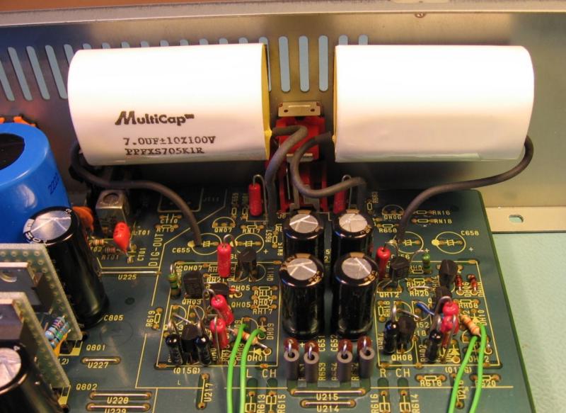

I was just looking at the schematic and it appears as if Q852 pulls the 3.6V secondary down to the required -19.5V for the VF display (VF1, VF2). Q853 turns Q852 on, but if I just tie the base of Q852 to +5V via R854, I should be fine just re-installing Q852, R852, R853, R854, and D853.
As far as the op-amp tied directly to the output, this is not the best idea! Yes, I did it, but it is only temporary. I plan to add short circuit protection, but I need to match the resistor with the max op-amp output current so not to damage the op-amp. The problem is that the OPA627, AD8620 and LM4562 all have different current ratings. According to the datasheets, I have calculated the following serial resistances:
OPA627: 266 Ohm
AD8620: 400 Ohm
LM4562: 521 Ohm
While so far I am able to drive the 50 Ohm load of my cable with the LM4562, I will probably overheat it and degrade performance in the long run. In true purist theory, I should buy 2 Caddock's of each of the above values and swap them in with their respective op-amp in order to do a true comparison between op-amps. But, yikes ... more $$$! Hence the temp solution to run direct.
First will be the clock upgrade and precision comps on the filter to get the most accurate signal to the op-amp that I can with my planned modifications. Then I can due a more accurate comparison.
Will keep y'all posted!

I noticed in your pics you removed the transistor Q853 and this is needed for the display
Also a clock improves detail and timing

Hi.
As far as I know, all the op-amps are short-circuit proof.
The spec. sheet for the AD8620 states that it can have an indefinate short !!
A resistor in series with the output is very bad !!
Andy

You must have a different datasheet than I do! Mine states 45mA output current and 65mA short circuit current! It may be able to meet that short circuit current for an infinite time period, but a 0 Ohm load at 12V is WAY more than the 65mA short circuit rating! In order for the op-amp to work at ideal conditions (i.e. "stated" datasheet parameters), it must work within it's as-designed output current. By increasing this current you can overheat the device which will shorten it's lifespan as well as drive it's noise figures through the roof. Take a look at the OEM configuration ... they use a 470 Ohm load on the LM2114, thus loading it at about 25mA ... which is well below the max 40mA output current it is capable of driving.

Hi Craig,
I think you used the 'output current capability' figure for calculating these resistances. But these values are way too high. As Andy says, nowadays almost every opamp is short-circuit proof. IF you short it, the mentioned current that runs can be endured indefinately. The output current is internally limited and thus is not 12V divided by the output resistance. The other reason for a resistor at the output could be the capacitive load of the following interlink. Some opamps don't like that.
By the way, how come your cable is a 50 ohm load??
Ray

Sorry ... in video world today ... 75 ohm ...
My main concern is the THD figures go up significantly when the amp is not operating under an ideal load. While it is true we need to measure the actual impedance with the amplifier connected, why not just stick a series resitor to be 100% sure we are properly loaded? Some say series resistance is bad, but when using a non-inductive resistor such as a Caddock, I don't see any negative effects. I actually use a Caddock/Black Beauty divider in my Axiom passive preamp with no ill-effects.
Yes, the amp can endure a direct short by it's internal resistance, but at what cost ... heat! At $20/pop, I'd rather spend $4 on a Caddock than reduce the life of the op-amps. Granted, how often will they ever short anyway (likely never). I guess I have been brainwashed by my company and always tend to err on the side of safety!

I have read in the LM4562 sheets that it had shortcircuit protection, can't you drive the cable without resistor then?
Did the switch to LM4562 myself and it gave me back the bass i was missing after the removal of the HDAM, the OPA2134 was in place before but this was sounding rather thin after i got rid of the HDAM.
The LM4562 is staying in that for shure!!
