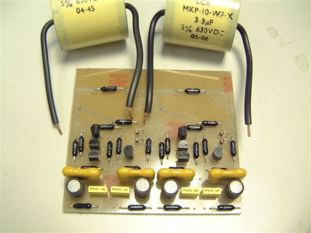

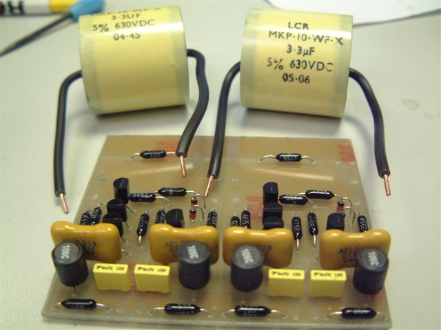

Yes the CD53 has the HDAM bypassed but you only get good gains when you upgrade the opamps and bypass the output caps.
Brent
I have used Rays cd enhancer circuit and Jaaps pcb layout 😉
Just need to install the pcb.

6h5c said:
Hey Brent,
Nice one! I'm curious what you think of the sound. Transistors also work well. I'm about to upgrade my output stage with Holco's and a nice big Auricap output cap. Should reveal even more!
Looks like your PCB is a good move Jaap!
Ray.
What gains do you expect me to get over the opa132 opa627 combo?
Also have you tried those LCR caps im going to use.
Brent
Brent
Hi Brent,
This weekend I spent some more time doing another comparison between opamps and a FET output stage. I like the soundstage of the FET stage better. It is very wide with lots of air, and has far more depth compared to the opamps. The music is less attached to the speakers. But I found the bass less tight. I use OPA124 + AD8610 at the moment.
I don't know how the LCR's sound, but if it is a decent MKP it should be ok. Is it film and foil or metallized?
Ray.
