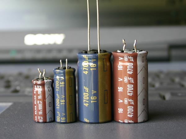

I have used my DC block Silmic while I'm waiting for my Rubycon ZL. Still breaking them in.
Hi AVR,
Marantz used 'general purpose' caps everywhere, except for the opamps and HDAM. Right now I am replacing caps with both low ESR (Elna RJH, BG, Panasonic FC) and new general purpose (Nichicon RZm).
Replacing with GP in some places doesn't harm audio as I auditioned both of them.
I don't know what the effects will be of replacing all caps with ultra low impedance like Rubycon ZL/ZLH as the ultra low impedance is a heavier load to the PSU. Has anybody experimented with this setup?
Regards, Jaap
