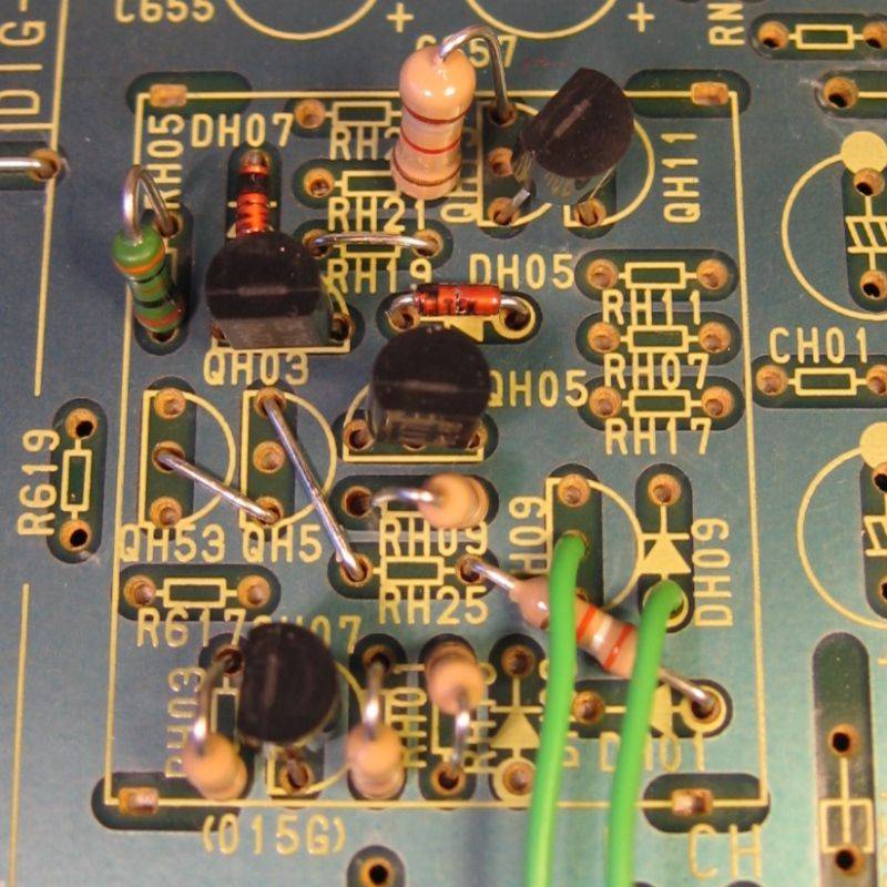

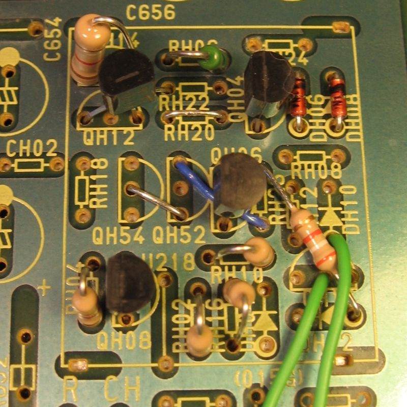

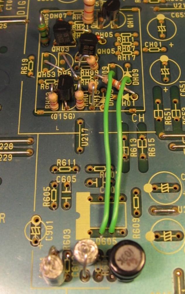

For those of you who are interested: i've updated the CD_Enhancer PDF with the FET schematic, and revised the placement list for the parts. It describes which parts (and how) to place in the empty HDAM section (note that you can leave the original current sink in place). It will take some time to figure it out, but with the schematic and the PCB side-by-side it should not be too difficult. If needed, I can provide detailed photo's 😀.

6h5c said:
Hi guys!
Working on a CD65 now....
Ray.
nice work, Ray.
A picture may help some people, though.
Andy
Thanks Ray
This will work with the CD63 right the pdf says CD_Enhancer 57_67 just want to make sure.
Also would love to get the zip - package.
Dave
Dave
Hi Dave,
Yes, it will work in a CD63 also. I think even the component numbers are identical.
For the zip-file, just send me an e-mail, so I can reply to you.
Ray.
Ray.
