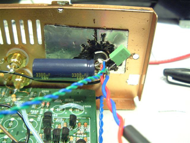

Hi Simon..
Is your 63 home again ?
Hello!
Nope, not yet. The servo chip didn't arrive on Friday so it can't be completely fixed until Monday at the earliest :bawling:
But the wait will be well worth it as Brent has kindly neatened the clock divider, moved the master clock to a better place, neatened and improved my DAC regs, added a feed to the decoder chip, made some component changes, improved the star grounding layout, and moved the 12v regs next to the op-amps.
And that is on top of making the thing work again, and of course fixing up the display (running at -12v), and resoldering some dodgy pads he found, including the likely culprit for making that left channel noise I complained about. Truly a nice guy!
I really can't wait to hear it, for it will be a stunning machine!

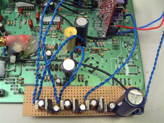

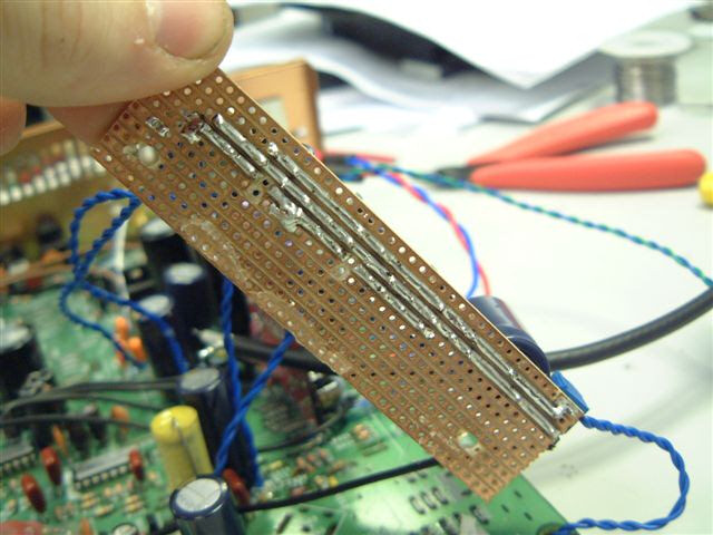

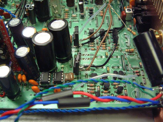

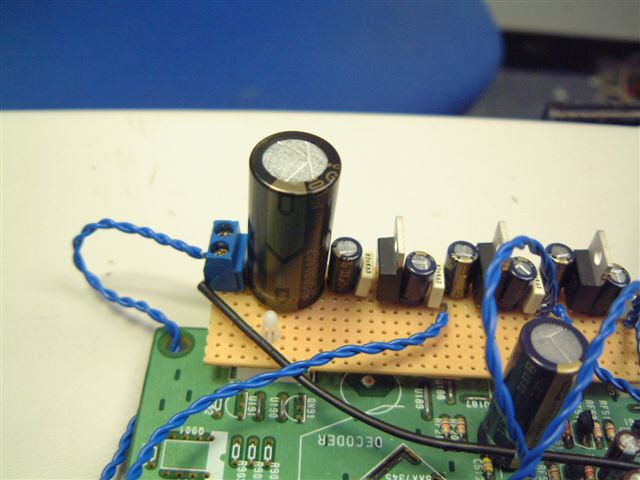

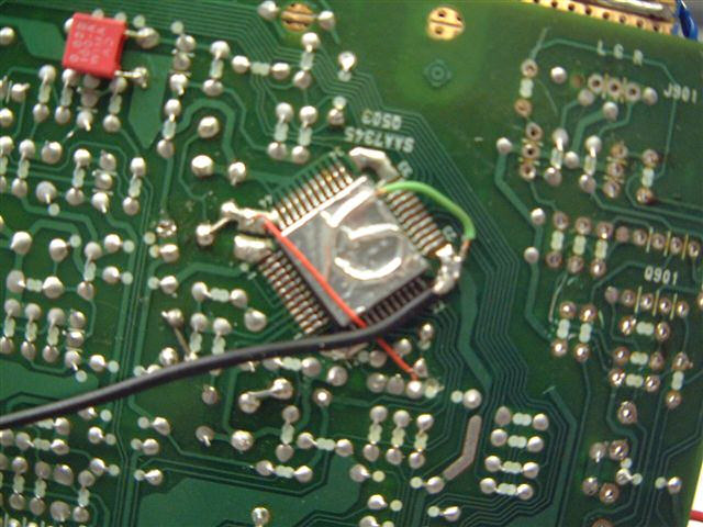

Hi Allan,
Brent did not begin work whilst I was there. He has worked inbetween real work, rather than doing it all at once. I have assimilated some tips about soldering and such. But really it's experience I need more of.
He sent a few pics of progress. Here he thought a BG I used elsewhere was better used on the reg board.
Perhaps a little boring this one, but it shows one star ground connection, the shielding of the decoder chip and also the psu feed change that Brent made. He mentioned this earlier in the thread - Marantz made a mistake and fed the 5v to the wrong side of the decoupling resistor. Now, of course, this chip gets 5v regs shared only with one other circuit each - DAC digital and decoder digital share one, and DAC analogue and decoder analogue share another.
Last one! Here's the reg pcb that feeds the DAC and decoder (large cap now changed). You can also see where some of the grounds go to, and where he moved the Audiocom DVC-1 clock board to.
Apologies to those that didn't want to see these pictures. I know there are quite a few of them, but maybe they'll be of interest to some of you, I don't know! :smash:
