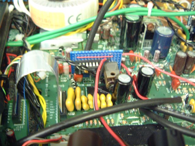

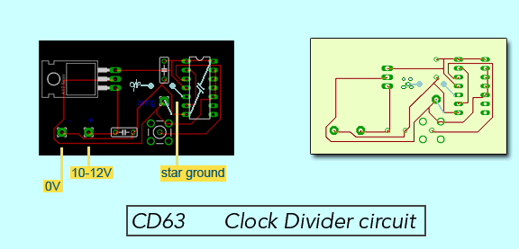

disco said:
Maybe this small board can be of help. It consists of a 7805 reg with two accompanying caps (.33 and .1uF), a SMB jack and the 74LS74.
The board can be fitted in the hole above C142 (on the left side).
As mentioned in an earlier post by Allen, the reg gets its ground from star ground. Maybe someone can scrutinize the connections, as there was a small dispute about wiring.
Regards, Jaap
Hi Jaap
Nice diagram. I can see a few errors! the reg gnd and star is not connected to gnd and no output shown.
I have edited it for you to see and added a X7R cap across pin 7 and 14.
Everything else appears spot on mate.
P.S The divider circuit is not required for the servo on a 67 as the servo and decoder are in one chip and its divided internally.
Brent
rowemeister said:Hi Jaap
Brent
Thanks for the coop Brent. 🙂
Will implement the X7R cap (22nF?) and ground connection.
For output I thought of a 47 ohm direct from pin 5 on the PCB through the hole of former X101, to pin 19 of the TDA1301.
Or would this form a nice HF antenna?
Regards, Jaap

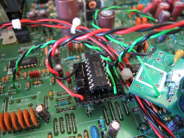

Jaap.
Use the right hole from R126 as for the hot wire and the middle hole of X101 for gnd. It's marginal closer to the servo. My 47R is placed on my vero. See pic.
I know, it's painted black, it seems to match the eye better that the brown pertinax. It's kind of stealth

No probs mate.
I direct coupled mine with no resistor, and as avr300 said use the hole from the 1M resistor.
Brent
