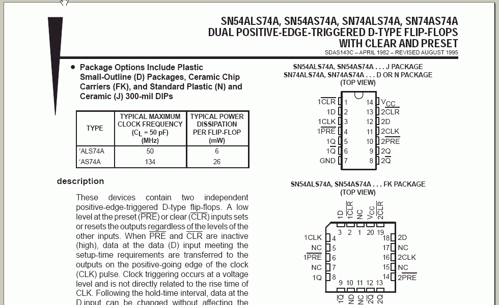

Also you mentioned you cannot find a 74LS74, Farnell in the UK have them. Also remember you need a D type Flip Flop with both normal and inverted output.
Brent
Didn't do much with IC's the last 20 years so I wondered if the SN74ALS74N can replace the mentioned 74LS74.
Jaap
Jaap
Yes its fine mate and here is a snap shot of pin outs.
Its exactly the same
Brent

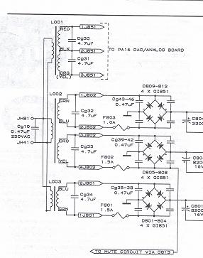

More Improvements
Hi.
As well as the caps across the rectifier diodes, has anyone tried caps across the actual windings?
It may be difficult with the standard transformer but should be possible with extra Txs.
Values shown are 4.7uF/100v Pana. ECQ Polyester
Andy
Hi.
Andy
Re: More Improvements
Not tried that. Interested to hear of any gains.
Brent
poynton said:Hi.
Andy
Brent
Caps across the diodes alone will change things, but not necessarily improve them. Here's a really good (if rather technical) read on the art of snubbing, or why you should consider adding a series resistor with the caps:
http://hagtech.com/pdf/snubber.pdf
martin clark said:Caps across the diodes alone will change things, but not necessarily improve them. Here's a really good (if rather technical) read on the art of snubbing, or why you should consider adding a series resistor with the caps:
Nice reading Martin.
I guess one could experiment with a 500mHz osciloscope and a given value for Cs by varying the value for the resistor?
Regards Jaap
