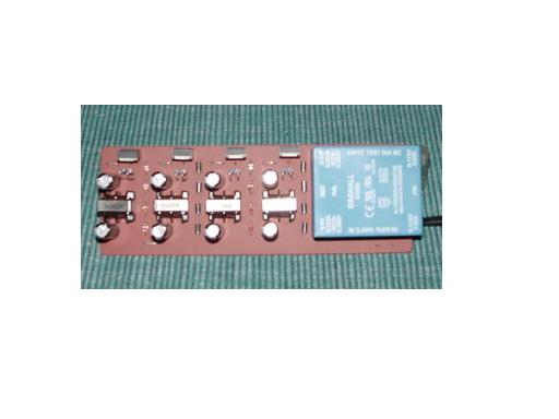

Ray thats got me thinking again......what if I build +/- 12V supplies for the driver IC's rather than using the the raw 10V....mmmm
Brent
Hah! Another upgrade and another Reg or two! Warren G would be proud!
rowemeister said:Ray thats got me thinking again......what if I build +/- 12V supplies for the driver IC's rather than using the the raw 10V....mmmm
Brent
What would be left on the onboard 12V psu?

I don't really have the onboard 12V. I have dedicated audiocoms right next to the opamps
Brent
rowemeister said:I don't really have the onboard 12V. I have dedicated audiocoms right next to the opamps
Brent
Do you have four of these regs for 12V supply or just two? 😀
Some regs need at least 10mA for good regulation though.
Brent
Ray.
Brent
In theory, the servo drivers do not require a regulated supply since they output a voltage according to the drive signal / VRef.
BUT... the main point to bear in mind ... these are the only supplies that are fused and for good reason... high current possibilities !
Any regulated supply MUST be able to source more than the blow current of the fuses. I would think a 3A supply would be adequate on each line otherwise your servos [ tray motor, etc] will not cope at peak demand. So the standard Audiocoms won't do !!!
Andy
I was not going to use those regs for the reasons you say, and im not going to use the more expensive ones for that circuit either as that would be very over the top and pointless IMHO.
