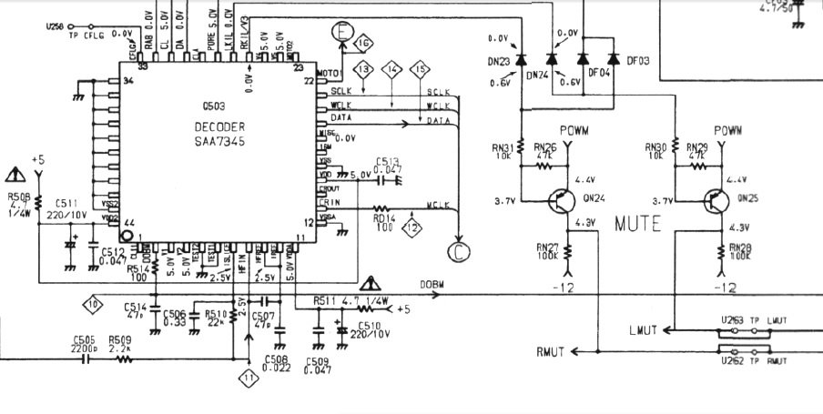

Let's have look at the decoder.
DOB is spdif Let's prove spdif is good!
C ls I2s.
What else can we see here?
You should test the coax output. If it is still working, maybe just lift the resistors from the IC to opamp and close the hood.
