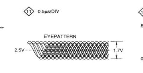

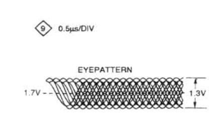

CD-43 should be the same family as 63:

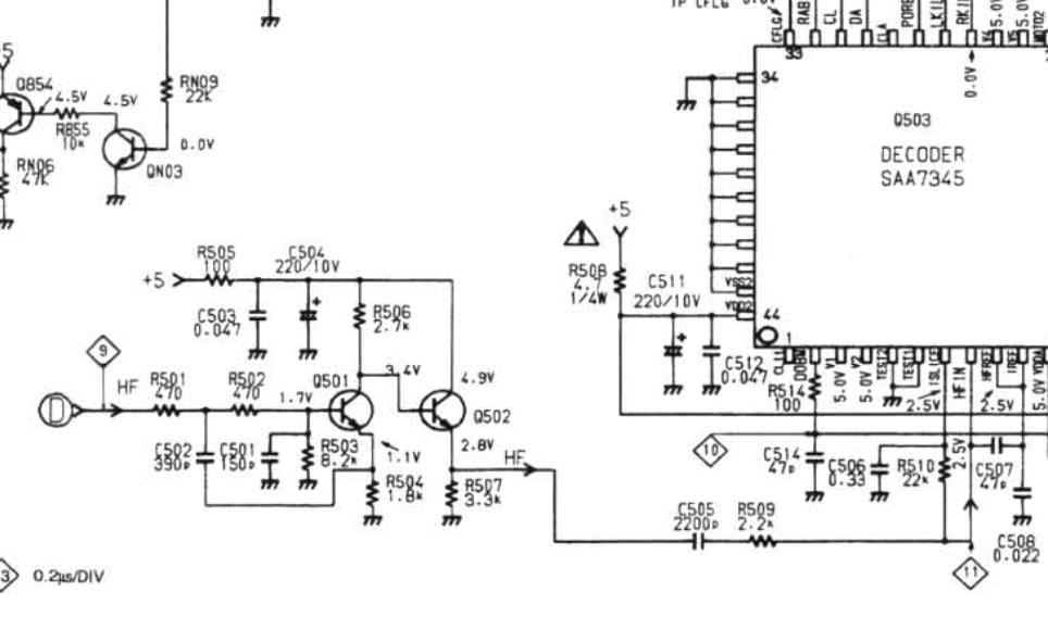

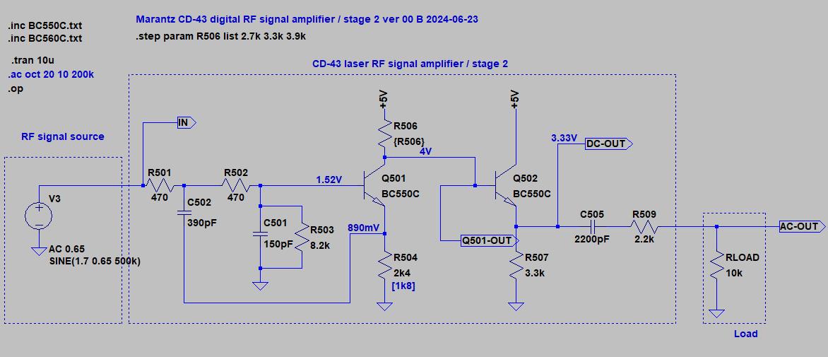

Fortunately the gain of the amplifier stage is tweakable (unless the laser is completely bust).
Simulated a bit before doing the changes...

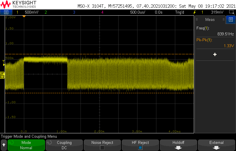

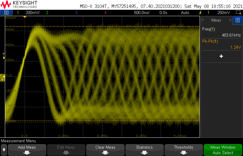

The drawn pattern isn't very good. It is showing double lines where there should be single lines.
The first pic is a decent eye pattern, but off a DSO, an analogue scope would show a much cleaner pattern. The second is E-F balance set correctly using Pierre Verany test CD #2. This is a much better / finer setting than what you would see in a service manual. This is the RF recovery after an interruption. You can see the scope settings on the top. The recovery waveform is tricky and requires coupling and trigger level changes (= a pain).

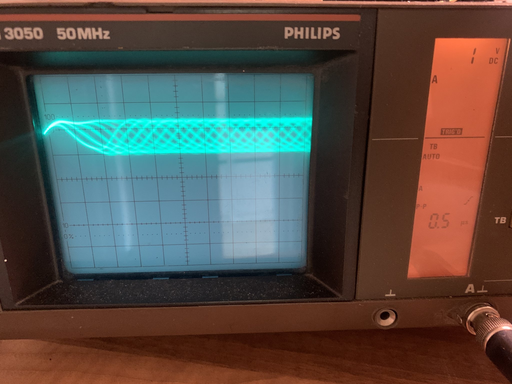

Right… greasing the wheels didn’t help much. I noticed by the way that the non playing disc(s) would play the final tracks of the album (like track 15-17 of 17). So I suspected the tracking motor/mechanism and greased that. No luck.
Then I measured the eye pattern, indeed on the discs that don’t play well, the pattern seems clipped/intermittent. On the discs that do play well, there is a wobble synchronously to the disc rotation. Hence I suspected the spindle motor.
I couldn’t find a hole to grease the bearing of the spindle motor but then remembered I have a spare cdm12 laser assemble, and put that one in (ie replaced the laser and the splindle and tracking motor).
Result: same symptoms (now even the final tracks of the same disc don’t play anymore, but the discs that were fine before still play).
So assuming something beyond the laser/motors…. Ideas?
Hi studiostevus,

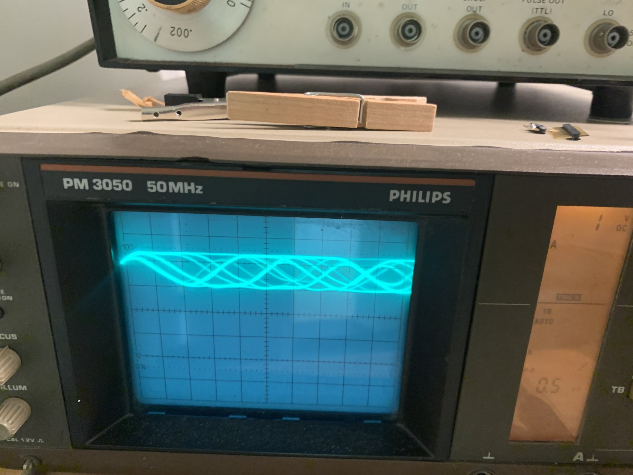

Please post a picture of a "good" eye pattern. What is the amplitude and how does that compare to the "bad" discs? A picture of that wouldn't hurt.
Is the amplitude increasing and decreasing, do you have horizontal waving (time axis)? Remember, on my bench it is easy to figure out, it isn't on my bench. The same for others here, we can only go on what you tell / show us. What you say make form the basis of assumptions we have to make, so please be accurate.

This is what I see. First the scope pattern playing a functioning disc. Second a non functioning disc (trying to read TOC, giving up after 2 seconds)
