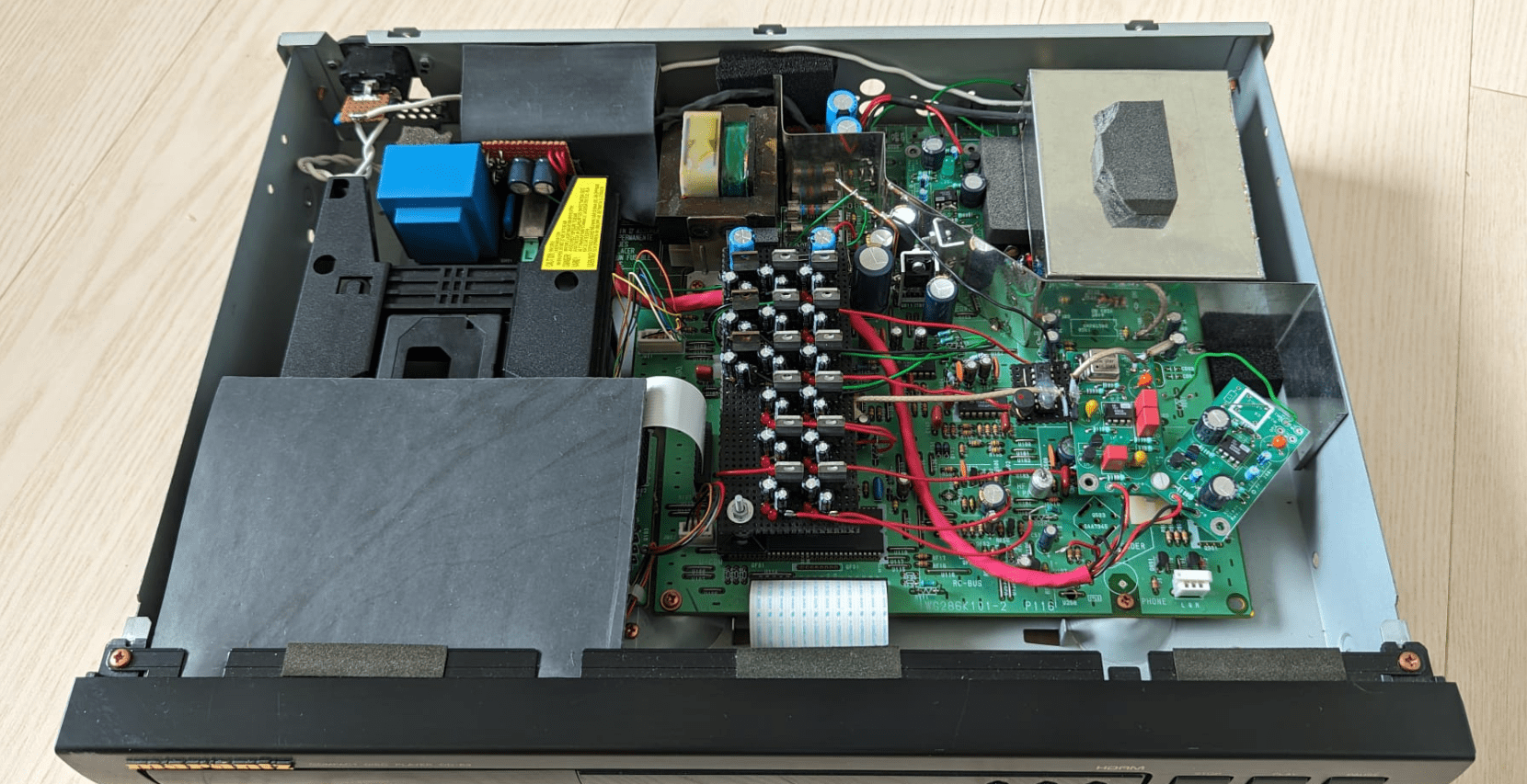

Hi Tim.Hi, I've acquired a CD63OSE which has a small issue and I'm hoping somebody here can point me in the right direction to fix it. When switching the unit on, and when the loading tray is already fully closed, the loading tray motor spins for a second or two before stopping. In all other respects it behaves perfectly. Does anybody have an idea what might be causing the problem? Thanks in advance.
Sorry for being a little late to the party. I dough out my old 63 and fired it up. I does exactly the same. Then I compared it with my second 63 - it does the same. I guess it's by design. Yours perfect all right.

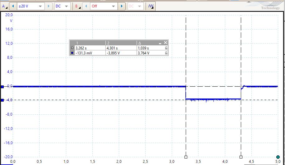

Measured the power on sequence of tray motor on my CD-43 (same product family as CD-63) - the tray motor is powered for about 1 second when powering on the player (even with closed tray).
Motor spins during that time and it is audible.

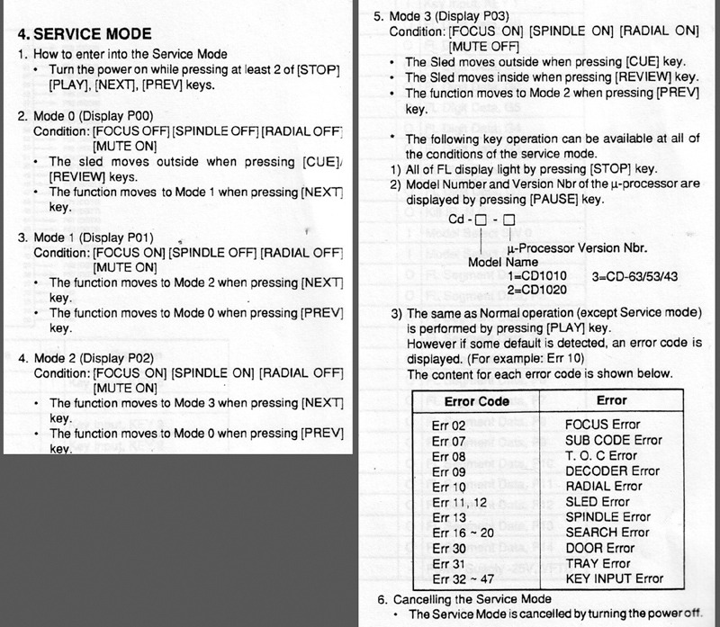

Thanks, yes, I looked at this and concluded it wouldn't reveal a design fault.Don't forget the CD63 has a self-test service mode you can try! From the manual - as attached.
