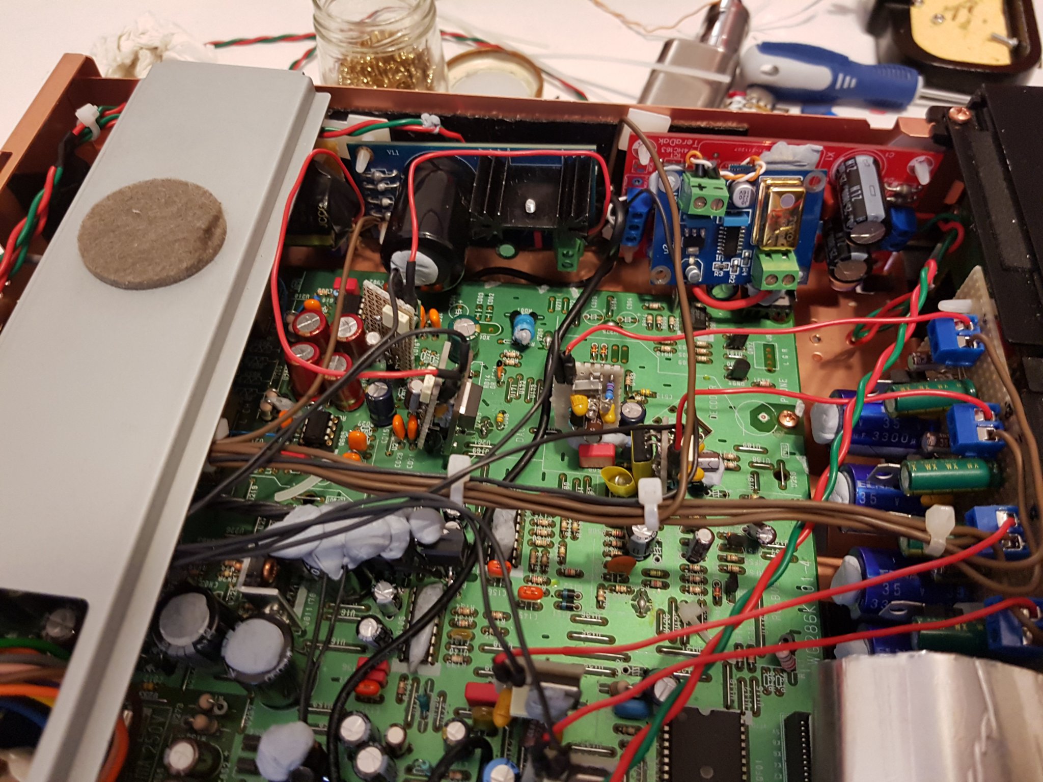

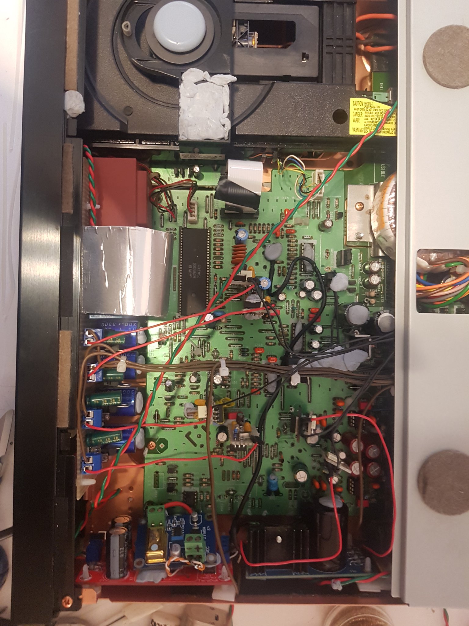

after a period of absence, due to the birth of my son Luca, I finally completed a series of mods to my Marantz CD63 Ki:
Here are some bad photos taken with my old smartphone
Next step:
Many Thanks!!

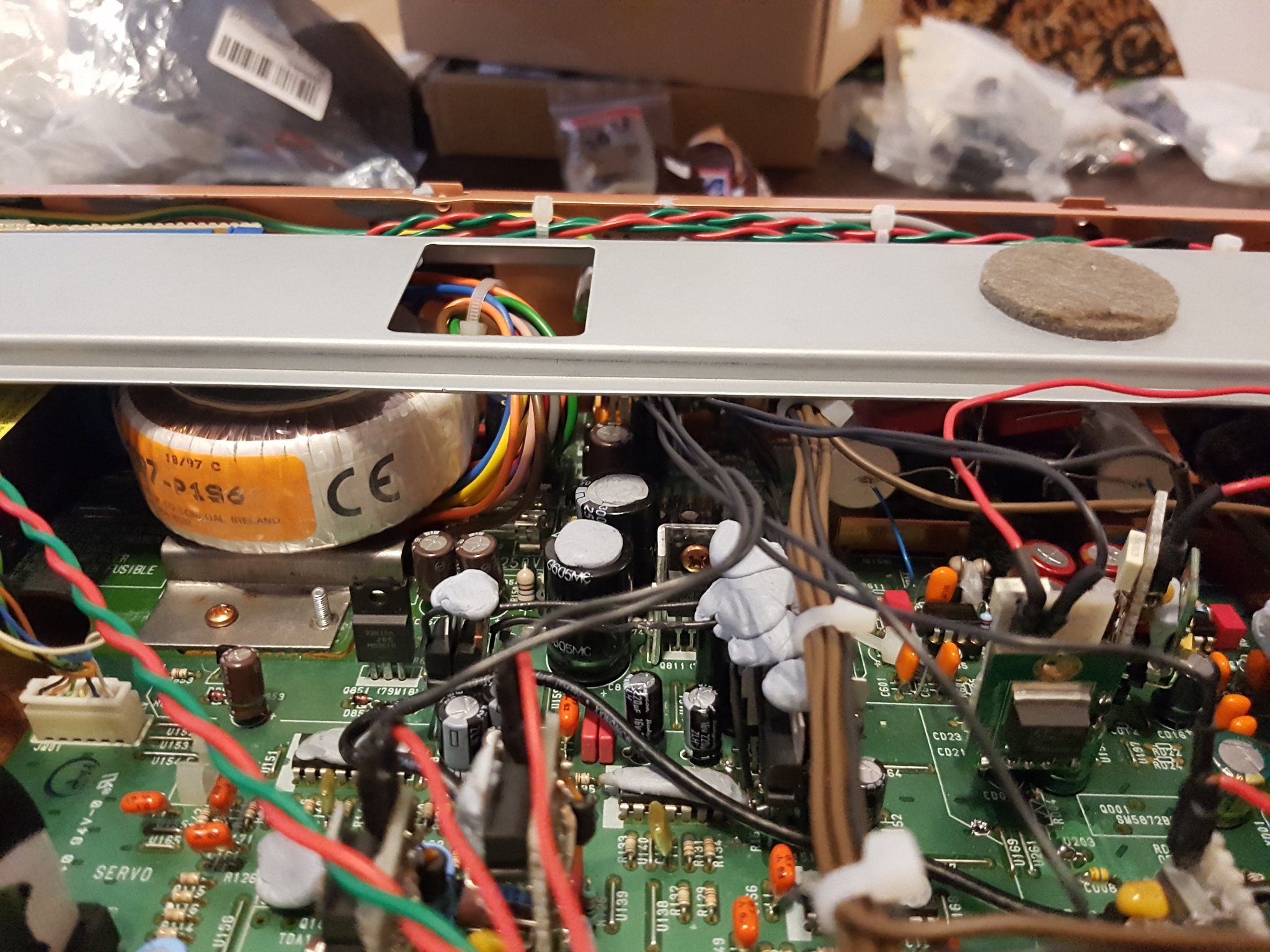

- Dedicated power supply for DAC SERVO and DECODER,
- Pre-regulation at 9V and use of Raygulator + gryator on 5V (analog and digital) for each Chip
- All the masses of the mentioned power supplies have been brought to a single STAR GROUND
- Modification with 7809 controllers of the SERVO system (connection to STAR GROUND) and addition of decoupling CAPS
- A new DAC and SERVO clock with dedicated power supply
Next step:
- RAY's DOS with external power supply (2x18 30VA), there is no more space inside;
- 2x15v 50VA toroidal for SERVO SYSTEM and upgrade cap (813 814 with 2x22000uf 25v) and 1AT fuses
- COAXIAL cable for RF HF from CD PCB to MAIN PCB
- RELAY installation in place of existent MUTING (I still have several doubts about the procedure,
Many Thanks!!

Hello,What help would you exactly need? Seems that you have lined your steps pretty clear.
I would like to implement a new muting circuit with relay to replace the existing one with transistors, would you have any help for me?
In this thread there are many suggestions but they are not very clear to me;
Thanks so much for your help
Buy a relay module from eBay or Alibaba or solder it together yourself, solder out the muting transistors, connect the relay module - looking at the job history you are posting above - what is exactly your problem?Hello,
I don't know, this is the first time I try to work with a relayBuy a relay module from eBay or Alibaba or solder it together yourself, solder out the muting transistors, connect the relay module - looking at the job history you are posting above - what is exactly your problem?
but I think we need to connect a relay pcb to the emitter positions of QN06 and 05 after the output stage, and take the muting signal from the decoder (I think from the positions of the QN24 / 25 collectors) and the voltage from QN02
But then shouldn't the original tracks of the old muting also be disabled?
I also have a doubt about how to connect the relay pins to the signal and GND ...
I admit, however, that I have not yet thought about it much and I am not even an electronics professional but only an enthusiast, and not a long-time one,
I apologize for my English, even though I am assisted by G..gleTrans
