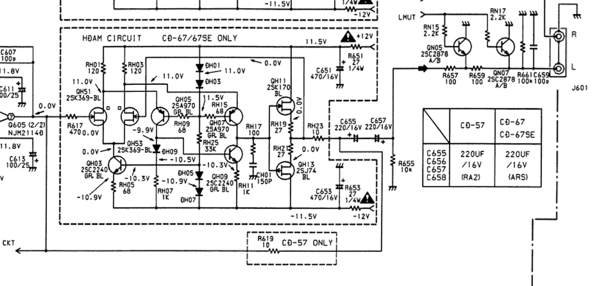

Having bypassed the Hdam on my CD63 I have offsets on the outputs of 12mv and 21mv, what size capacitor to reduce this down to zero?
A 47uf 35v and 330k or 390k to ground on the output side should work well and preserve LF response into any normal load. Fit the cap polarity according to the offset polarity.

Most probably you have a DC blocking capacitor in the input signal path of your preamplifier.
When starting to bypass then these caps and their following muting stage are the first things to jump.
If you desperately need a capacitor in the output then take Wima film capacitor and use that instead of these double lytics.

Wow, bypass the HDAM? That's a great buffer circuit and you'll do more damage than good with a higher output impedance.
Removing coupling capacitors will also not change the sound at all, but will pass DC offsets.

Hi, I've acquired a CD63OSE which has a small issue and I'm hoping somebody here can point me in the right direction to fix it. When switching the unit on, and when the loading tray is already fully closed, the loading tray motor spins for a second or two before stopping. In all other respects it behaves perfectly. Does anybody have an idea what might be causing the problem? Thanks in advance.
No focus lock.
This may be normal behavior, it is trying to detect a disc, but most machines don't spin the motor until they get a lock on a disc. If it reads a CD fine and plays okay, don't touch it.
Thanks but I wonder if we are talking at cross purposes. I'm talking about the tray loading motor which spins and slips on the rubber belt. However, the belt is a bit loose so perhaps that's the problem. I'll fit a new belt in any case.

The limit switch for the loading tray appears to be fully functional so I think something else is causing the tray motor to run for about second at power up. Could this be normal behaviour, it seems odd that the motor would try to run with the loading tray already fully retracted and the switch engaged as doing so would stress both the motor and drive belt. An easy solution might be to convert it to manual push/pull open/close, in which case, can I simply disconnect the motor? It appears to work well enough.

Hi, I tested the switch by removing the loading tray which makes the motor want to run continuously, then I manually triggered the switch which stopped the motor perfectly. There were no problems with that so I'm wondering if, upon initial power up, the machine automatically checks that the tray is fully withdrawn by means of a quick pulse to the motor which lasts no more than a second, and I assume that with a sufficiently tight belt and the tray where it should be the motor wouldn't rotate. The belt currently fitted is very slack (I have a replacement on the way) which, I now assume, is why loading motor spins and slips at start up, but I'll see what happens with the new tighter belt.
