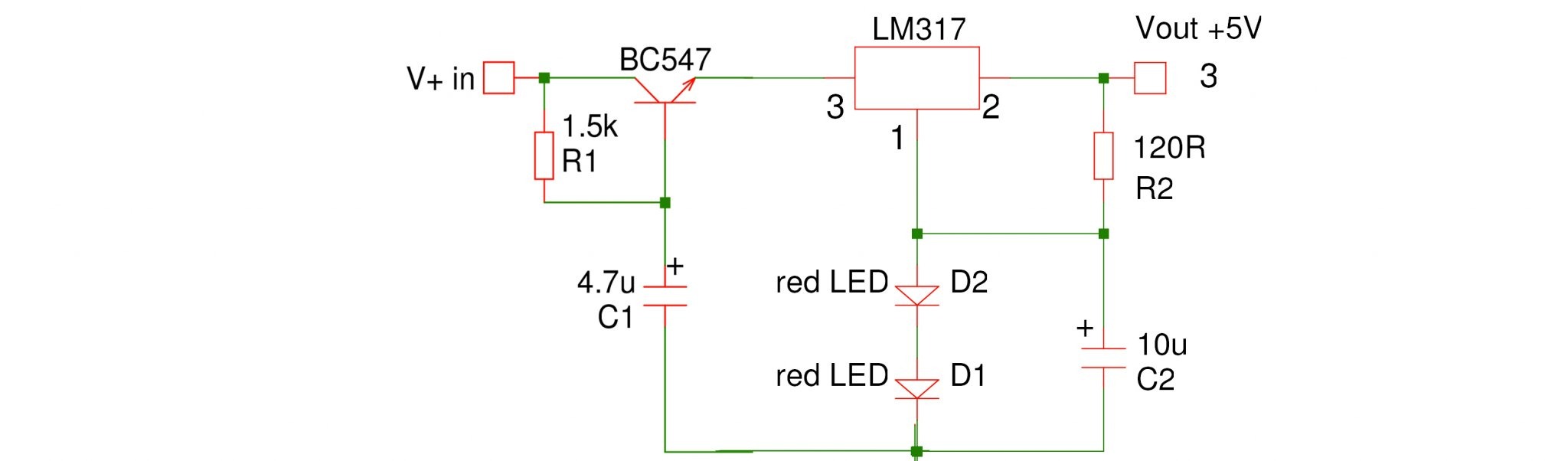

Elna Silmics are nice, but to be honest any reliable brand of cap with low ESR and ESL figures will work fine, just have a trawl through some datasheets and be wary of any 'boutique' brands that don't quote ESR/ESL data.
From the mods you've posted already, I'd say the next step would be to have seperate 5V regs for the left and right analogue DAC supplies and DAC digital supply (so 3 in total) would be a good upgrade, Ray's Super Raygulators work perfectly. You will need to cut a couple of traces to seperate the two analogue channel supplies, be careful! The file below is for the +/- 12V versions of the Super Raygulators, for +5V you don't need the zener diodes, just a couple of red LEDs (you may need to play with the LED colours, I bought a cheap bag of mixed LEDs and foud one red, one yellow gave the perfect 5V output). After that you're into re-clocking the servo and having seperate power supply regs for each servo amp chip, plus replacing the resistors and caps in the IV conversion filter between the DAC and the opamps using 0.1% low ppm resistors and polystyrene caps. Both Ray and Mauro changed the filter values slightly to give a different curve around the 20 KHz mark, Ray used the Bessel filter mod and the info on Mauro's tweak is attached. Don't use both filter mods together as that rolls off the highest frequencies a bit too much, this is a case of trying the variants and seeing what you prefer for your system/room/ears/musical tastes. Oh, and upgrading C505 to a decent polystyrene cap is well worth it too - the list goes on!

Thanks a lot once again for the infos, in these days I will try to create the 5V (super)rayregulator, and insert them in the pcb.
I think I'll start with the +5V D / A of the dac.
Should I do them this way?
