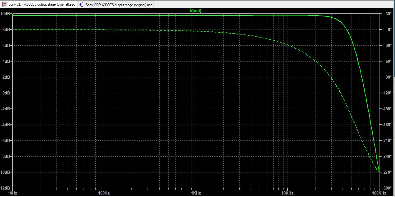

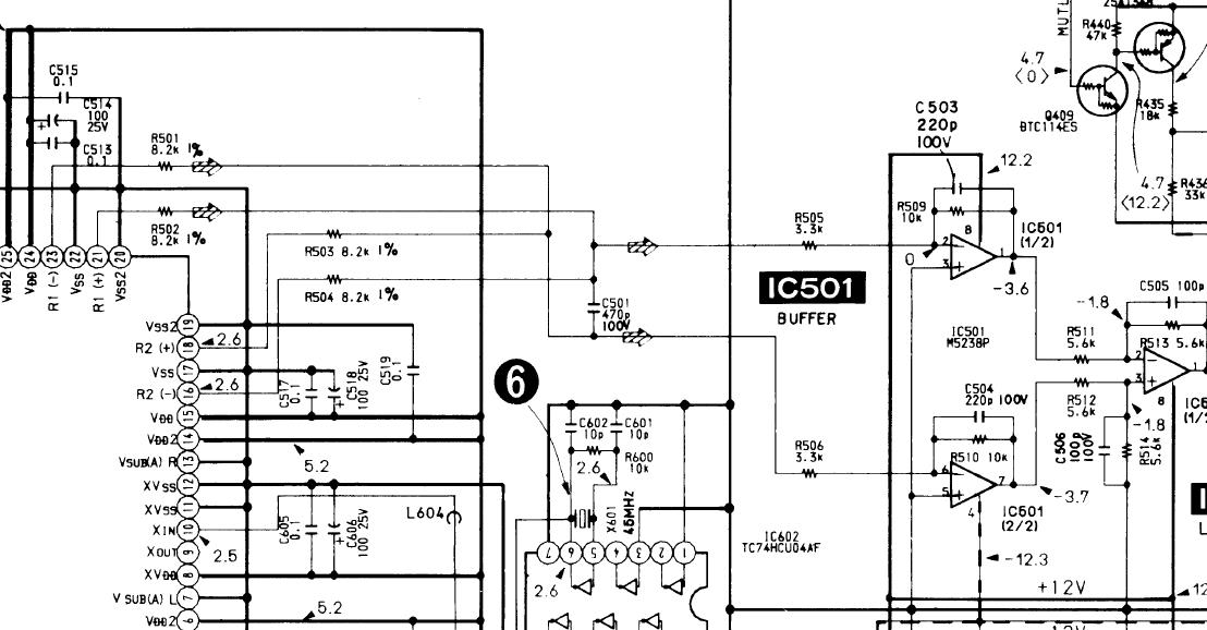

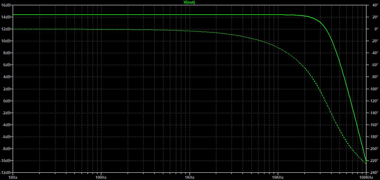

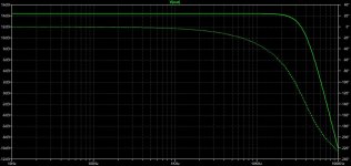

I would like to implement the DOS in the SONY.... can it be done with the stock DOS circuit ?
DOS has differential input, Sony output stage has differential input
- why would it not work?
