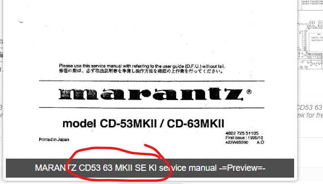

The seller seems ligit with good feedback , but will have a look for a local supplier for future purchases . Cant seem to find a shematic for the SE and KI , are they availiable , I only have a pdf for the standard which includes the 43 53 and 63 .

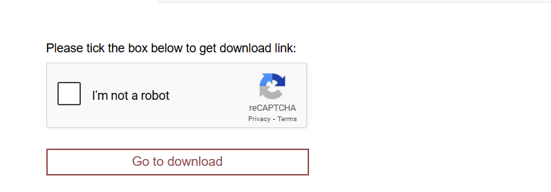

Try ElektroTanya. The site is fine but make certain you do not click something unintended. Click this and nothing else.
https://elektrotanya.com/marantz_cd53_63_mkii_se_ki.pdf/download.html
Looks to be the SE and KI version.

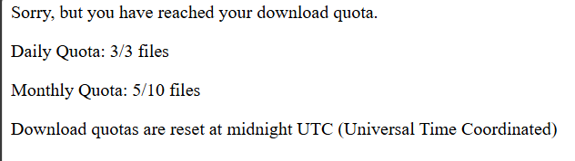

The Electrotanya link didn't have the full manual 🙁 Sorry about that.
HiFi Engine has the KI and SE supplements but the site is objecting to me. There is a supplement for SE differences which I can't get at the moment.
