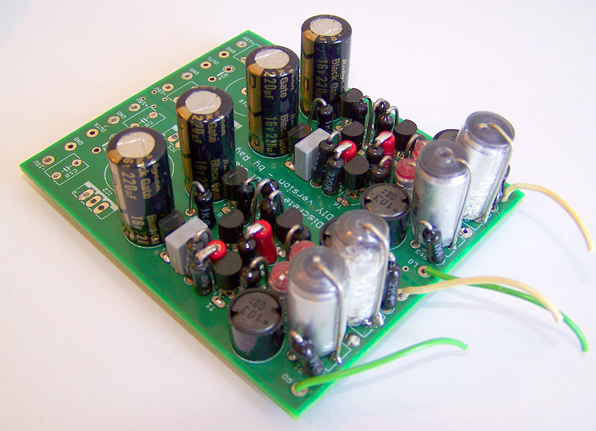

Any suggested mod for this player that doesn't have OPA ?
Things you could try:
a) taking the output before the output caps via e.g. 47R resistor (if the DC offset is within reasonable limits);
Separate the output stage power rails for channels.
b) use DOS output stage;
c) use the filter part of the DOS output stage and feed the signal out via e.g. OPA132/134 or other type of opamp.
d) move the project to the CD6002 thread 😉 .
