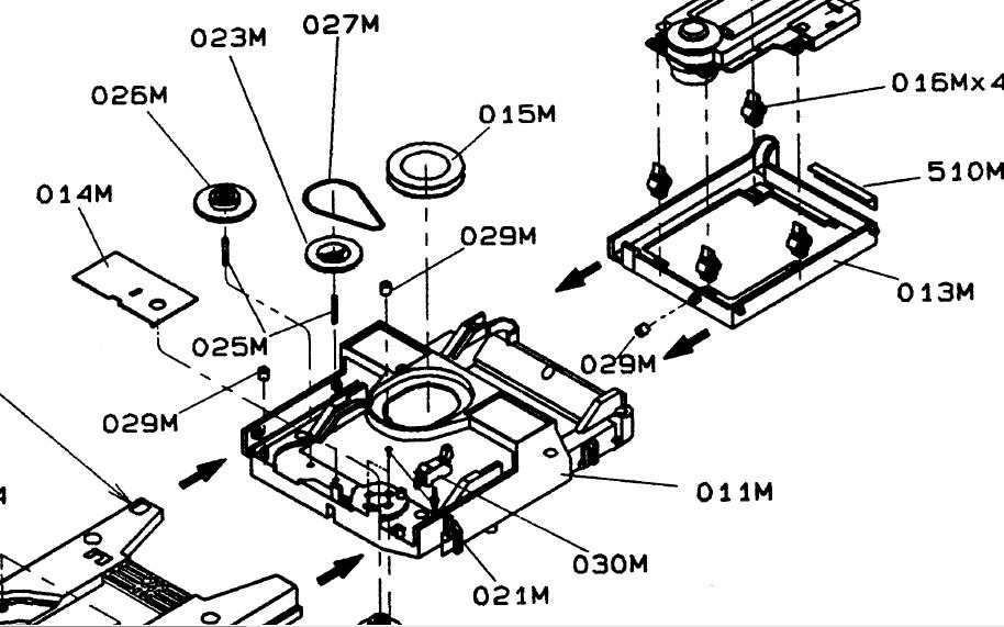

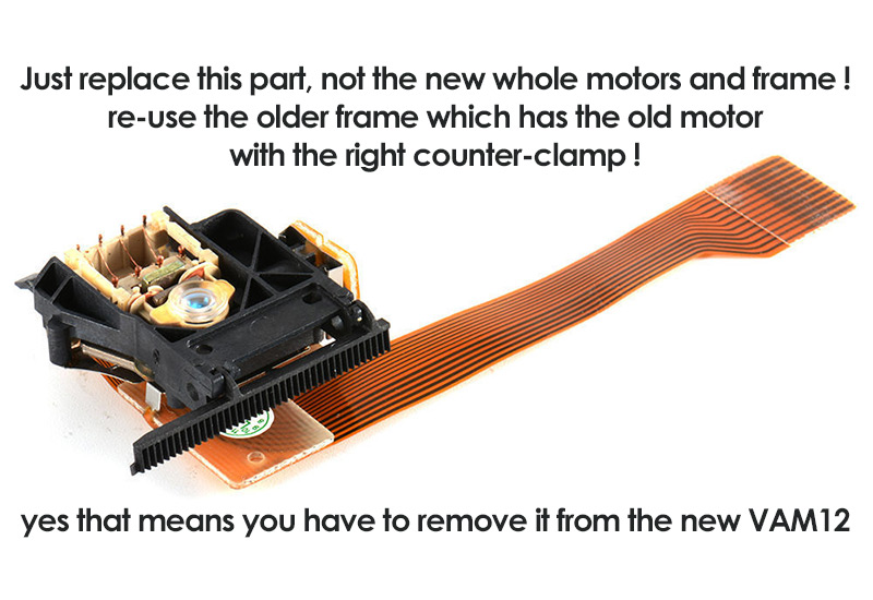

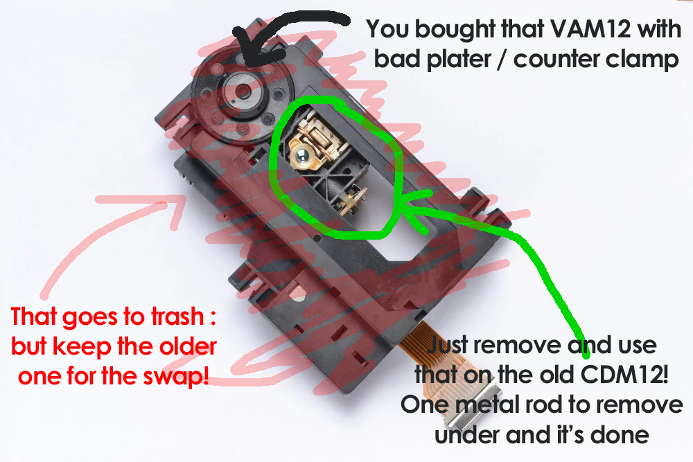

sorry I posted too fast and so my mind mixed things up a bit 😉 You have to remove the sled which is on a metal axle on one side and free sliding on a plastic guide on the other side, it's fully compatible and then you have a fresh laser on the former CDM12 frame. I thought the metal rod/rail was on rubber support at its ends, maybe not.
You will end up changing this part and not the whole:
New Cdm12.4 Vam1204 Cd Optical Pickup Cdm-12.4 Cdm 12.4 - Buy Cdm12.4,Vam1204,Laser Unit For Jukebox Product on Alibaba.com
Take your time and it's just easier than it seems. Done it several times here 😉 While you are at it change the belt hidden under a tiny cover just next to the tray opening. That will prevent from loosen belt to squeal like hell and keeping the tray closed... 😉
