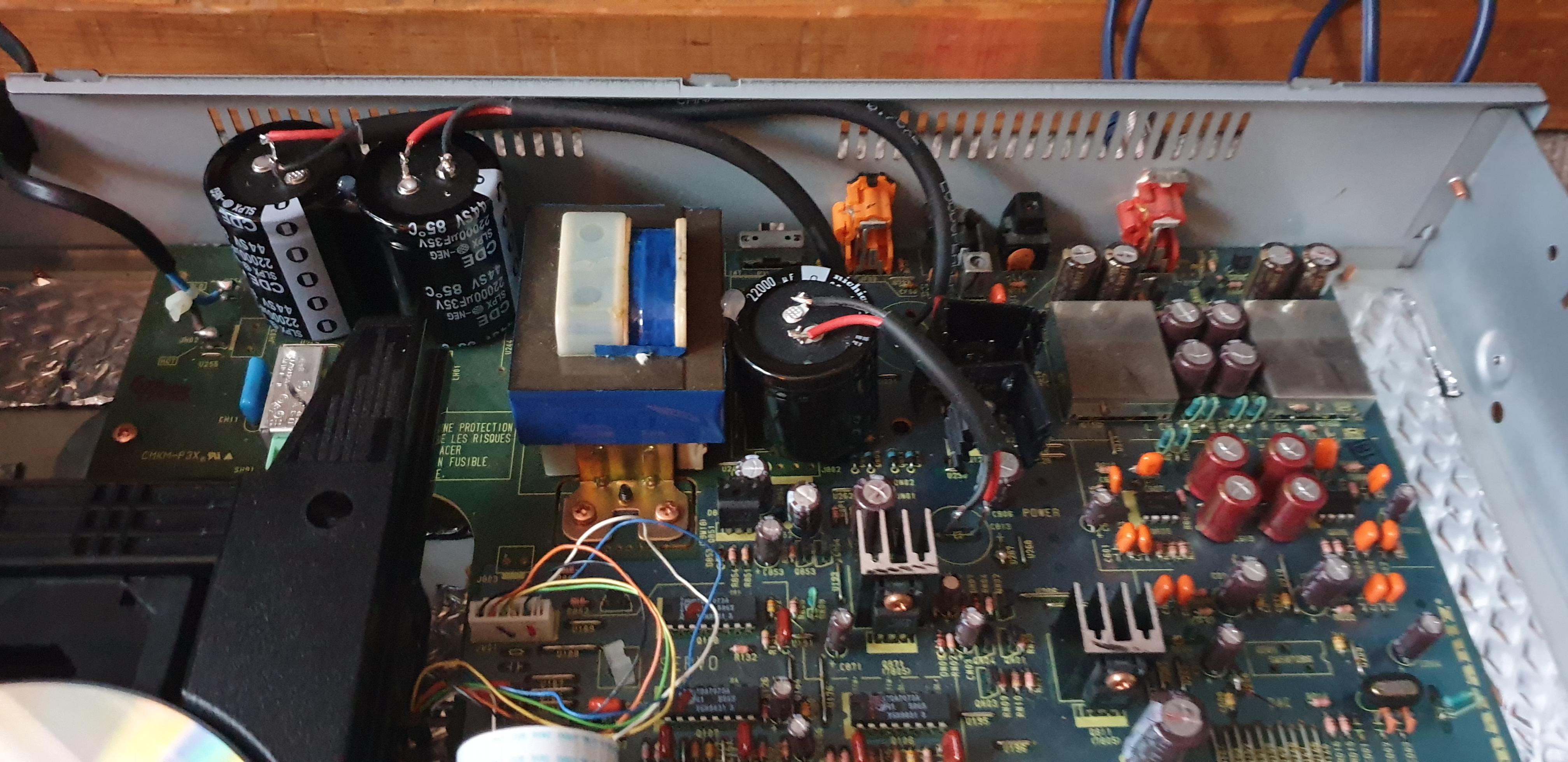

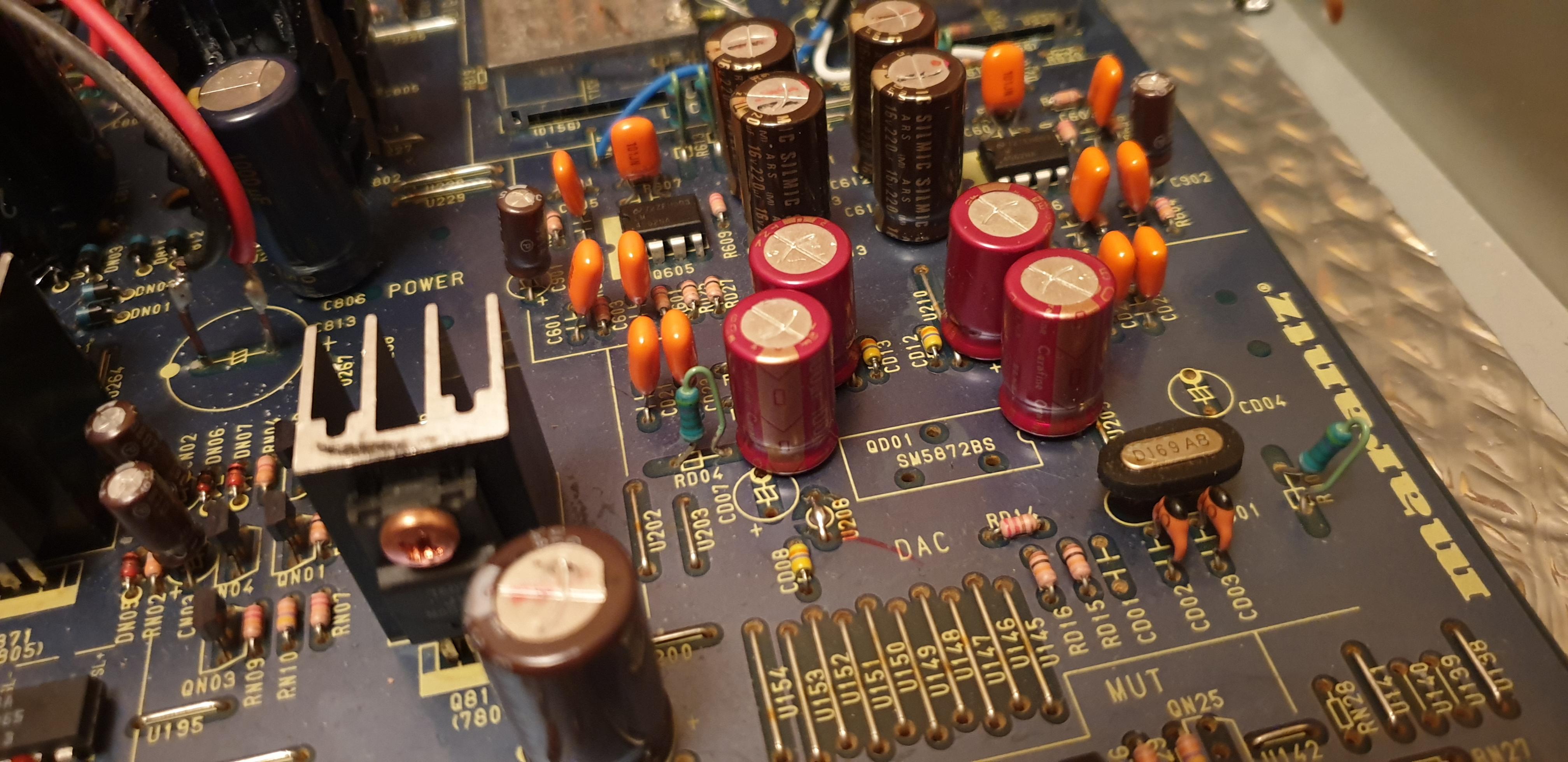

But today I have added 2x 22000 to the main smoothing caps and also 22000 to C814.
Also opamps changed for LM4562NA. My first dip8 swap.....solder wick works wonders!
First impressions...well it still works! Bass seems better. But it is more sibilant. Maybe just pushing the limits of other elements so perhaps HDAM bypass is required , though I do read this can emphasise the highs and lose some lows.
Other thing is the 12v regs are really warm. But I never checked them before to be honest. Have hashed on some sinks for now but they're a bit wonky
Edit...all regs are pretty hot.
When putting in faster opamps you should "fix" their power lines first - inductors, ferrite beads, bypass capacitor over power pins.
You should also measure the offset voltage at HDAM output to determine if you can bypass the output caps.
The regs do get pretty warm - if my memory serves me correct then I could keep my finfertip on them for a couple of seconds.
Whether to bypass or not (in the beginning) the HDAM - experiment and listen to the results.

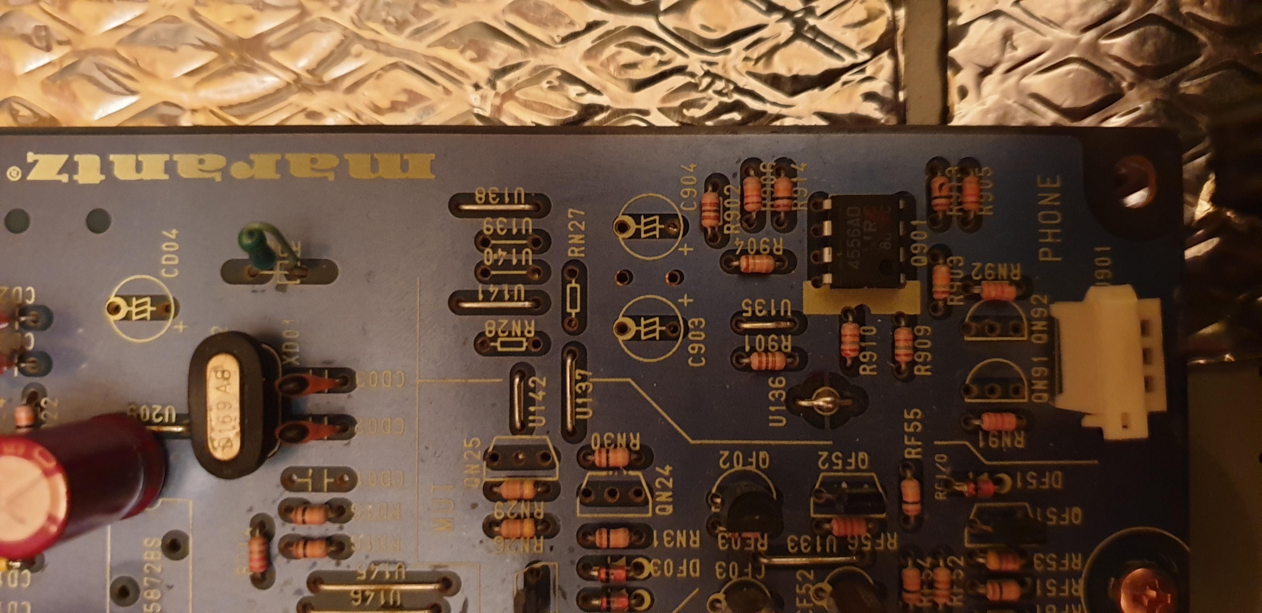

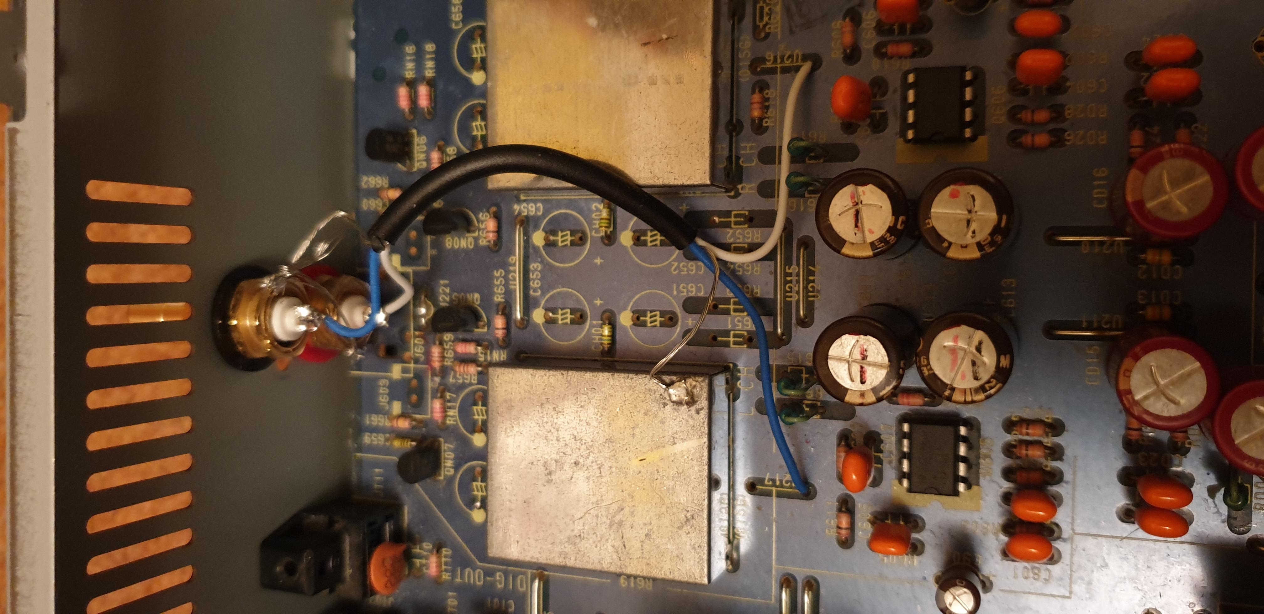

I did another round of mods today basically from Rays list of mods for the 67mk2.
Only did the simple cap swap and removal around hdam, dac and also muting transistors and link wires etc removed.
So now I have no music and 2.3 - 2.4 v DC at the outputs.
Measures this same voltage at pin 7 OP amp output. I have ran a wire from the old jumper pad downstream of the hdam straight to new RCA plugs. I picked up a ground from the hdam casing.
Any ideas what I may have cocked up?
I'm not sure those reservoir caps sitting on top of and next to live mains is a good idea tbh.
The resistance and inductance of the cable also seriously impairs the overall ESR and makes the cap much less effective at filtering HF than it would otherwise be.
If a mod has gone wrong then retrace what you did and if necessary reinstate it back to original state and see if the problem remains or not.
Looks like you've bypassed a few too many bits - see the photos in posts 11 and 39 and you can see better how it should be done. You need R661/662 (100K to ground) and at least some series resistance from pin 7 to RCA, Ray recommends 27R IIRC. I've always left C659/660 (100p) in circuit as well, though I think I upgraded it to polystyrene. Restore those bits and see what happens - you'll need to pull QN05-7, C655-8, basically what's on Ray's mod list🙂.
The U221 jumper can also be taken out and is a much better place to pick up ground, shorter loop area = less chance of interference
If you haven't already got a service manual from Ray's Audio Page, download one and study the circuit and board layout, bypassing bits not on Ray's list can cause grief! Good luck!
