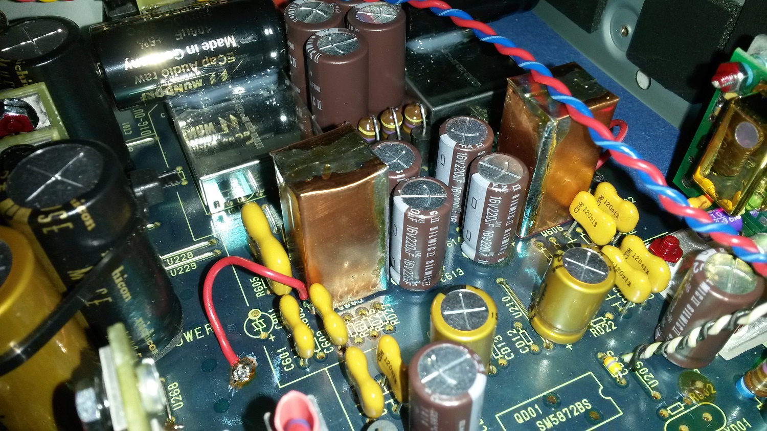

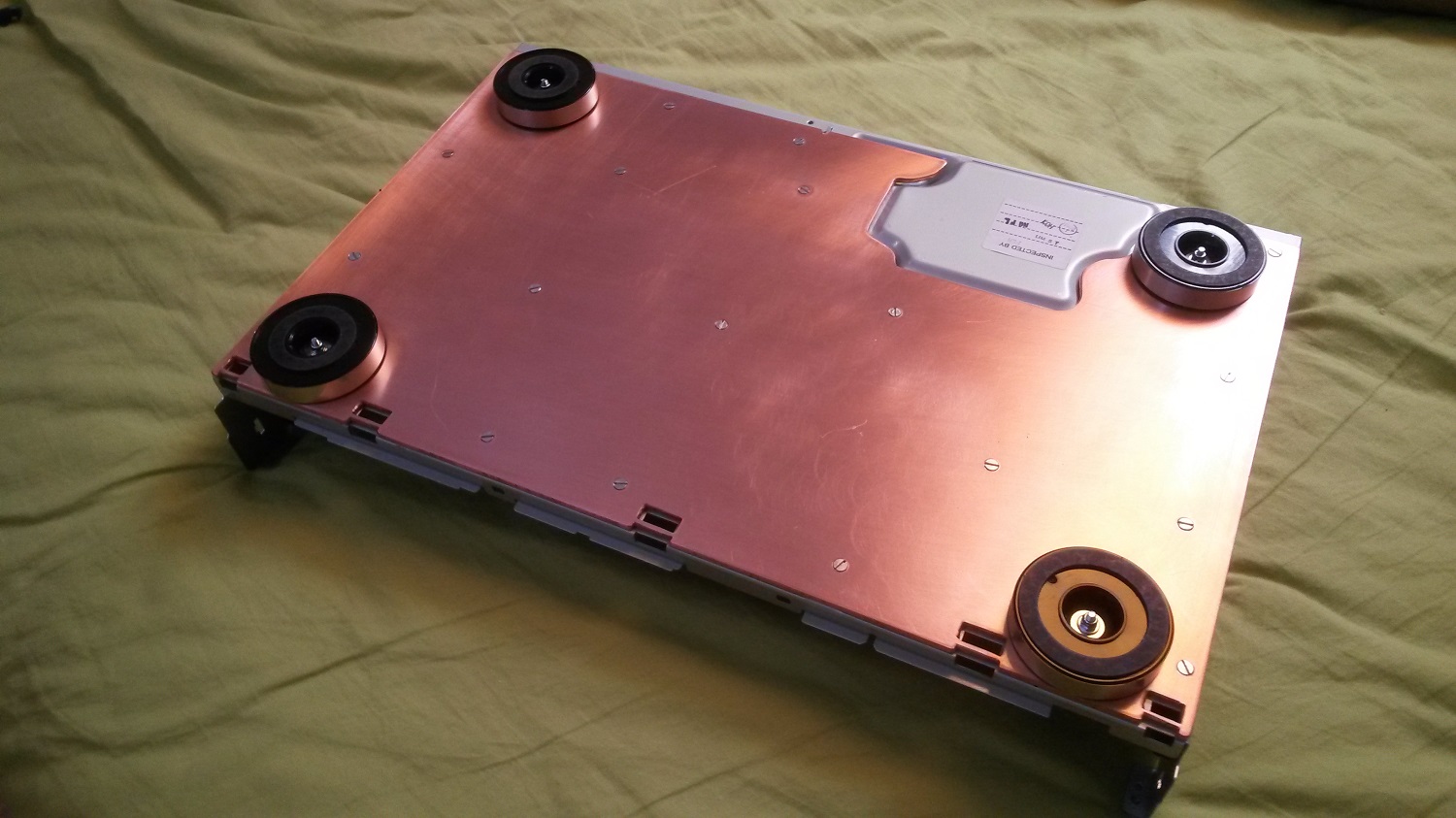

At the same time the CD was upgraded with:
- better inductors for all DC filtering points (470uH/2ohm EPCOS + 2 ferrites)
- 3mm copper bottom plate which also adds approx 3kg mass to the unit
- copper shielding for Burson opamps
Please have a look at photos.
Still hope that someone could comment about DEC reset problem at power on.

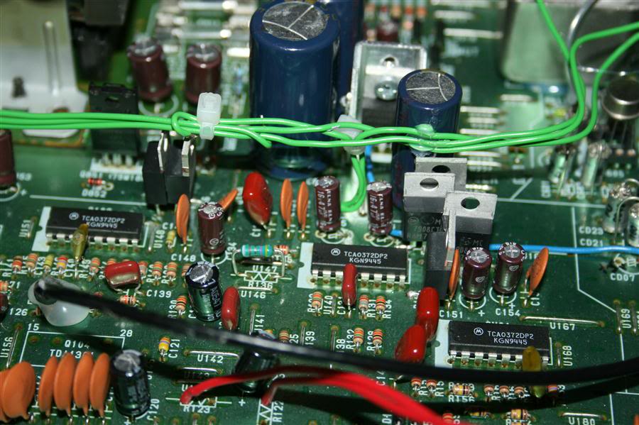

Hi Everyone,
After changing out a bulged 220uf 16v cap from C148, my cd63KI has developed a problem that I have identified as being linked to incorrect voltages at pins Q106.
Pin # Voltage
1 0.0v
2 1.2v
3 0.0v
4 + 0.49v
5 2.5v
6 2.5v
7 2.5v
8 2.5v
Pins 9 - 16 all + 0.495v
R149 measures -13.20v
R150 12.55v
At power up, the laser movement is visible and audible and in the dark the orange glow of the laser can be seen.
I have removed the pcb and inspected tracks and solder pads under magnification and bright light, but no obvious or tell-tale signs of of dry solder joints are visible.
For good measure I resoldered most pins, and jumpers, capacitors and resistors around Q106 but the condition persists.
I have a few spare TCA0372 driver chips so I replaced the defective component, only to find no change to the relevant voltages.
Any directions from this point would be appreciated.

Problem partially solved - R149 and R150 were replaced and voltages are all as per service manual.

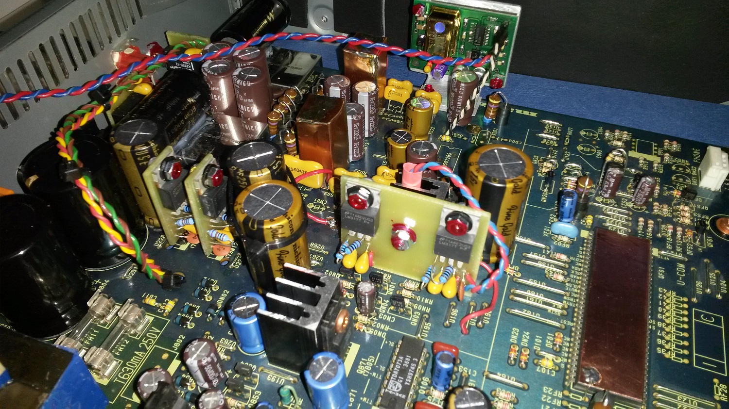

There is a detailed write up on how to provide power to the decoder after isolating it from the common supply at Q811. I have attached pics of the driver regulator mod and decoder clock mod. I haven't undertaken the project myself so cannot comment on the end result.
These pics are not my work, and were shared by a diyaudio member, I do not claim any credit for them.
Again, search the thread and regulate drivers power rails, add local regulators for DACs and decoder (LM317 with leds), a clock to the servo. Best bang for buck, made 5 or more CD63, that was among the best for the less job. It compared with a +2000€ brand new Marantz in down town shop... ( but had the DOS output, can buy PCBs on Ray's website).

thanks for the info 🙂 I notice on your photos that you have literally just connected regs straight onto the various sections od DAC etc and not on a board with LEDs? I was looking at using an LED based reg circuit but can't find a circuit from someone who's designed one specifically for audio - did you design yourself or lift the design from elsewhere?

Look at the one at the DAC, it's a LM317 with leds. Is it what you need? Check voltages on bench to tune if needed 😉
