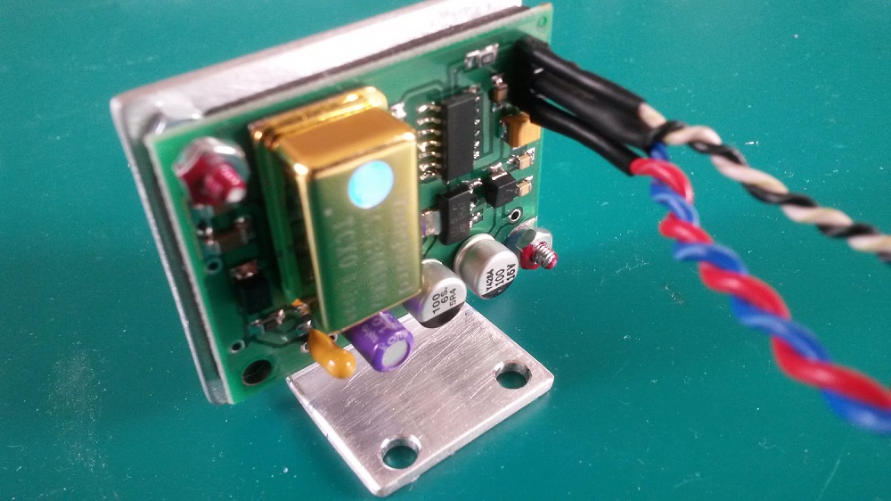

Now I did very intensive upgrade to my 20-years old CD 67 mk II:
- replaced all the caps in psu (Mundorf+nichicon + SMD ceramic in parallel for each electrolytic cap)
- +/- 12V regulators based on LM317/337
- +5V regulators separately for analogue/digital part of DAC based on LM317
- external "super clock" for DAC with dedicated PSU
- mains filter
- Bessel LPF - based on 1% silver mica caps + 0.1% SMD resistors
- for opamps I target to use Burson v5...
- i did also muting device based on relays
Most of mods based on Ray's WWW page which I followed many many times...
http://www.raylectronics.nl/index_en.html

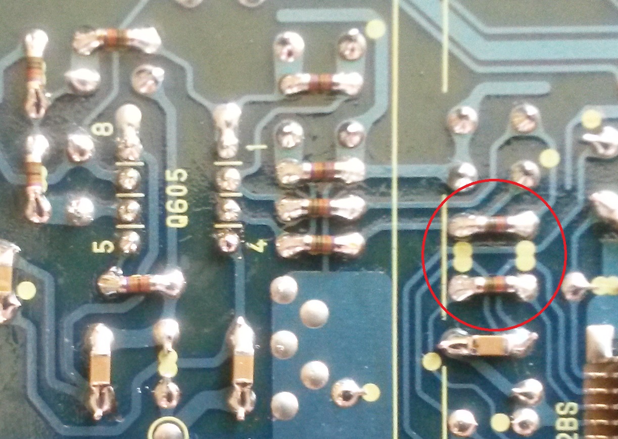

Now I'm in trouble:
- all PSU voltages are Ok
- muting relays works excellent
- clock for DAC is OK
but... no sound :-(
PWM outputs from DAC seems to be OK (switching 0 - 5 V)
Eye pattern from Decoder seems acceptable (approx 1.5V peak-to-peak)
But at the OPAM pin1 there is only approx 80-100mV peak-peak that can be measured...
I have all checked on the multimeter and/or scope...
Either:
- no proper signal from DAC...
or
- no signal from Decoder so DAC effectively converts nothing...
Does anyone experienced such problem ?
Thanks for your advice! Marcin

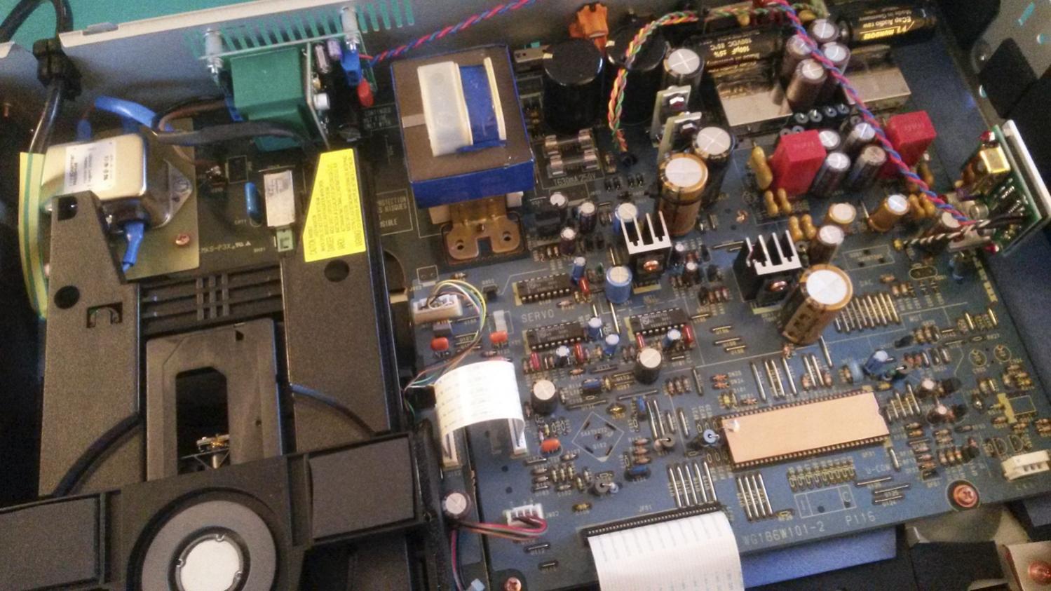

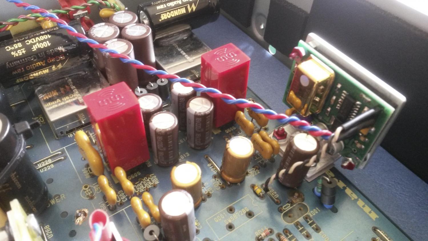

- mains filter

Just to update on the topic. It took me hours to find the problem source...
Shame on me! Stupid soldering mistake. Mainly the reason was the SMD and installation on the opposite side of pcb (no markings). That's my excuse only... The RDxx (actually DAC outputs resistors) were altered 90 degrees (!). Fortunately DAC is fine and working. It also looks like dual regulators +5V did not hurt the DAC.
I attached some photos of modifications. SMD-mistake shows exactly where was the problem. Currently separate AVdd and DVdd regulators for DAC are removed. DAC is working on standard factory +5VDC. Now its time to enjoy music for a while...
Regards
Marcin
