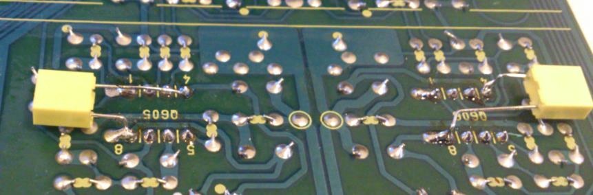

Hi, i'd like to replace opamp on my Marantz CD63 and i am following the guidelines described on Marantz CD 63/67
I don't understant were to put bypass film capacitors as described in the link.
Could anyone post a picture of where they must be placed (if i undestood on the other side of the PCB board).

In my modest CD-67 mod I placed the 100nF rail decoupling capacitors under the opamps.
As I have understood these caps have to be soldered as near to the opamp as possible.
The film caps over lytics are something that I have never tried - I do not think I can hear their presence.

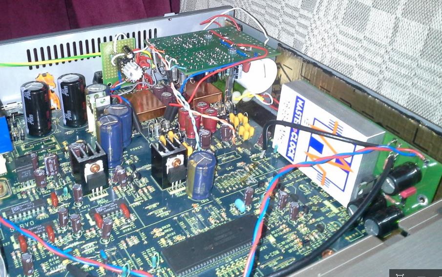

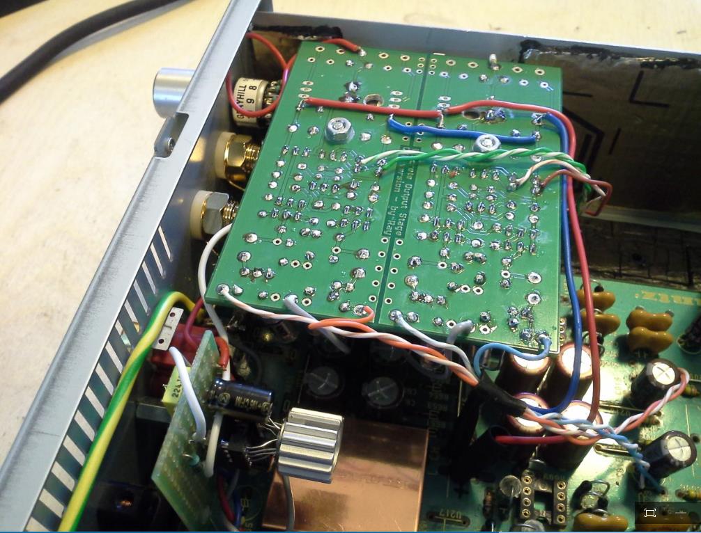

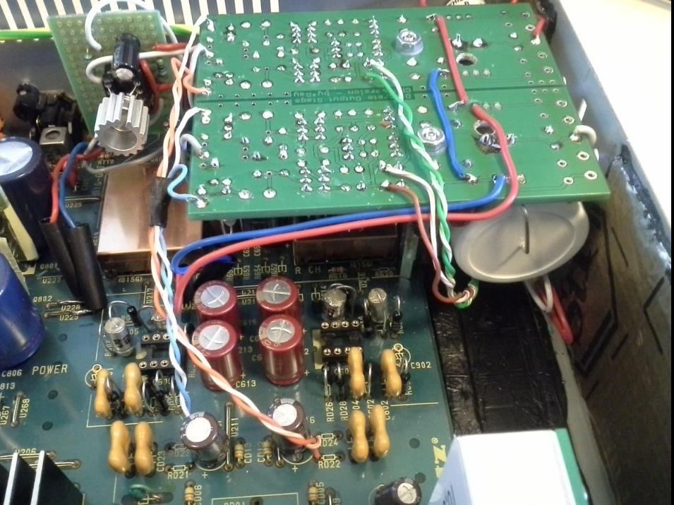

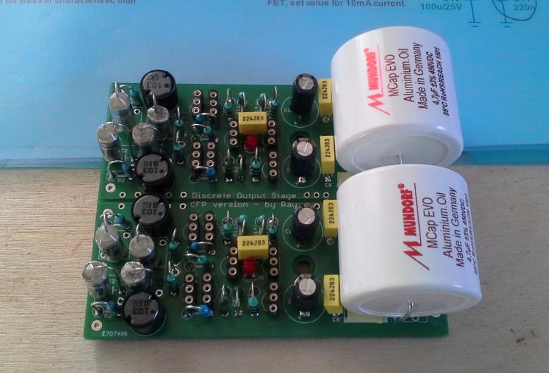

However I would say that modding the opamp stages was only an intermediate step to the final solution with Ray's DOS (with signal attenuated to the level of the rest of my "old" audio gear so that I do not to wrestle too much with my tube amp volume knob when changing the sources).
One of the first steps you take should be fixing the power sources (to whatever fancy level you decide).
Then you can spend time on listening to different opamps.
Then you should replace the clock.
At one point you probably decide to stop ;-)

I have applied a decoupling capacitor between pin 4 and 8 soldered on top of the opamp lm6172. I tried one first. The opamp now is fried. Am I missing something or should I decouple v+ and v- to somewhere else point?
I have never soldered any caps directly to opamps - my way is to solder them below the board (and use sockets for opamp rolling).
LM6172 did not stay on my like-list (after testing it out) also ...
Edit: 0,22nF translates to 220pF - are you sure about the capacity?
Sorry I mean 0,022uf, is this correct?
Correct is what you used - so what capacitor did you use?
This way or another, I have used 100...200nF caps (mostly 100nF) for this purpose.
I don't remember the brand. I've took them from farnell, they are blue with 63v
What opamp do you suggest? Opa2134?
I am using sockets but when I have applied the capacitor no sound was coming from that channel. After desoldering capacitor opamp was dead
You wrote that you applied the cap on top of the opamp - the only way to do it is to solder it directly to the opamp - or?
