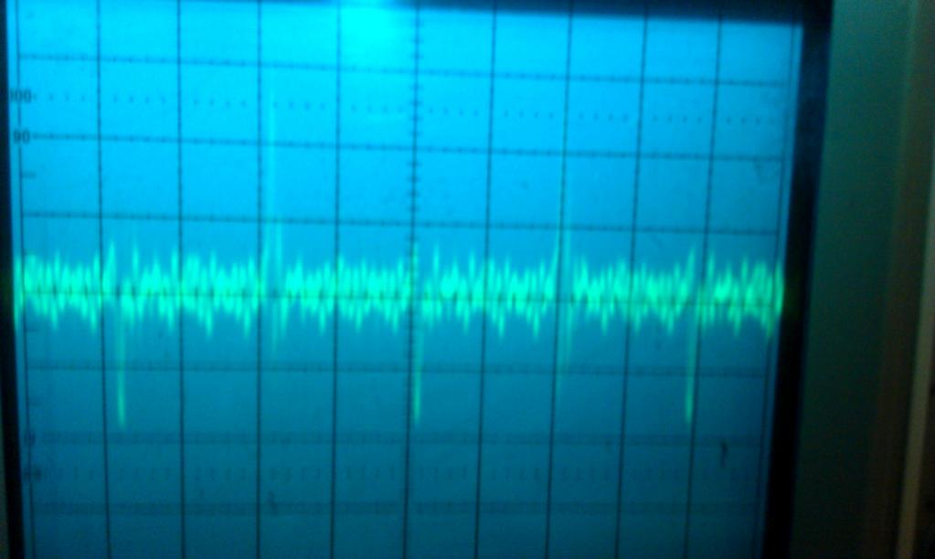

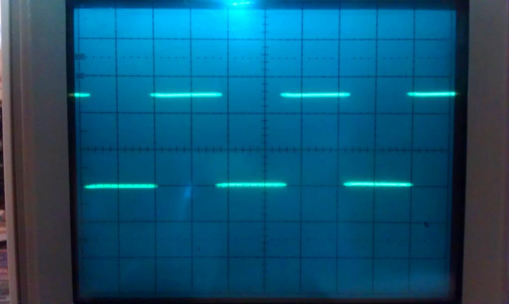

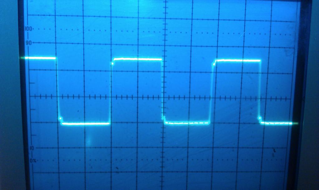

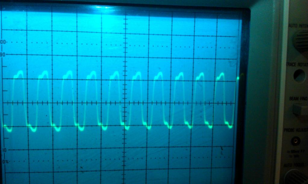

I've taken some pics of the signals I've got; the Flea clock, SCLK and WCLK look good but Data is just low level noise. That said, the state of the DAC chip is such that I don't think the processor is seeing the correct info so the CD doesn't recognise the disk and therefore doesn't enter play mode, so perhaps the Data signal is missing for that reason.
Here are the pics and settings etc:
1) WCLK 2V/div 5uS/div decoder side of RD13
2) SCLK 2V/div 0.1uS/div decoder side of RD12
3) Data 20mV/div 0.1uS/div decoder side of RD11
4) Flea clock 2V/div, 50nS/div

These all look o.k. to me. The DATA is supposed to be silent if player isn't running a disc.
I guess CKO at pin 4 (RD14) is also present, otherwise the decoder wouldn't output WCK and BCK.
So it doesn't read a CD at all? The DAC works typically one-way, the player doesn't need it to recognize a disc. The decoder sends the digital data to the DAC with no feedback the other way. The uC talks to the DAC to set oversampling mode and stuff like that.
