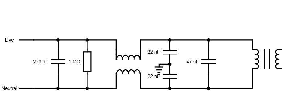

4) Added some input mains filtering on the board before the transformer; this is the mod I need some help with! I've attached the schematic below, basically I made this from parts taken from an old pc power supply so I don't know the inductance value for the common mode filter - the original supply was rated at 250W. The X class caps across the line are MKP type, the Y class caps are ceramic. It works and has decreased the noise floor still further and also seems to have increased the depth of the soundstage, BUT it's also killed the dynamics completely and the bass timing has softened so it now sounds blurred in places.
Obviously I'd like to keep the benefits of this filter without the downsides but I don't know where to go with this. At a guess I'd say the common mode filter is the problem and it's restricting input current too severely, but that's just my guess... any input greatly appreciated🙂

I doubt that a few uH of inductance in the mains line will hinder the current flow, I mean, mains frequency is just 50Hz so the extra impedance will be far below 1 ohm. The peak current demanded by the player will be provided by the large buffer caps in the power supply.
If you inserted two Y-type caps from both mains lines to the chassis, you should try grounding the chassis.

If by this you mean you have the outer gnd of the rca plugs connected directly to mains safety earth, this isn't ideal as it means you have your sensitive low level output signal directly wired to loads of other things on your mains supply with no filtering for noise.3) Fitted IEC mains socket and run an earth wire to the star earth point at the output RCA's - this lowered the noise floor and gave a better sense of space to the reproduction
The cd player originally only has a 2 wire mains connection with no connection for mains earth.
By all means have an EIC plug, but connecting the mains earth to the chassis or rca plugs may cause you more issues than it solves.
Thanks for that - both the Y caps run to a second earth point I made on the power board which is directly connected to the earth on the mains socket and the star earth point on the main pcb. I assume the chassis will be grounded via the RCA sockets on the backplate.

I did wonder about the possibility of getting extra noise via the earth connection or even an earth loop hum, but earthing by itself didn't seem to cause problems.
