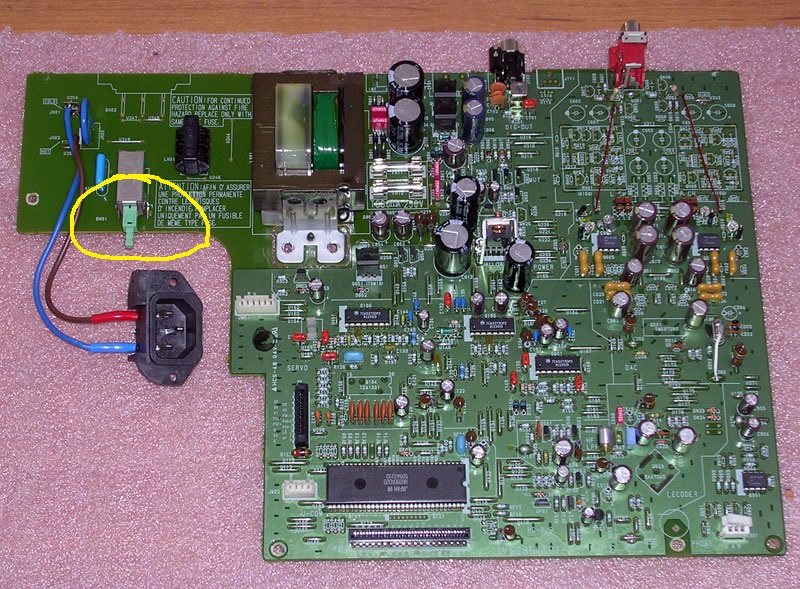

Thank you Ray.
Last time I had the case open I tried to free the PCB but couldnt find out the CD-Assembly Connection to the part highlighted in yellow
How do I disconnect this without doing damage?
Thank you Ray.
Insert big flat screwdriver from above in black plastic piece that goes around the green part and turn slightly to disengage.
Regards
Marko
Regards
Marko
Perfect Marko, will try that
