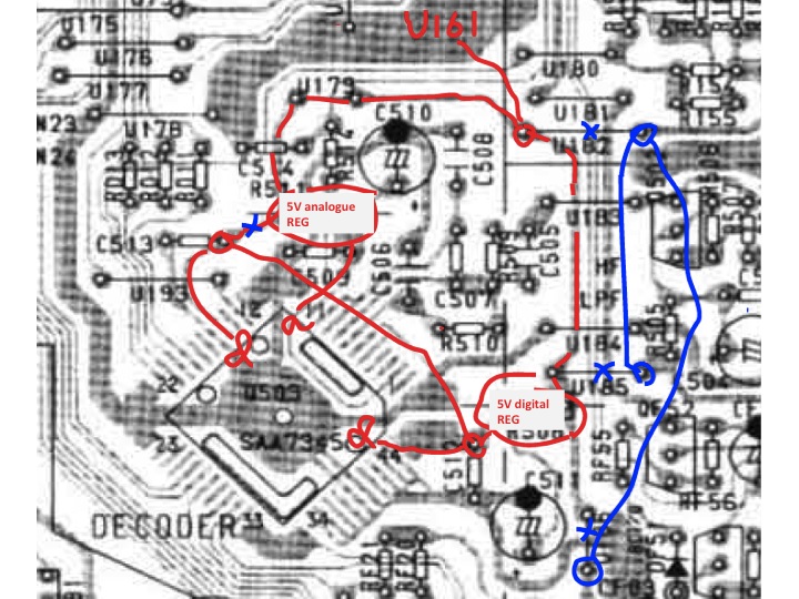

Hi Pete and pjoliver,
I tried putting regs onto the servo but I think I blew the chip. I cut u182, u185, u186 to remove the 5V feed to the servo (see attached). I had to jumper from u182 to 185 and u186 to supply 5v to the other parts of the board. I then jumpered in +15V into the other leg of u182 from u161 to supply the 5V regs that I put in r508 and r511. I also cut the trace between r511 and c513 and jumpered 5v from c512 to c513 so that both digital pins (15 and 44) have the same 5v supply. (I grounded the regs to the nearest ground point).
I think this would have worked except I ended up connecting the regs to u162 instead of u161 by accident :no:. This provided the regs with -15V and blew the tants on the regs. I have fixed the regs and they are working well now, but the transport is erratic and refuses to work properly. I think the -15V blew the servo chip before I managed to switch it off. Now I don't know whether to get another CD63 from ebay and use the board, or try to replace a 44 pin SMD chip. Hmmmmm...
Henry
Henry
I wouldn't even consider trying to replace a 44 pin smd chip unless you're very, very experienced at soldering and have some good equipment desoldering supplies etc. (or you're not worried about destroying the board - given it's useless at the moment anyway :) )
I once did the dac chip in a 67 and ended up with broken traces to 4 or 5 pins, I managed to recover the player with some point to point wiring but I doubt I'd bother again if I could get hold of a new board easily.
Regards
Pete
