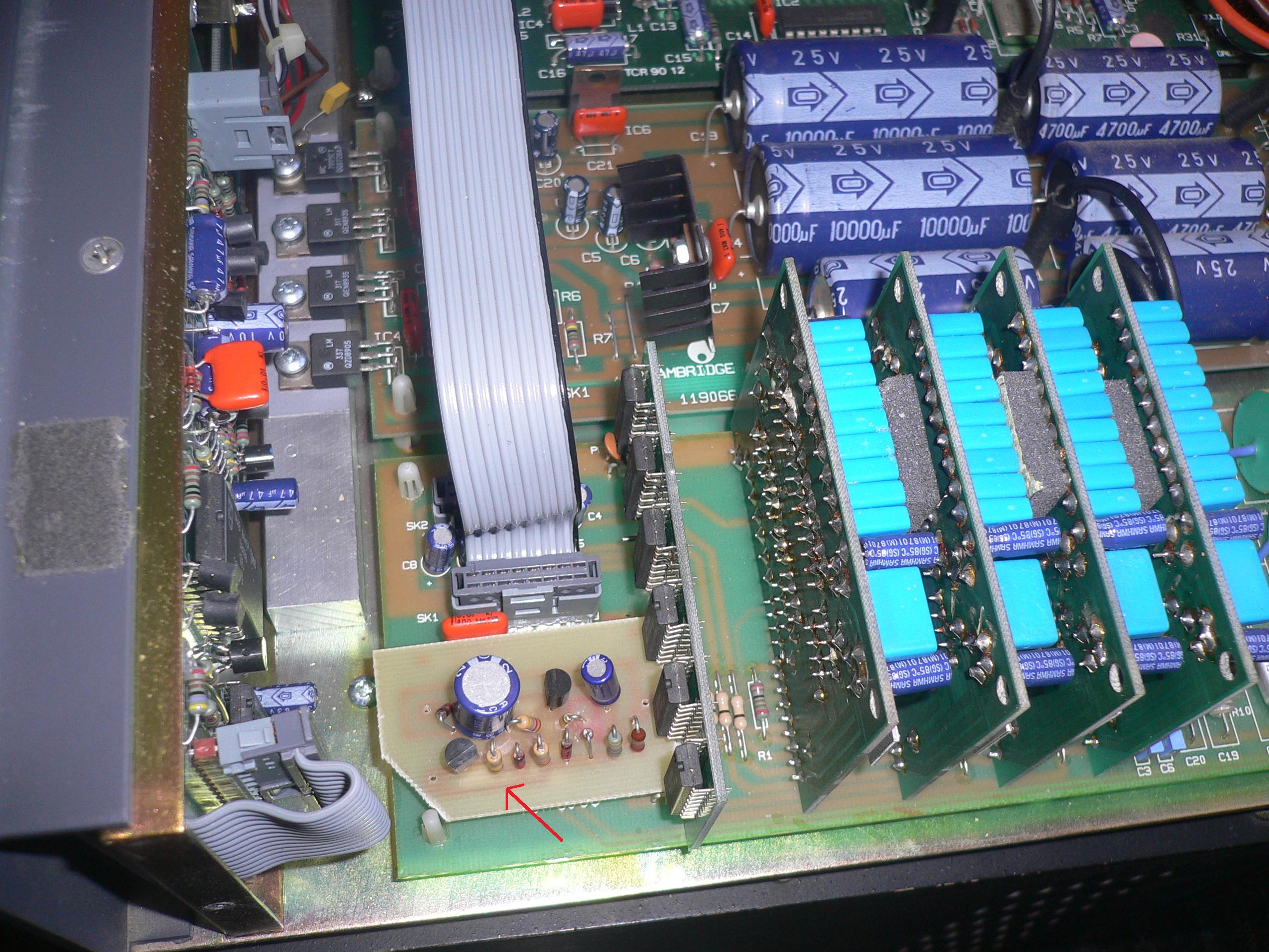

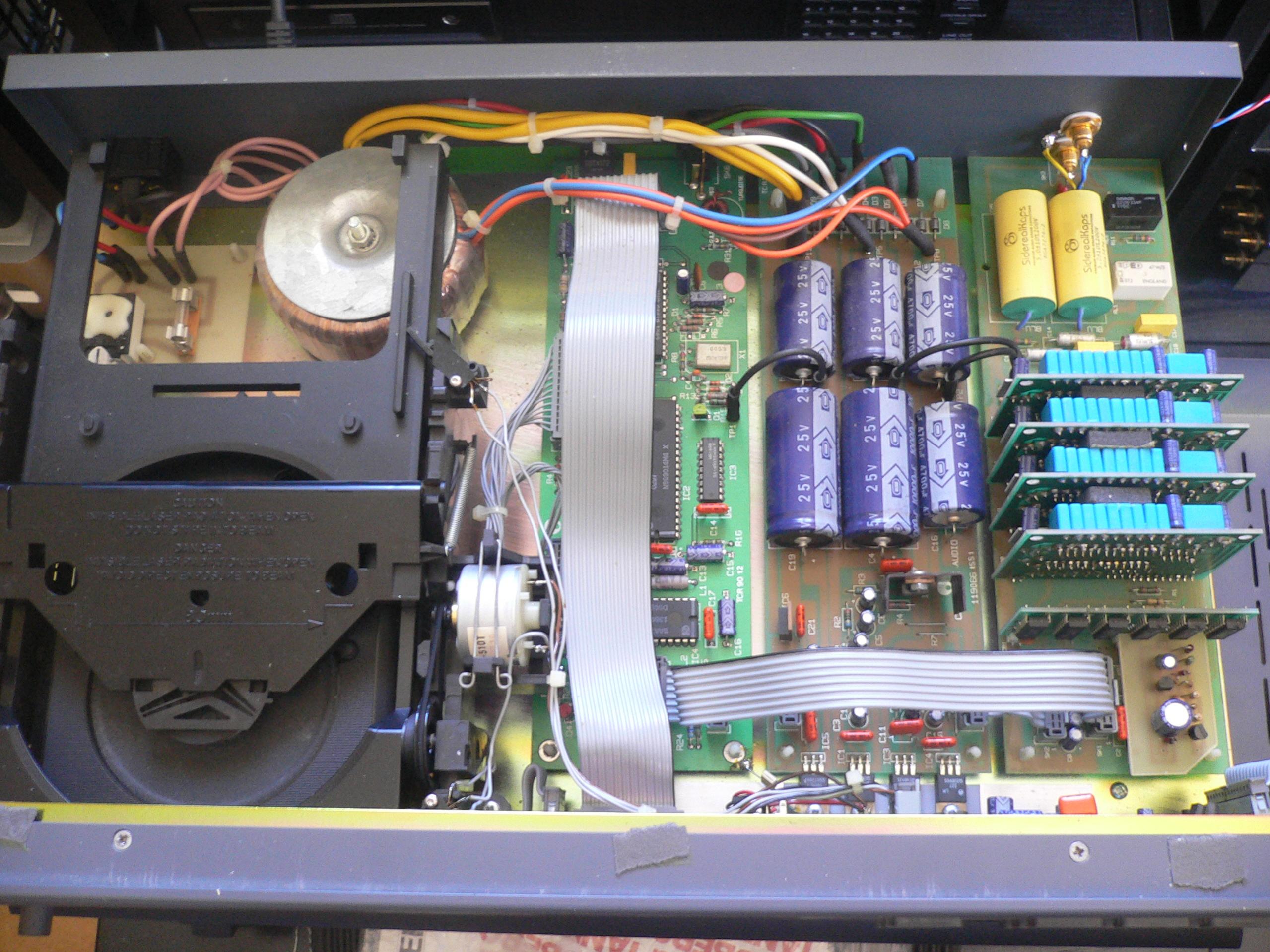

Hi guys,i know that this question is off topic but i did search the web for answers and apart from lampizator site...nothing else.I have a Cambridge CD-3 player and i want to change the op-amps.Now it has 1 5534 or 5334 per chanell,i can't see well there,and because it has 4 x tda 1541,so there are 8 op-amps.The sound of this player is amazing as it is...but after i did change the op amps on the cd63 to lm4562 and did listen to the huge difference they did instead of the 2114....i say why not change them on the CD-3 too.It's not as easy as the 63 to change them....and i wonder if it will be worth it.Also considering of changing diodes 1N4004 to MBR1100.Any suggestions?
And by the way,i search for a service manual for Camridge and the results are 0000!!!!!
Thanasis.
And by the way what is this little board pointed with the red arrow?I have search pictures on the web..and i don't see this add on later???board, on the CD-3.
Thanasis.
Thanasis.
No problem, you can change all of them and see / listen what happens. If it's NE5534 that's in there, it's a single opamp so you can swap it with AD8610, LME49710, OPA132...
Best thing to do is solder them all out and replce them with IC sockets. USe good ones, with turned pin contacts and gold plated if possible. The cheapo ones with leaf contacts won't last long. Here's a PDF with some popular types. In general, the more yellow specs the better they are 🙂
Changing diodes won't hurt, 1N4004 is 1A, just like MBR1100 so it should be fine.
Looks like some kind of extra regulator circuit for the power supply. Are there any 78Lxx or 79Lxx regulators on it? Or maybe a few transistors with zeners.
Ray,thank you for the answers.There isn't any regulators on this board.Just transistors and zeners.Under is connected with the vertical board which is next to it.The regulators are all on the power supply board,2xlm317,2xlm337,1x7805,1x7806.
Thanasis.

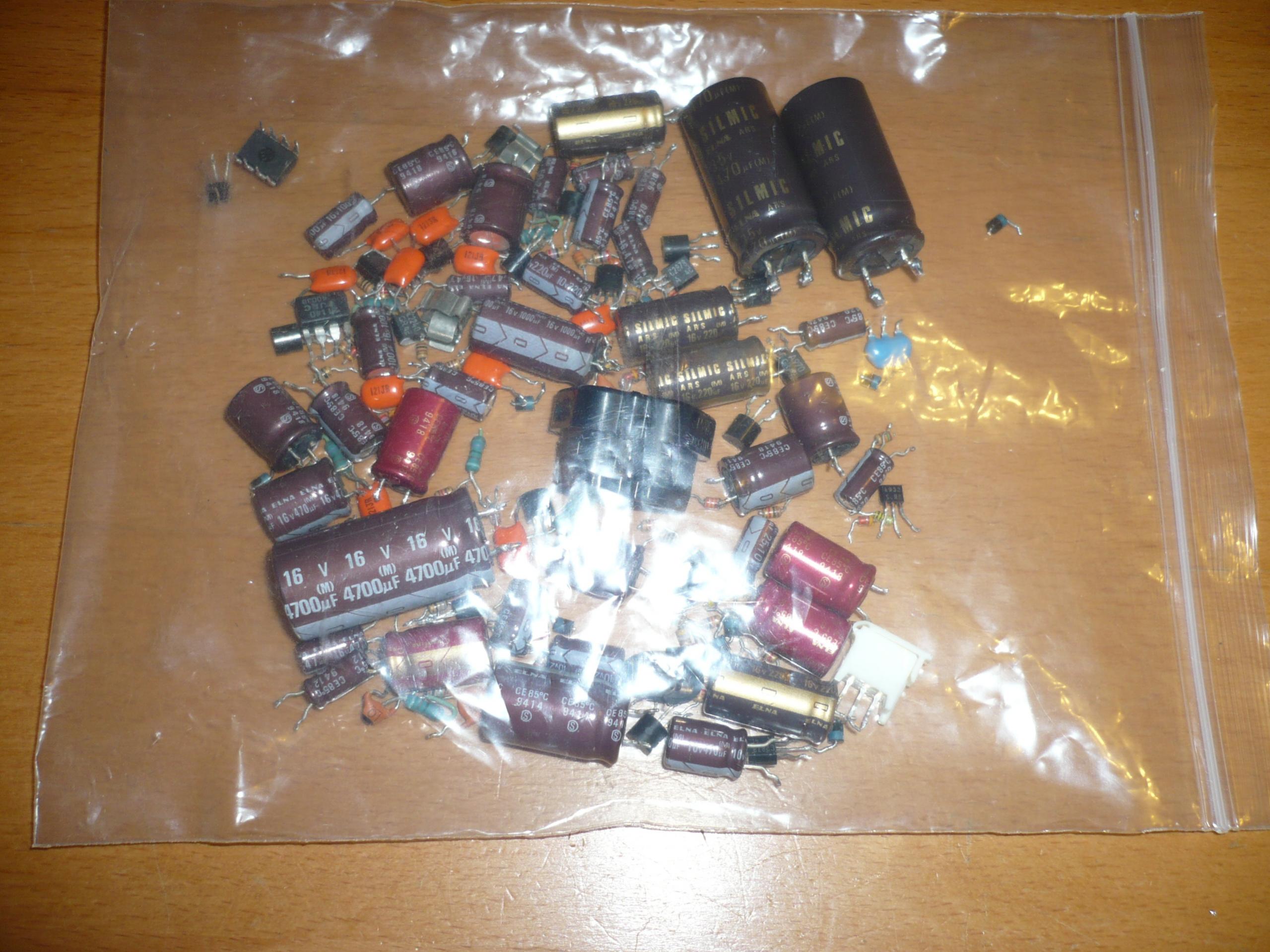

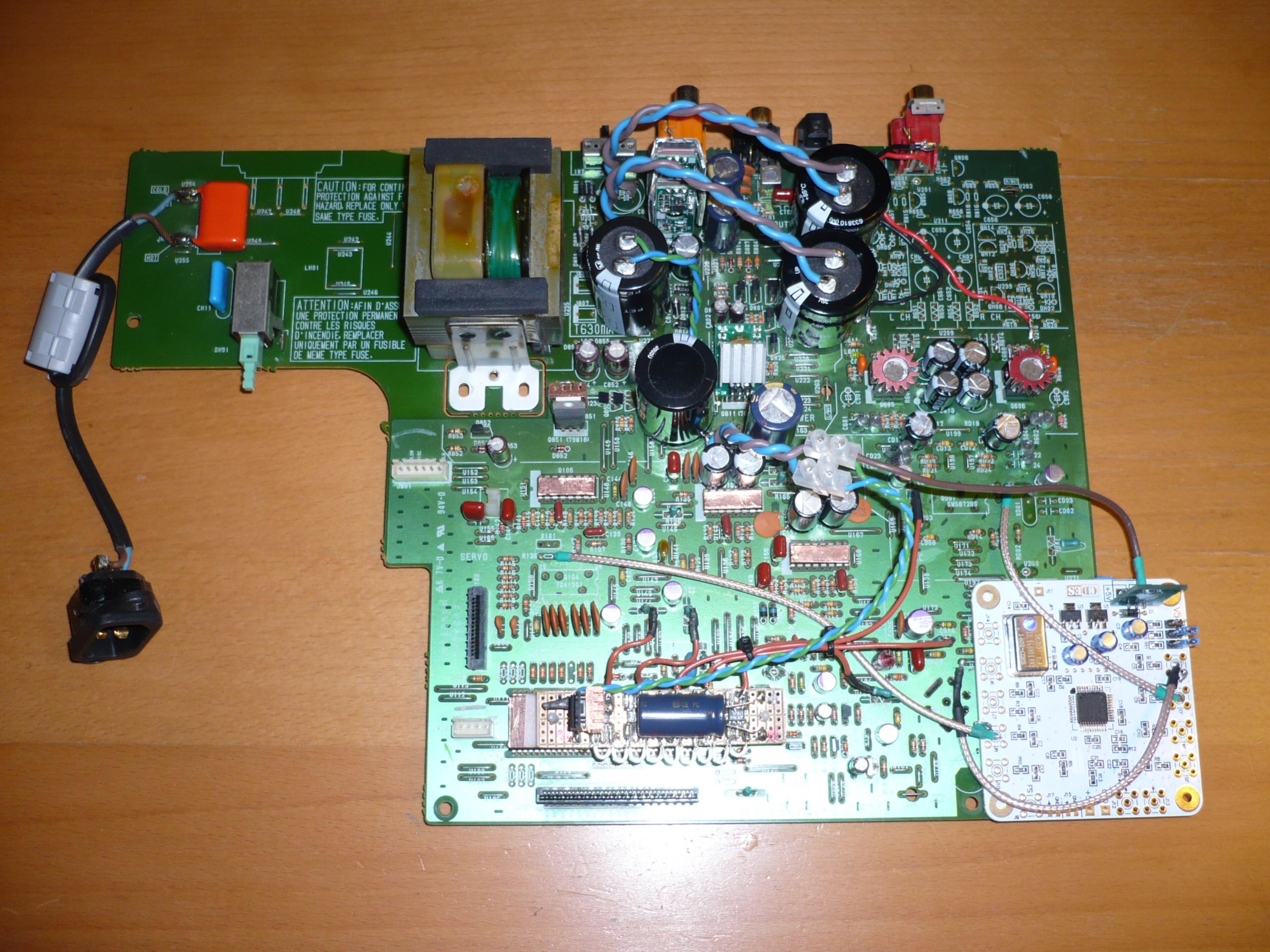

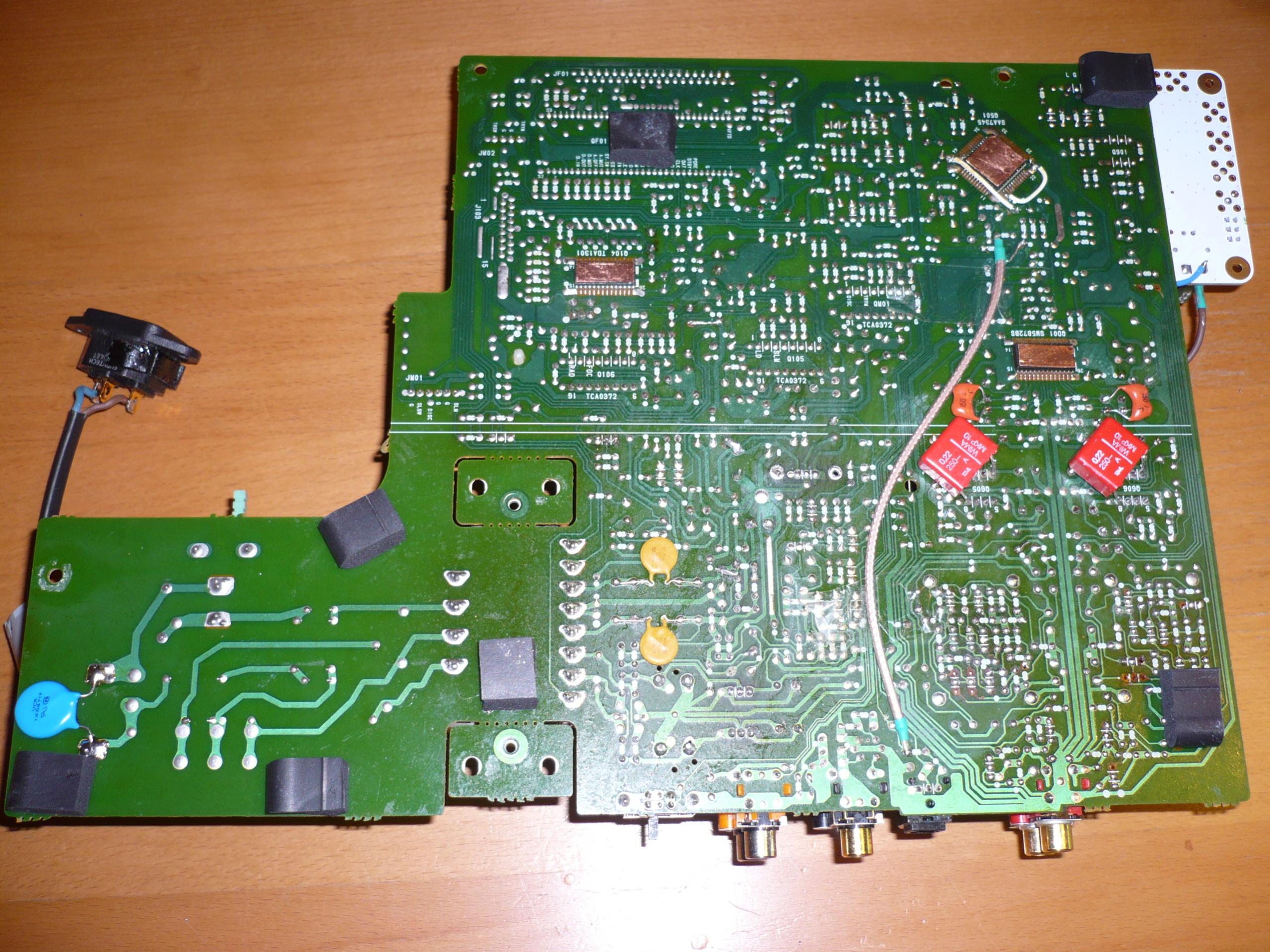

My 9th modding project
I am now working on my 9th CD63 modding project for my friend even though I have told everybody that I won't do that again !! Well friendship is friendship that I don't want to disappoint them. 😛
I have completed about 85% of the mod and the CD63 at the moment performs very well as expected. 😀😀 What I need to complete is the relay operated muting circuit and change the stock transformer to 3 toroidal transformers. I am waiting for the components to arrive that will take some time especially the relay which is to be sent from Hong Kong. 😡😡
I have uploaded a few pictures here for reference and you can also see the components I have changed which is shown inside the plastic bag.
