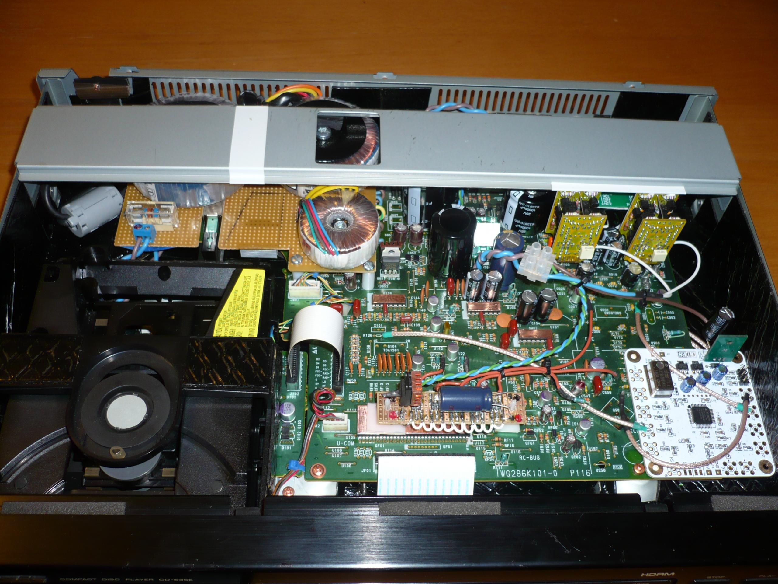

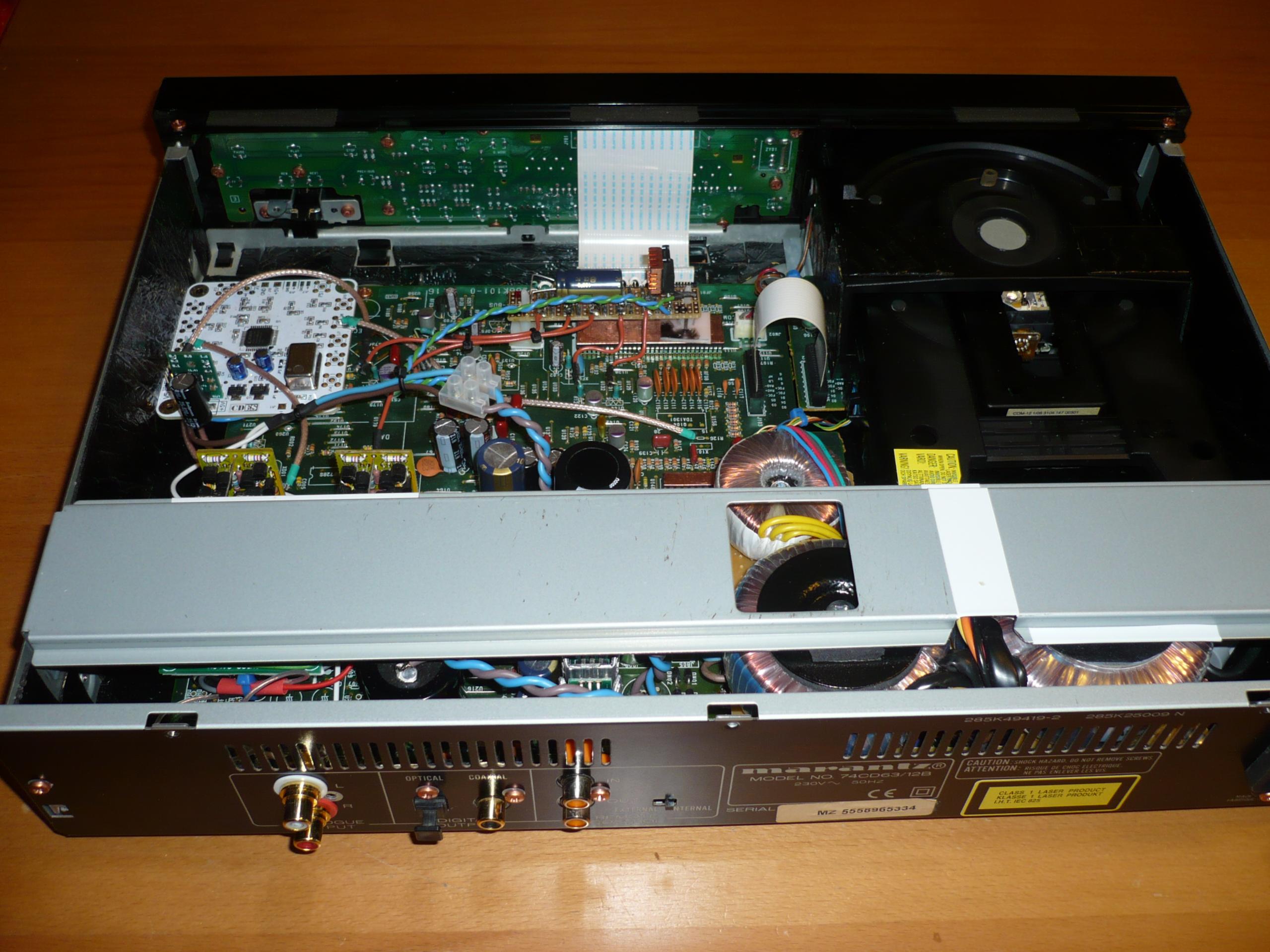

In my post #20358 I mentioned that I will replace the stock TX of the CD63 with 3 coroidal TXs:
http://www.diyaudio.com/forums/digi...ntz-cd63-cd67-mods-list-2036.html#post3953824
The 3 TXs have eventually come and I have now completed the modding project for my friend. It works wonderfully well as expected. No issues at all. My friend is really happy with it. The total cost inclusive of parts and the CD63SE is about £300 (of course excluding my labor cost 😉 ) I think in total I have spent about 2-3 days to complete the job.

Nice job, Higlander!

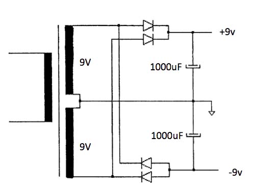

Hi Ray, I want to use your Flea kit and TentXO. You recomment a dedicated transformer and I have a small 2X9v 3Va toroidal handy. Would the attached scheme be enough to power? Thanks! Henry
Hi Henry,
The power of the tranny is enough, but you don't need a symmetrical supply like the +/-9V of your schematic. Just connect the two 9V windings in series to make 18V, like you have now, and use one bridge rectifier and one capacitor. Forget the center tap to ground. Then use a 7818 to get a nicely regulated voltage for The Flea.
See here.
