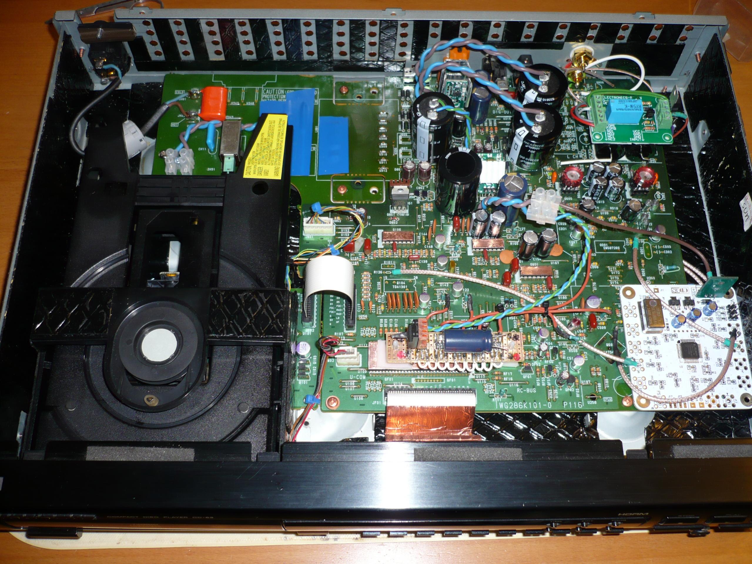

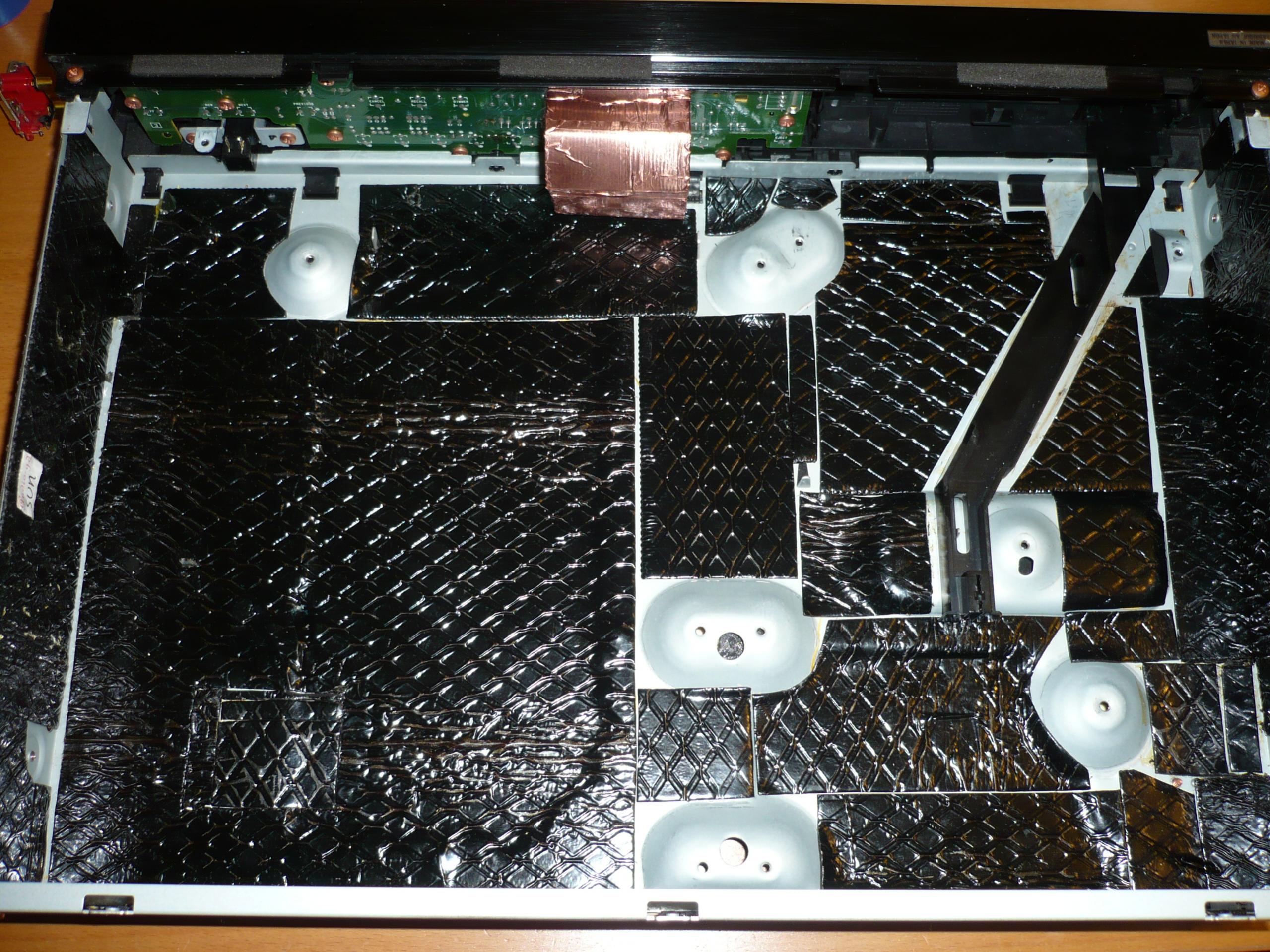

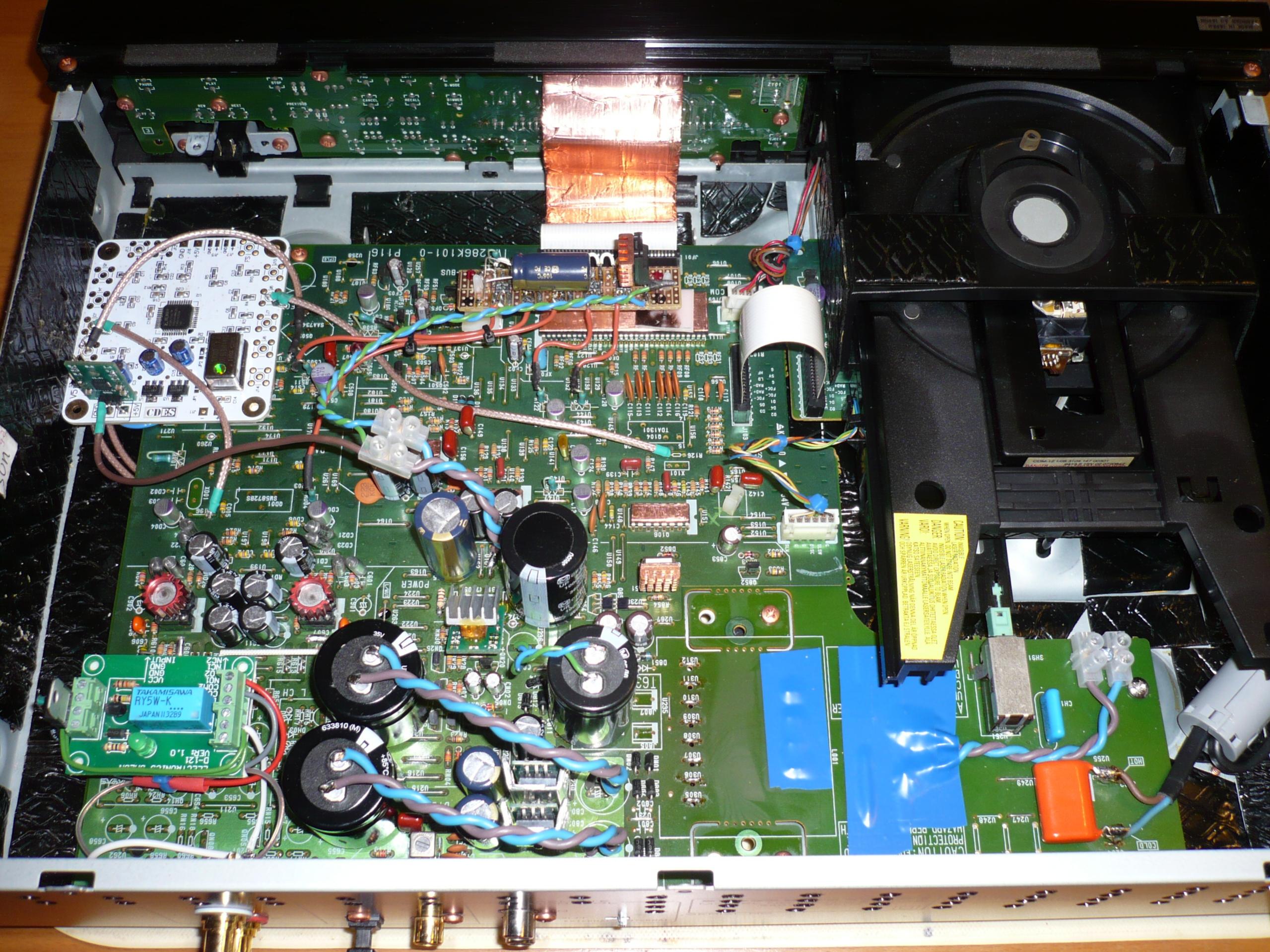

I have completed about 95% of the CD63 modding project for my friend and the only item left is to replace the stock TX with three toroidal TXs. I have uploaded a few photos here for reference.
I have tested the modded CD63 with the stock TX and everything works like a charm. With the 3 toroidal TXs put in there will be a boost in overall performance.😉😉😉
I am waiting for the TXs to arrive due to out of stock and hope I can complete the mod for my friend very soon.
