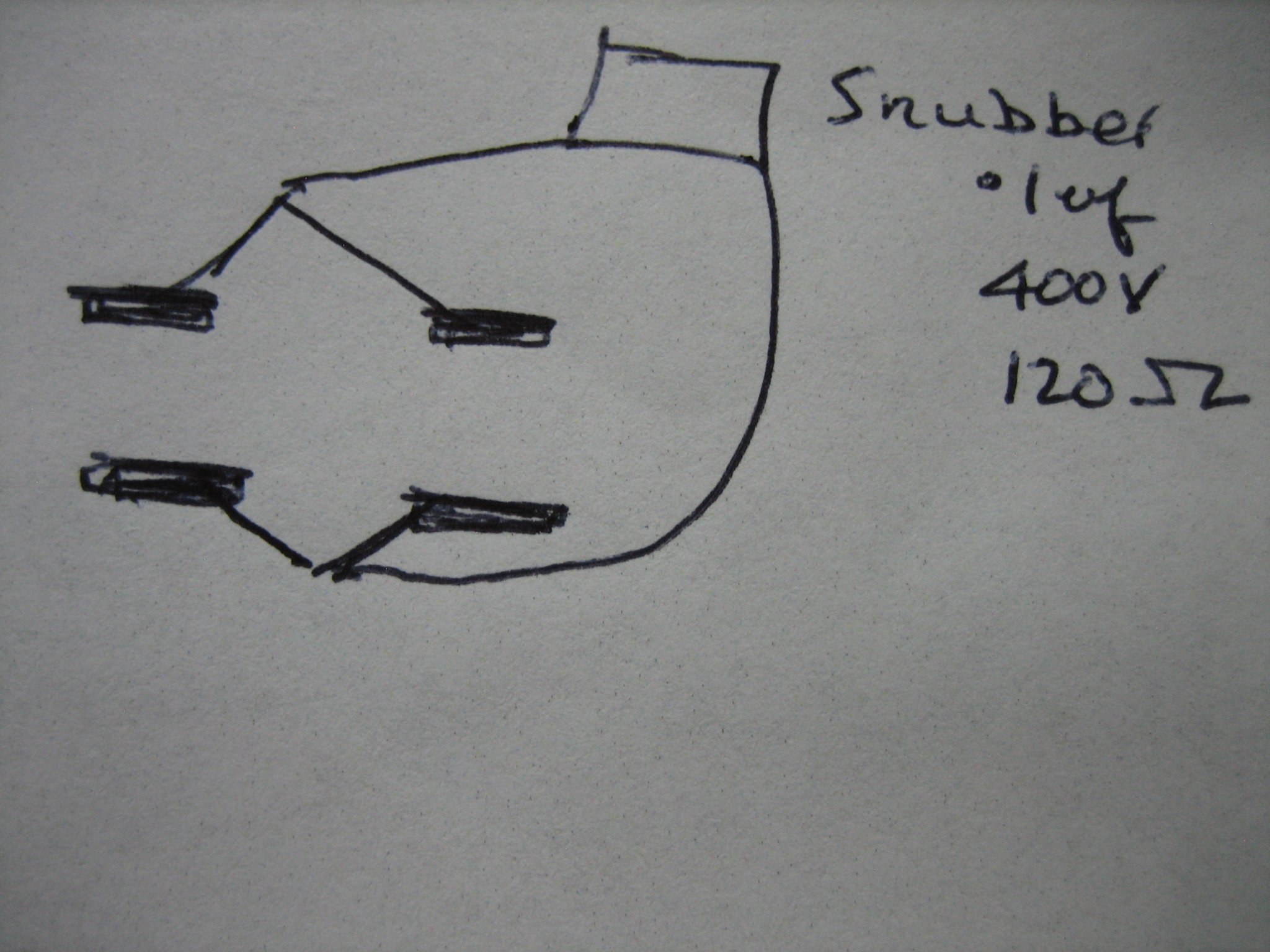

I looked at the power switch and it has four tabs and two on either side are connected together ( ugh?) with the snubber connected across them. Can that be correct? I'll post a pic when I get a chance. In the meantime here is an illustrationAlso check the wiring, it may have been altered during earlier repairs.
I'm not sure what to make of your sketch, but it's disturbing and I believe you're right above the target.
I've attached page 13 from the service manual and it shows the snubber and the details of the power switch. One half of the switch controls AC power to the transformer and the other half interrupts DC power to the speaker relay. The relay should drop instantly with the power switch.

There are four tabs on the back of the switch and are externally soldered as shown. The snubber is then connected across. Thanks for the attachment.'m not sure what to make of your sketch

UPDATE: My aging eyes deceived me. Disregard my hand drawn illustration. I removed the underside cover which revealed differently from what I said it was.

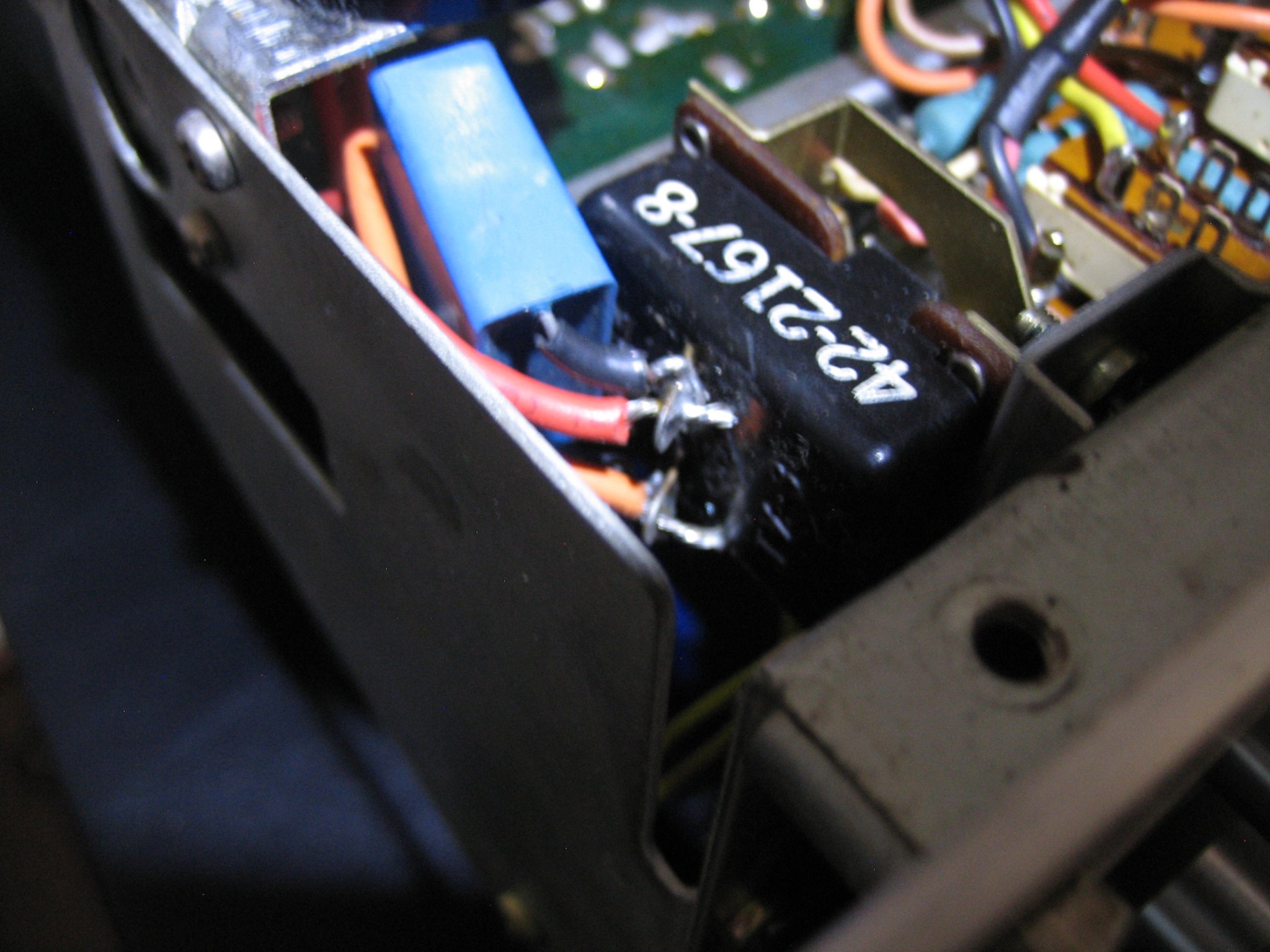

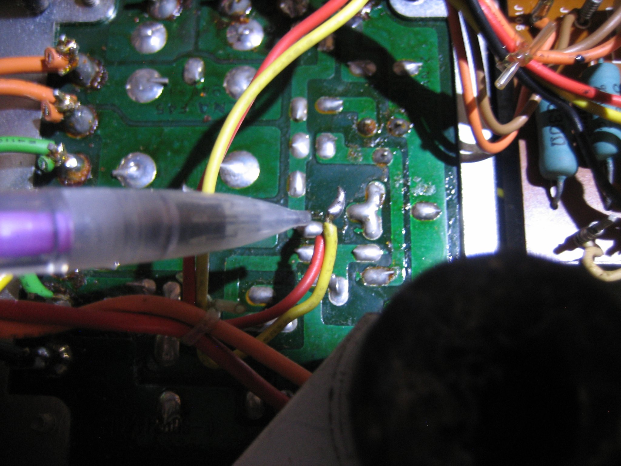

Here are two pics showing the switch with the blue colored snubber. There are only two tabs . The other pic is...well..not what I expect to see, a yellow and a red wire soldered together and just "hanging". I use a pencil to point it out and it would seem from the photo that it is connected to the circuit board but it is not. Seems like this unit was worked on before.

Hard to tell from the previous pic. Yellow and red wires are soldered to points on the PCB and then joined together out of view above? Are you able to sort out what was done? Symptoms suggest that the DC pole of the power switch has been bypassed. Maybe a continuity check with switch off will reveal what's going on.

I believe this switch was changed out. As per schematic what type of switch should this be? Is it possible that the red and yellow wires that are soldered together should have been connected to tabs on the switch? This switch only has two tabs and everywhere that I have looked for the 1070, suggests there should at least be four. In fact , there are switches for the 1070 on Ebay that comes with six tabs and the seller instructs buyers to use the four rearward ones for four wired switches.
You would need a two pole switch, mechanically compatible, and rated for line voltage and current draw from the power transformer. Not a trivial search, but not impossible. I’d start from the Marantz part list—- might offer something useful.
There could be an electrical work-around if you can’t find a suitable switch.

I ordered a new switch as I am convinced the one in the unit at present is incorrect. The yellow and red wires that are soldered together should be switchable as per the schematic. These wires go to the P700 board with yellow specifically to the relay via J709

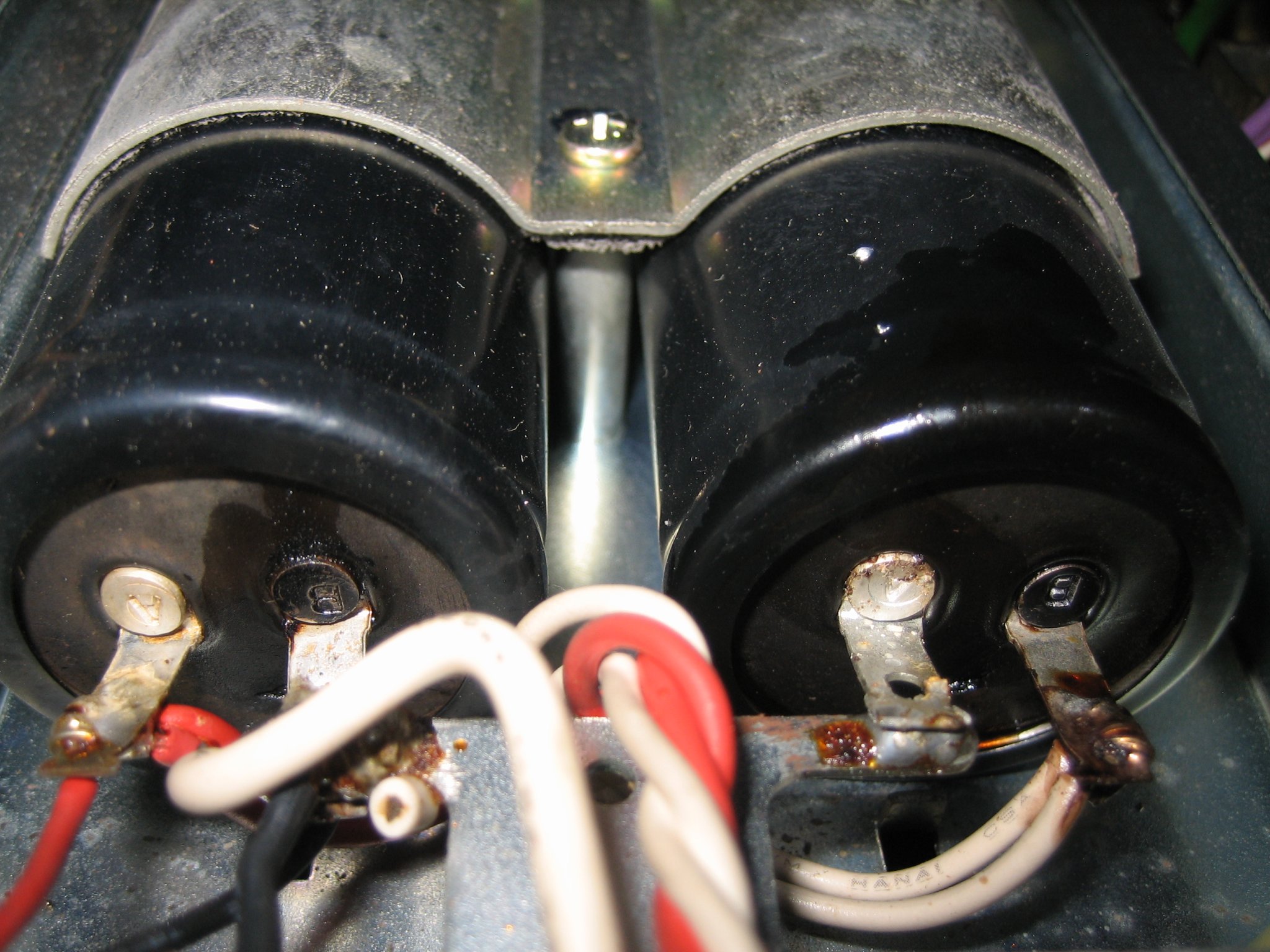

Are you sure you are not looking at flux residue?Both Power Supply Caps ( 50V, 10000uf) are also leaky!
If the caps are leaking then you should be able to spot the leaking spot - it does not seem to be visible on the photo.
