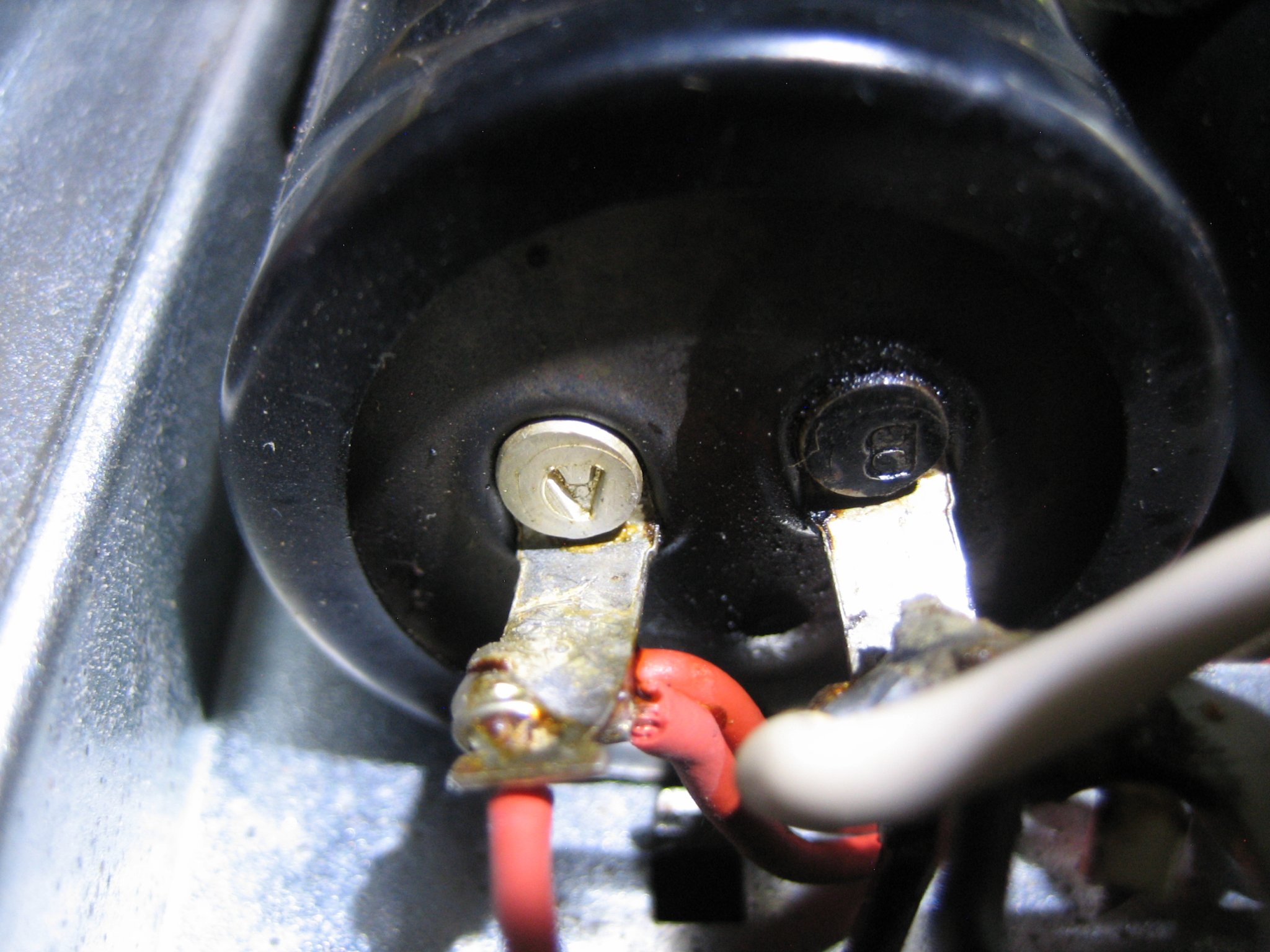

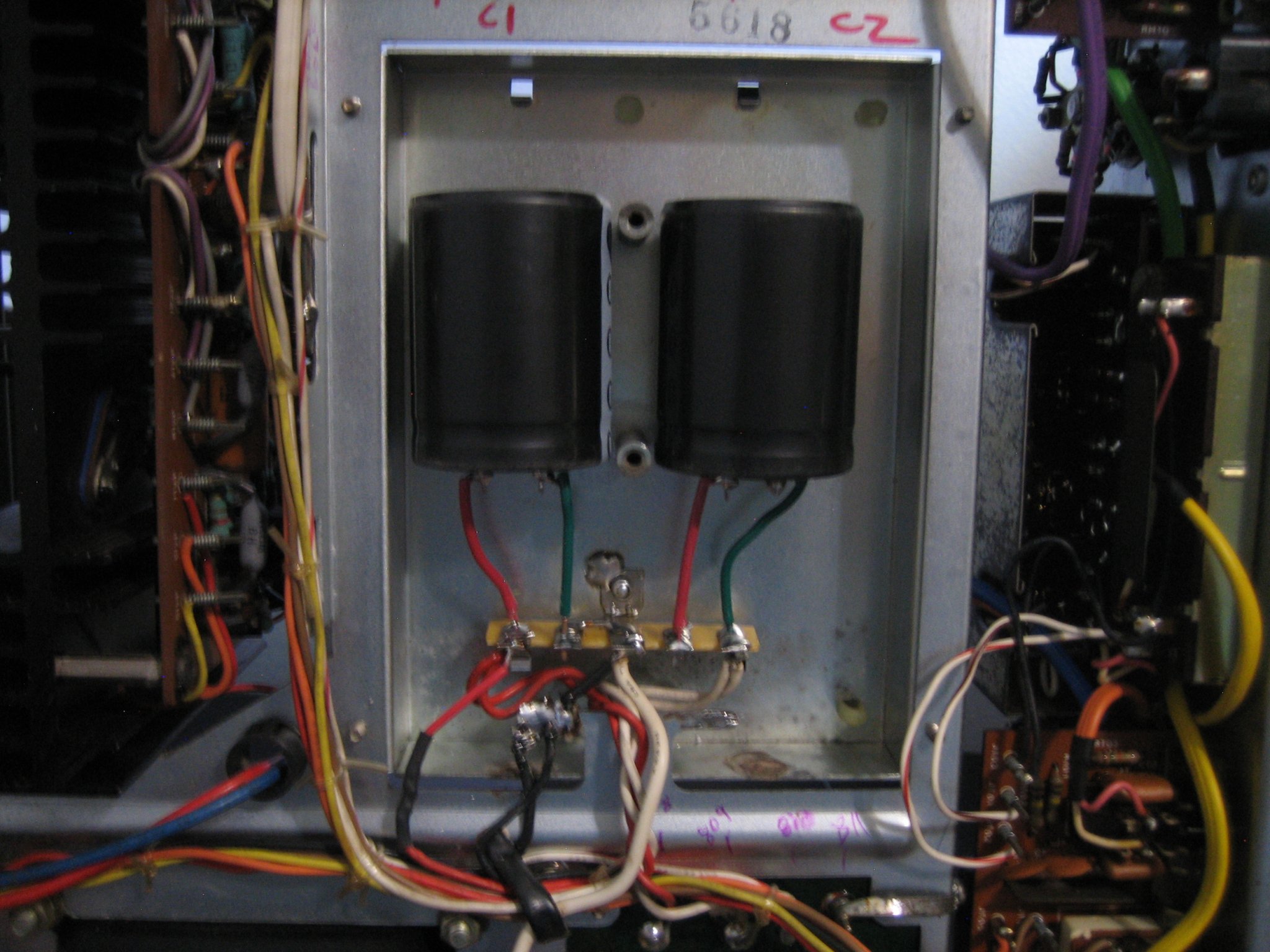

My intention is to modify and install a terminal strip ( riveted or screwed to the chassis ) to accommodate the wires so only one connection to each terminal on the caps. I did not know of those cap rings so thank you for the link and the photos.
If you go with snap-in caps, I would consider making a little circuit board for the caps. Then put screw terminals on the board or solder the wires directly to the board.My intention is to modify and install a terminal strip ( riveted or screwed to the chassis ) to accommodate the wires so only one connection to each terminal on the caps. I did not know of those cap rings so thank you for the link and the photos.
Keystone #8191 could maybe work.

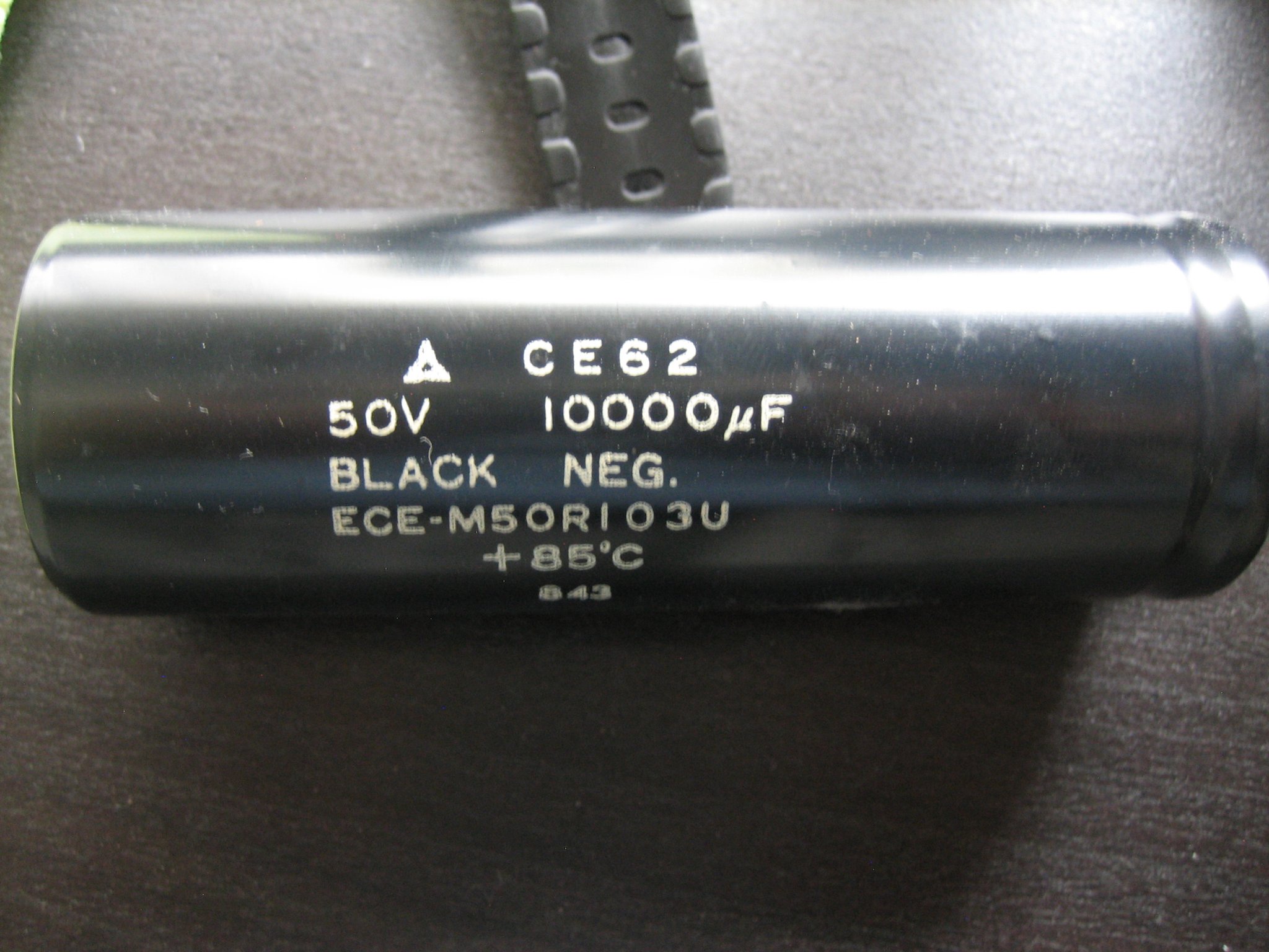

It wasn't until I removed the caps that I saw the labelling on the cap for the polarity.it should say on the can which terminal is which.

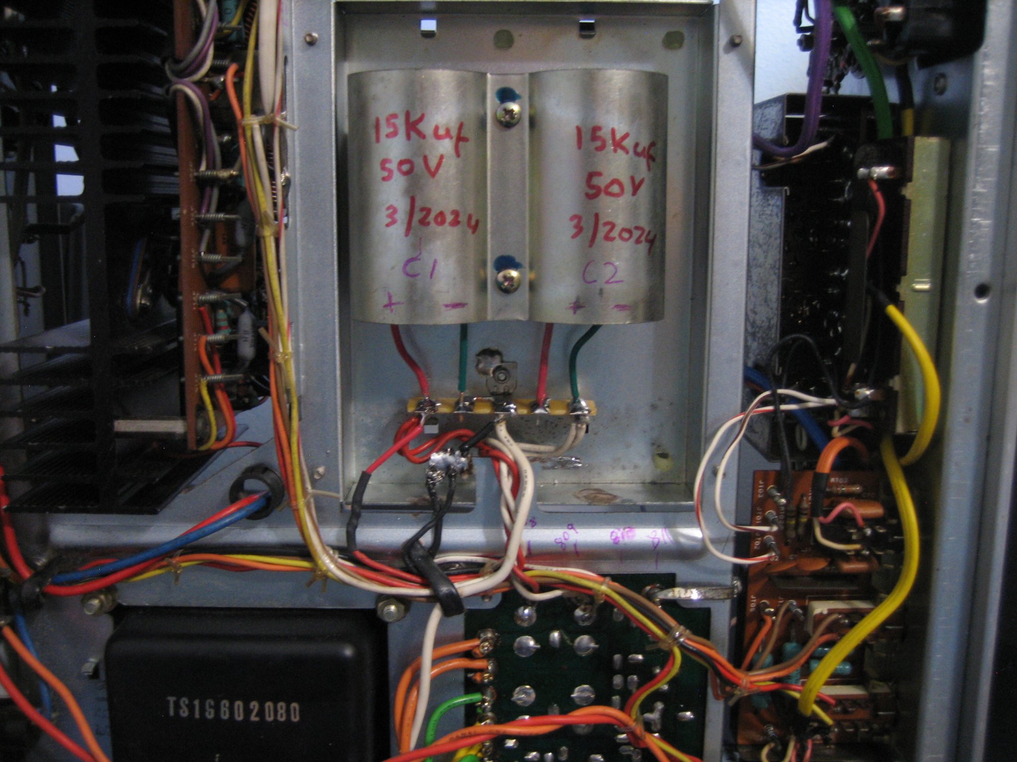

All done now and the amplifer is still working fine. Seems like the bass is tighter. Not the best job but functionally it is fine . Lots of redundancies for the chassis ( gnd) connections as you can see. Also with the terminal strip , should any of those caps need changing it will be a simple matter of desoldeing just two wires at the pins. The inner three terminals are all tied together for the ground. Thanks again eaveryone.
